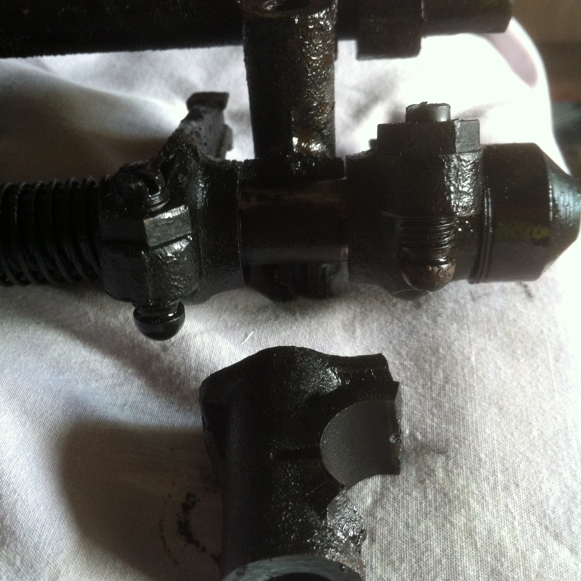

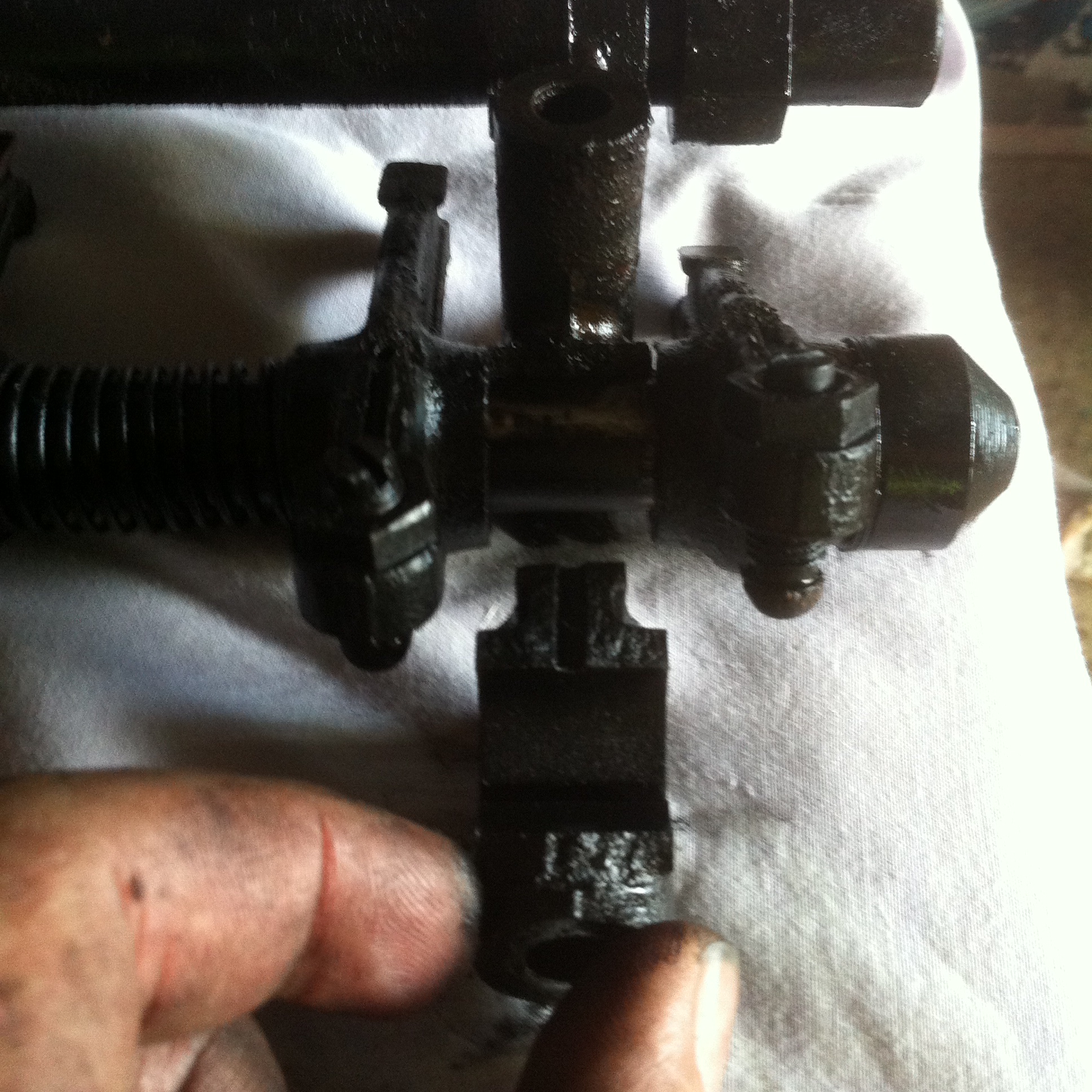

I finally got the time to actually start removing the head from my 1956 Tef.
When I removed the tappet/rocker assembly, My first parts fatality occurred.
One of the towers holding the rocker shaft in place has broken into 3 parts.
Firstly what would you call this part and do you know if it is available to purchase, or do I learn to weld cast iron?

   / Tef head off woth first parts fatality #2
Hmm, strange failure, a used one should be quite easy to get.
   / Tef head off woth first parts fatality #3
AGCO Parts Books ->
guest view ->
select massey ferguson from drop down menu ->
type in TE 20 ->
click search ->
all the way down at the bottom i do believe is link you want.
from there just google the part numbers.
you also might try googling, tractor salvage yards, or a local agco dealer (and there many brands), and see if they can pull something up.

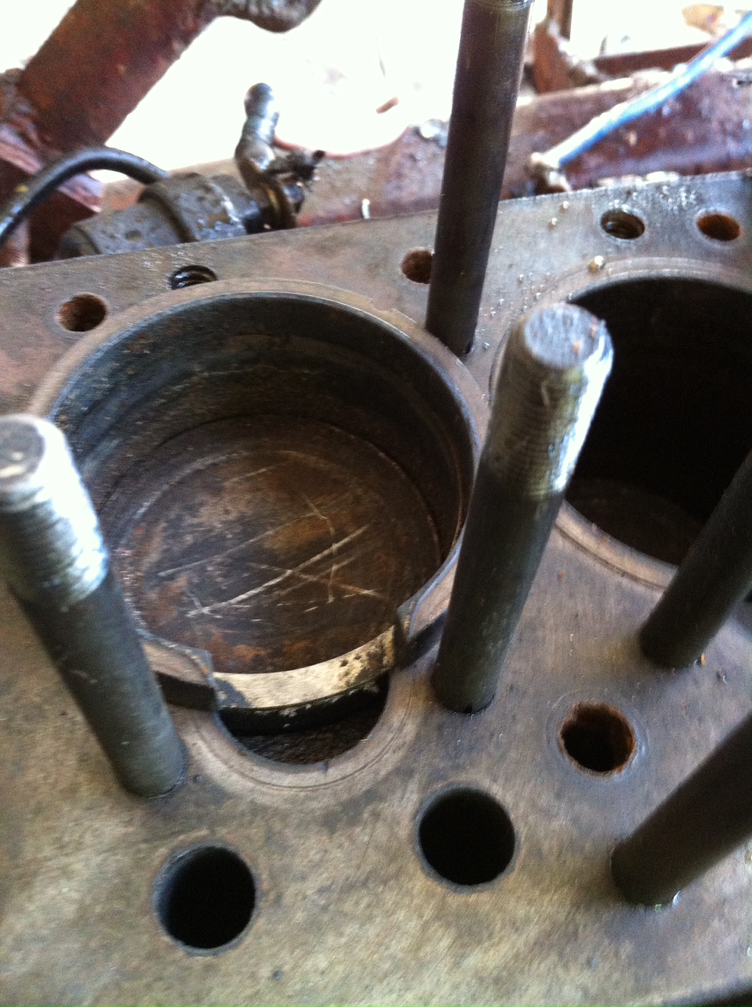

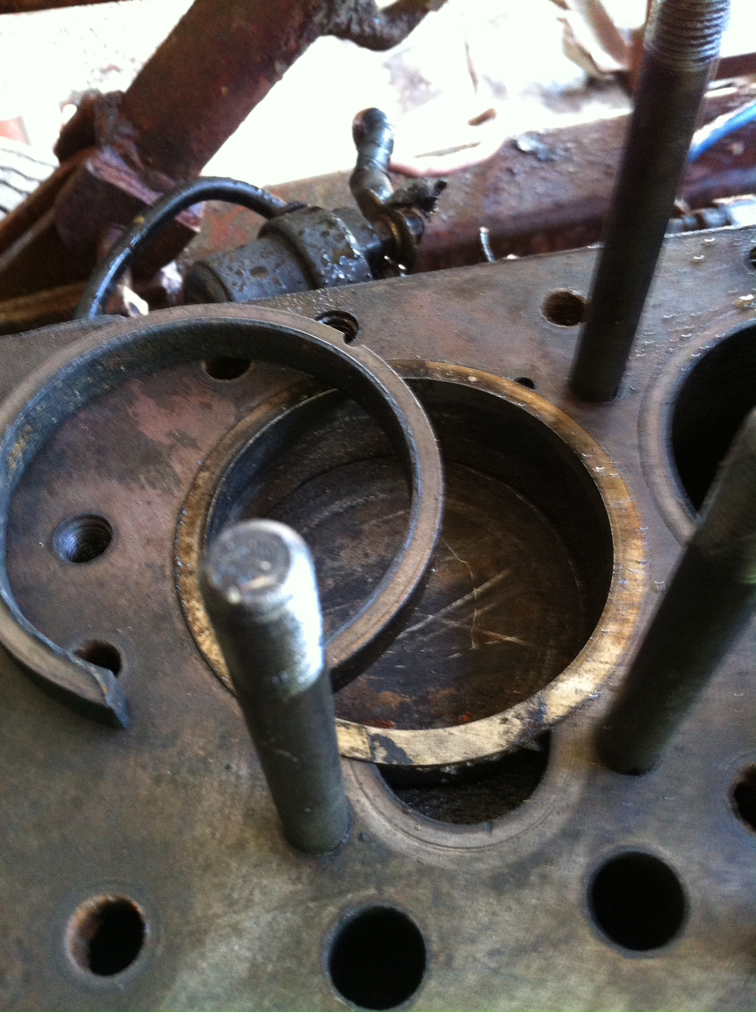

The other question I have is about the rings that are above the liner.
I can see that the top incomplete ring creates the precombustion chamber. But I have a second complete ring below the top one.
Is this average or do I have a non standard cylinder liner set?

   / Tef head off woth first parts fatality #8
I do belive there are two rings, if I understand my original service manual
#9
Two rings would be good, an engine from 1956 can be hard enough to find parts for without it being an unusual version
   / Tef head off woth first parts fatality #10
Agreed. The only TEF I ever saw has a Standard Diesel in it. Happily, I didn't need engine parts.
