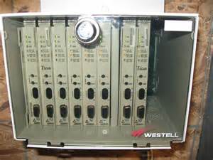

The Hospital phones have been on the fritz... intermittent... no area code calls completed and 3 open service tickets with ATT
Everything was installed new in 1995 with what was then called a Hi Cap service that ATT now refers to as a legacy T1 Centrix...
Spent most of the day with ATT calling from a rotary phone I plugged into a fax line... at least the faxs machines never missed a beat.
I told the ATT folks every time there is a problem... the T1 card has RED or AMBER LED lamps illuminated instead of just the 3 GREEN LED lamps.
In desperation I swapped a T1 line card from a circuit no longer used and phones have been perfect since...
Problem started the day before Christmas...
Anyone remember a time when a trouble ticket from a Hospital would have a tech onsite immediately?
ATT said Monday is the next available...
With the system working should I just keep quiet about switching the card?

Negative. Swap the suspect card back in and enable it and observe operation. I assume the card was in the pbx.. If you know the part number of the card, you might tell me. Another problem could be the "package" on the wall the T1 is delivered by. This is the telco's and you may have reset it by swapping the card in the PBX. Don't try to fool the tech, explain all of your actions and observations. This will help tremendously in troubleshooting. Remember the goal is to get good solid service back to the hospital. NOT to play games and obfuscate. Come clean. You don't want this to be some ongoing intermittent issue. The tech job is hard enough with someone not telling him all the known facts. He is there to help you. Help him.
Yes, the "high cap circuit" down for a hospital should have been an immediate dispatch... Would have been in my organisation.

ATT has so far not dispatched anyone... since the day before Christmas... I have at least 9 hours on the phone and email with our business account rep in the loop...
What ATT has done is repeatedly tested the circuit and then sent a recorded message to the Hospital Main Number saying "Clear on Test".
Years ago I was told to pull the card, wait and put it back... may 2005?
It did not work so a specialist was sent out immediately at 11pm at night... he swapped the card for a new one and all was good... until December 22.
I tried the reset this morning and within 5 minutes all the problems were back...
So far exchanging the card 3 hours ago and all phones are good... no idea how it will be in the morning... but at least I could go home knowing the phones were working in case the nurses needed to call out... also advised they keep cell phone handy.
It looks like this... at one time we had a dozen NIU and now only two are active in the building...
ATT told me today they just don't have people available for this older technology...

k0ua...
This link about sums up my experience to the letter...
The Systems Engineer >> Blog Archive >> Telco – Clear to the smart jack!
Man, that brings back a log of bad old memories. Memories of me representing an equipment vendor, fighting the local telco (Southwestern Bell) to prove to them that the equipment they provided was defective. I am beginning to believe there are not a whole lot of us old dogs left that actually know how to troubleshoot using the scientific method.
Yes, I have heard "trouble is good leaving here" a lot of times. I could tell stories, but this is not the place or time...
