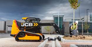

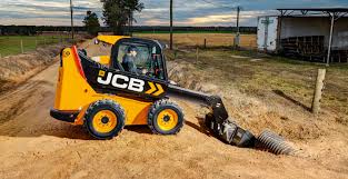

If you have a spare $65k sitting around, these just were released buy JCB.
I think they might have a winner here!
