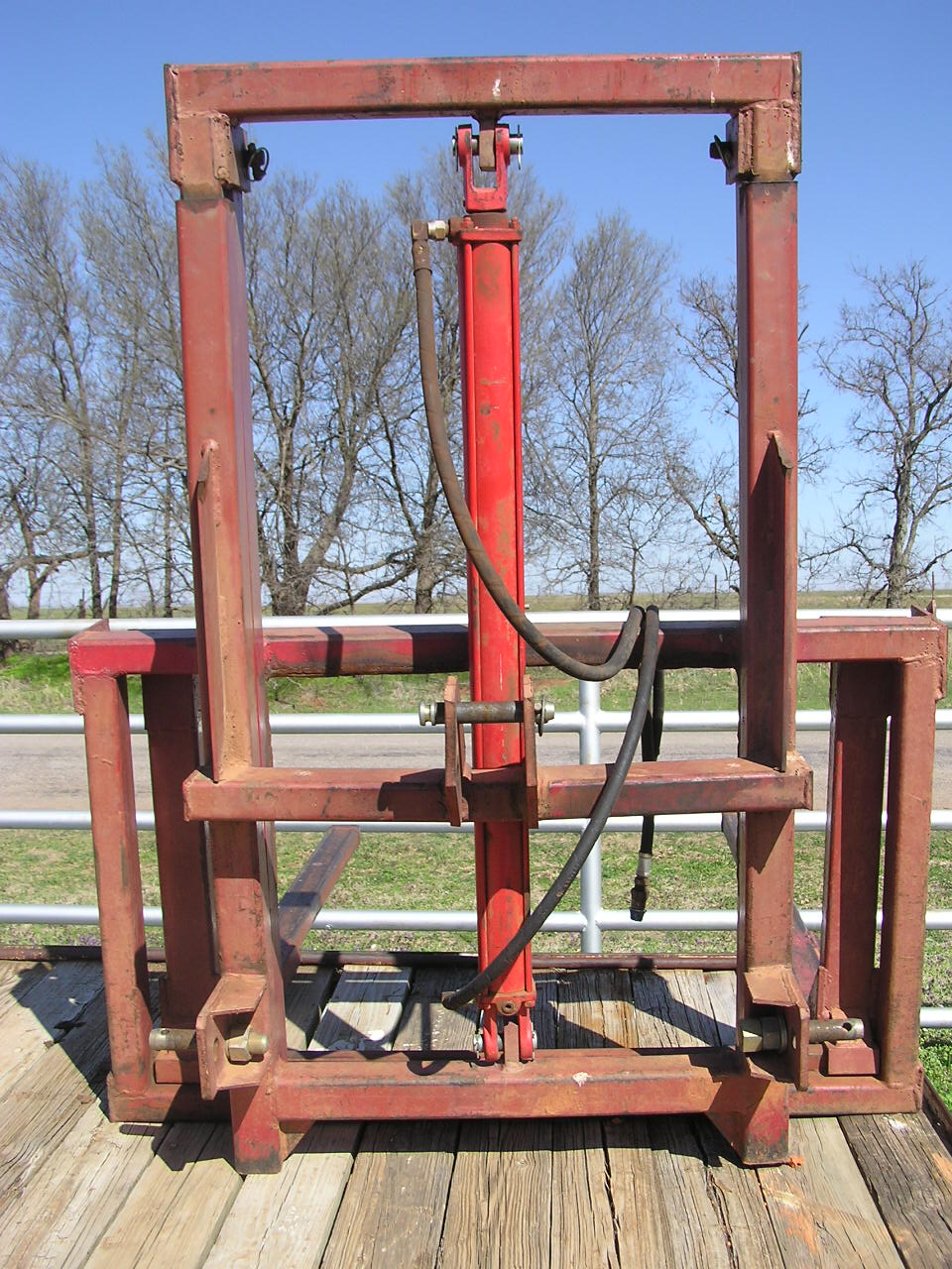

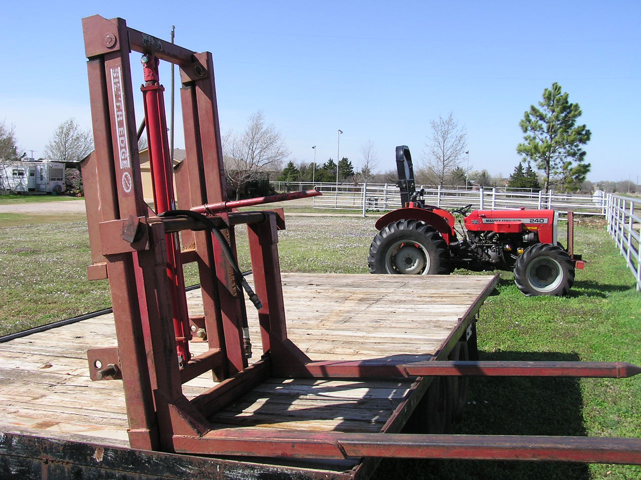

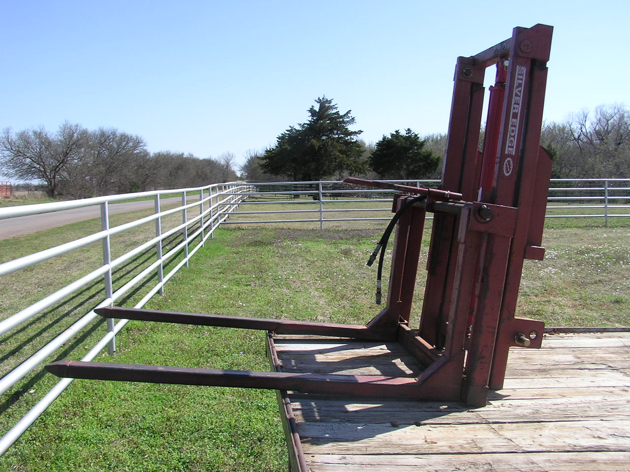

as I was performing my normal auction site stalking I came across a "Phil Brown economy lift" set up as a 3 pt attachment fork lift. Has a 6' lift capacity for moving boxes of fruit in orchards on to the trucks. I bid up to the max I was willing to spend on it believing that I could modify it by attaching a SSQA plate to the back. Way more lift than I'd need or feel comfortable in adding. But alas someone wanted it worse than I did. Anyway the photos of the thing gave me some direction as how to proceed in my design.
Then yesterday afternoon a sales gut from Quick Attach calls to see if there was anything I was looking for. Asked him if they had anything to do what I wanted and of course they didn't. I'll need to get it designed and trademarked fast to cash in.

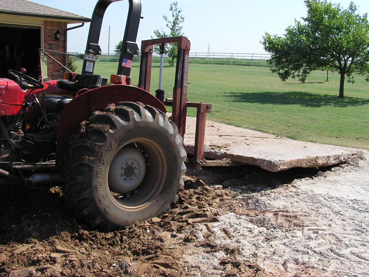

Yep that would work, I had one made by Silver Edge, with less lift height, on the 240D:
You could scale it down and build it on a SSQA plate with a bale spear, instead of forks. :thumbsup:
