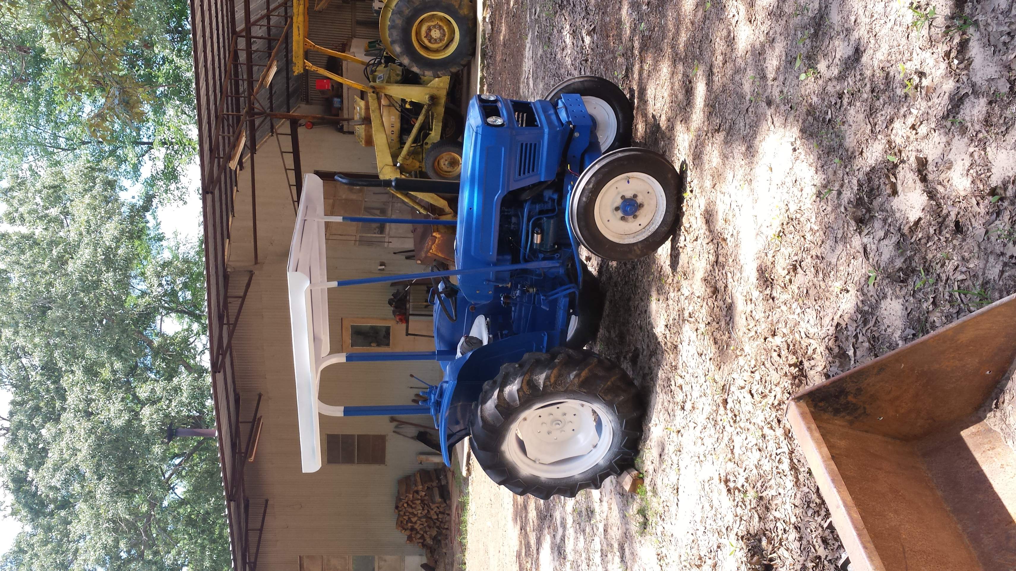

I have a hinomoto E280 for sale. (New front tires, generator and starter) for parts. West Monroe, LA $1500 for entire tractor has bad motor. 318 914 6785. After 5pm
