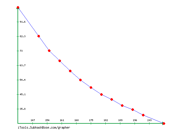

Yesterday, temp gauge went into the red while mowing. Air temp was 70°F +/-. It appeared to be a thermostat that failed closed. Replaced that. Also replaced sensor. Both removed parts tested OK on the bench. I did a resistance/temperature profile on the removed sensor. FWIW, here it is (the 210°F is an estimated value):
Does anyone know what the resistance is supposed to be? More important, what should the voltage at the wire to the sensor relative to ground be? Is it 5V, as suggested by automotive sensors? If so, I am concerned the voltage regulator on the PCB may have failed. Is there any way to test the gauge easily before replacing it. That is, given a certain resistance to ground, what should it read? What is the usual operating temperature of the coolant? My local dealer doesn't know.

John, here are the specs on your temperature sensor:
35 C (96 F) - 670 plus/minus 80 ohms
80 C (176 F) - 118 plus/minus 6 ohms
105 C (221 F) - 54.5 plus/minus 2.7 ohms
115 C (239 F) - 42 plus/minus 2.5 ohms
As you can tell from the data above, the thermistor in the sending unit is not linear. I think you are far more likely to have a defective temperature gage on your instrument panel. The gage is replaceable, but quite expensive. I'm giving you a link to my thread on testing and replacing that gage. Read it all the way through. You'll have to click on the photo links since TBN didn't have thumbnails in 2006. I suspect the gage is twice as expensive now or even more, but it will be far less than a new instrument panel.
