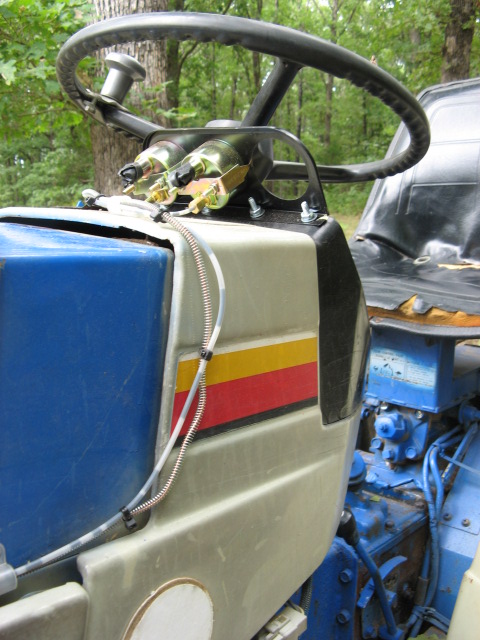

kyles974, I had the same thing happen to my GC2600 massey ferguson, almost the exact spot. Rad from dealer was almost $500. I took it to a local shop and they pinch the broken cores closed and soldered them closed for $125. Its been running fine at the same temperature as before. Just throwing it out there in case your looking for a cheap fix.

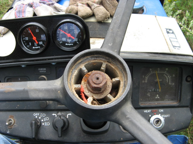

Installed water temp & oil pressure gauges on my old Mitsubishi day before yesterday. Also have a voltage gauge but have not gotten around to setting that up.

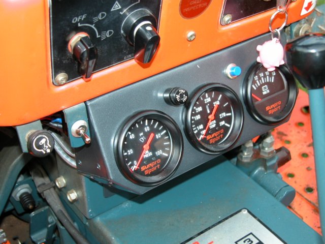

I did the same on my old B8200 many years ago- I found a combined voltmeter/coolant temp/oil pressure gauge assembly online for about $17, and then spent considerable time fabricating a mounting case, but it was worth the trouble. All good information about your tractor's operation, and hopefully, something you look at from time to time!
   / Temperature gauge SAVED my tractor! #8
Nice, clean installation.
I have a fuel filter up under there on the Mitsubishi, so I wouldn't be able mount them down there. Also, figured the higher they were, the more likely it would be that I would watch them, especially since I disabled the warning lights when I installed the gauges.
