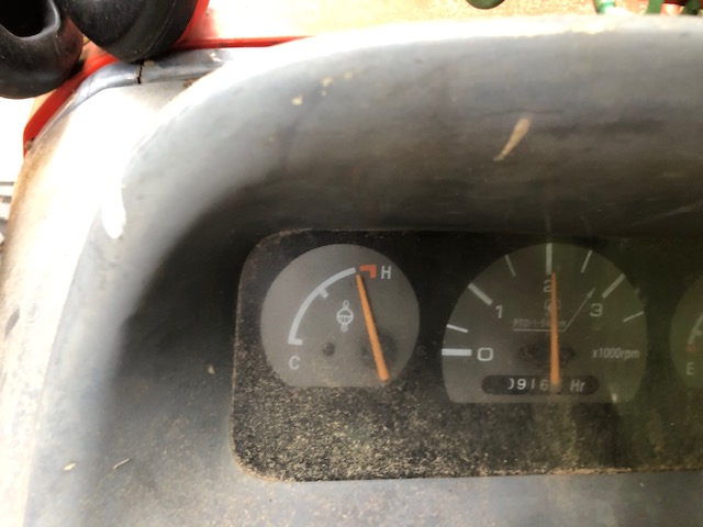

So summer is here in North Florida and I have been mowing for about two months. While doing this the other day it was in the 90's and the water temperature got a little higher than I like it to be so I did the following.
1. Verified that the mesh screen was clean in front of the radiator
2. changed the coolant (probably had never been changed)
3. Sprayed the front of the radiator with a focused spray noozle
4. verified the belt is tight
5. verified the overflow was at the right level after the coolant change.
Still runs too hot in my opinion. I am using a 4' Kioti FINISH MOWER and it takes about 30 minutes to get that hot.
Suggestions?

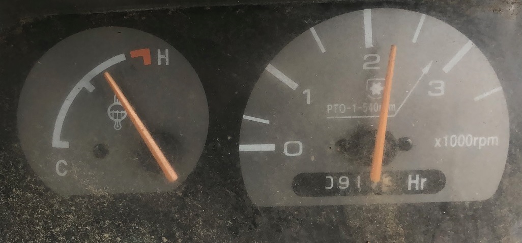

You must verify that the radiator fins are clear. Use a light behind and look through the fins and it should be 100% clear and open.

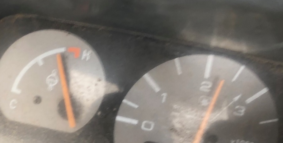

If the radiator is clean, I would either take the thermostat out completely or replace it. Do you have an infrared thermometer? If so I would take temps of the radiator and block when it shows it that hot and see what the temperature is. It could be the sensor for the temp gauge has gone bad and giving you incorrect readings.
   / Temperature toooo high #10
You can test that thermostat on your stove top. Put some water in a pot, get a thermometer in there, put the thermostat in there and turn the heat on. Watch for what temperature it starts to open. 195deg F is a pretty common rating, but look for a temp stamping on it. If it does not start to open when it says it should, its bad.
