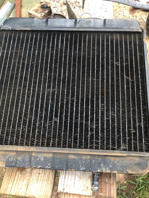

Forgot to put up the picture after the cleaning was done... Start on putting it back together and that appears to be tougher than the disassembly was.

Is that rust I'm seeing in your first pics of the radiator?
Have you noticed any coolant loss?
I suspect it might be an issue of a lack of pressure. Either the radiator is leaking and or perhaps the radiator cap is bad.
A partially stuck (not fully opening) thermostat can also be your issue. You cannot know unless you actually test it (if everything else rules out). ALWAYS test any new thermostat before installing to ensure you're not installing a defective new one.
Coolant passages in the radiator can also be partially blocked. Others have commented on this.
   / Temperature toooo high
#33

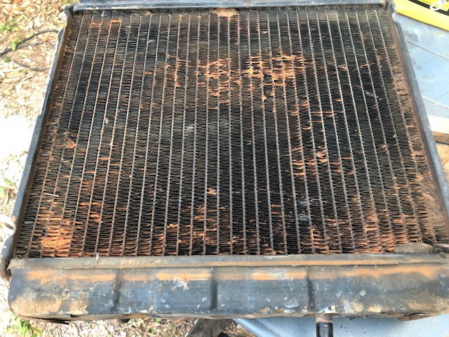

Is that rust I'm seeing in your first pics of the radiator? Nope just the Clay/Sandy soil we have here in Nawth Fla
Have you noticed any coolant loss? No loss of coolant
I suspect it might be an issue of a lack of pressure. Either the radiator is leaking and or perhaps the radiator cap is bad. Nope plenty of pressure in the radiator
A partially stuck (not fully opening) thermostat can also be your issue. You cannot know unless you actually test it (if everything else rules out). ALWAYS test any new thermostat before installing to ensure you're not installing a defective new one. Not fully opening thermostat could be part of the problem
Coolant passages in the radiator can also be partially blocked. Others have commented on this. As I stated in my post with the dirty radiator picture after cleaning it I ran water through it at full pressure from the hose and it did not back up, it flowed out of all three exit points at the bottom
There was a LOT of fine debris that came out from blowing and spraying with water from both sides, I can see through it MUCH better than before. So after I wrangle it back in I will post the temp numbers and hopefully they will be much lower than before.

You definitely found the problem!!!! With all that dirt caked into the fins, there was no way that it was going to cool anything!!!!
Which is kinda weird cause the fine screen in front of the radiator has always been in place since I bought it 7 yrs ago. Oh well the re-install adventure continues.
