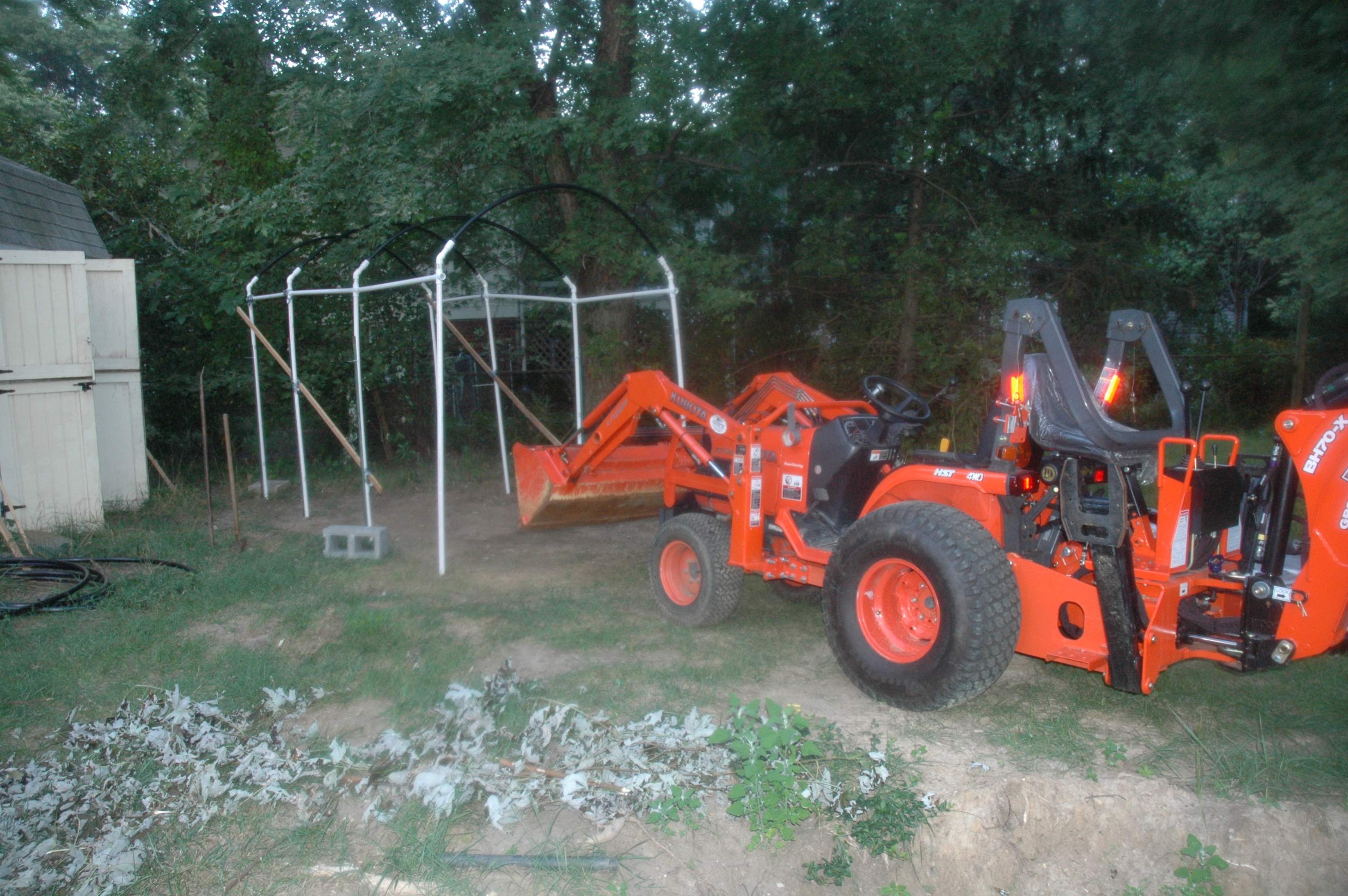

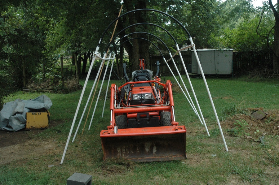

pics

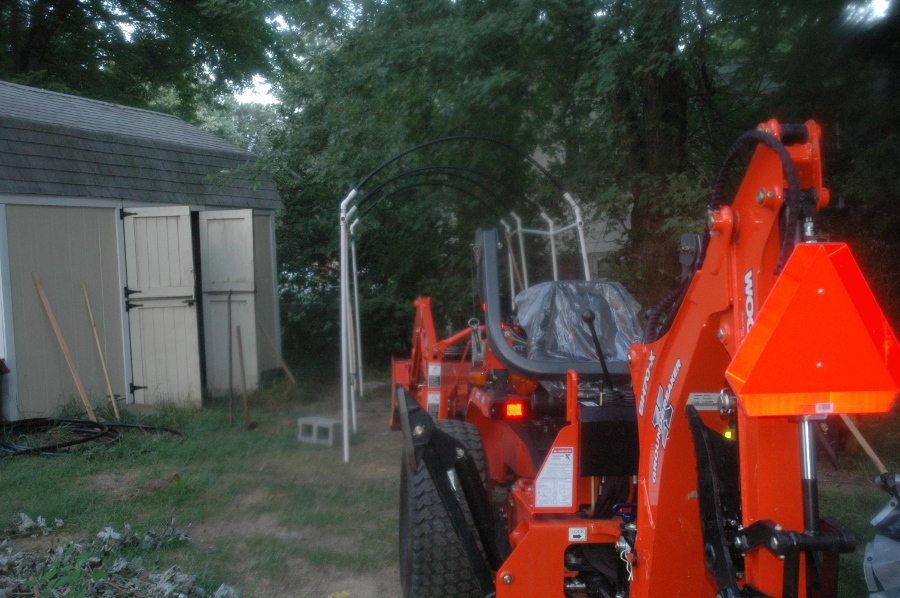

Started with base frame for size
Determined I needed more strengthening for uprights, Put in small T posts and fastened uprights to them.
More details later.
   / Temporary shelters for tractors
#19

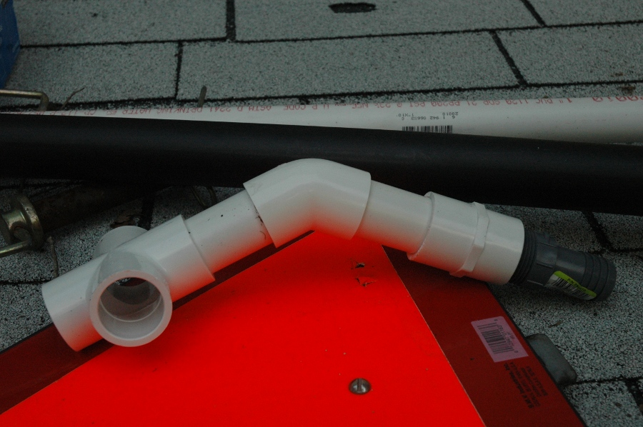

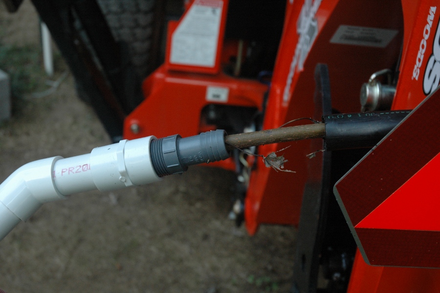

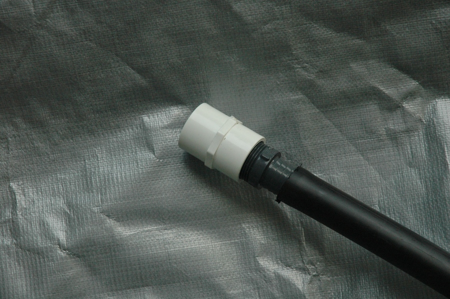

More details:
The first picture shows basically the pipes hooked together by X's on the top and pipe to pipe across (4') as seen in the second picture.
I pounded in a Tpost for each vertical member (vm).
On top of each (6') vm I put - in order a 3" section, a 45 degree bend a 3" section, a female smooth to female threaded adapter and a male threaded to male "barb" this was then hooked to a 6' section of the 1" black flexible drainage (bfd) pipe with a branch shoved up it for stiffening.
I took a maple branch about 3/4" in diameter and 3' to 4' long and shoved it up the bfd leaving about a foot to come down thru the adapters into the vm. This made the connection from the vm thru the arch much more rigid.
I did not want to us all rigid plastic pipe for the roof because I was trying to keep down the number of joints, yet hopefully withstand an inch or two of snow.
I plan on adding some more cross members to keep the pipes from pulling apart, some netting over the top to prevent sag, and some upgrades I don't know yet.

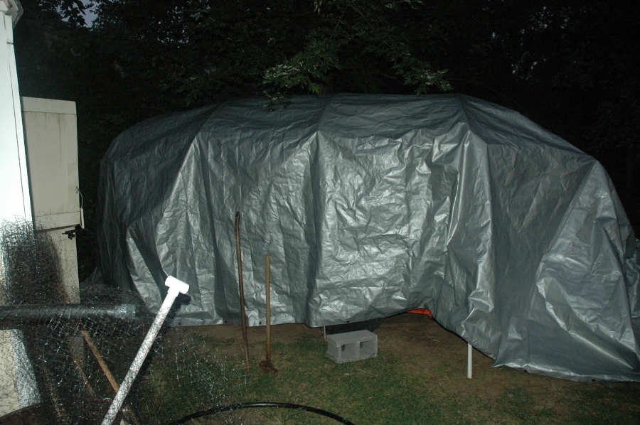

Cost so far is
10' pipes - 11@$2.20@= $25
connectors - about $30
Tarp - about $80 on sale at TSC (on hand)
10 old rusty Tposts ?? $3@ $30 (on hand)
So - the cost is about $200, comparable to the mfg units, but I'm only out about $50 from what I had on hand.
AND
It fit's all zoning regs!
Hopefully more pics to follow. but my batteries dying.
