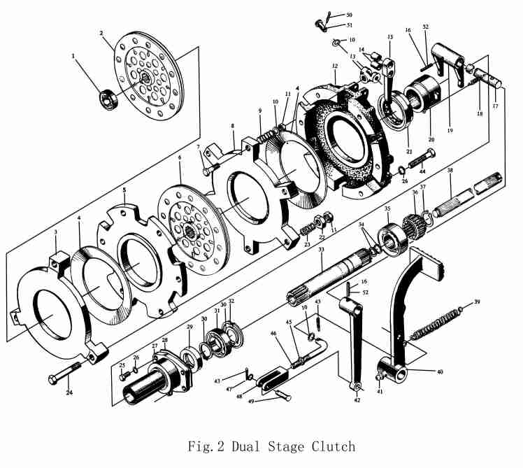

I read in a previous post (#782203 - 12/03/05 03:21 PM) of of a whinning noise occuring during the last half of clucth engagement and then quitting once fully engaed. The other day, at 38 hours on the tractor, mine starting doing it. I checked the fluids and all seemed ok, but decided to drain and flush the tranny anyway after reading this website. Does anyone know what the final solution to that particular problem was. I hope it was NOT the "had to break the tractor in half to replace an O ring in the main shaft". Could it be anything else; and if it is the O ring, is there a way to confirm it short of tearing it down? Please advise. Thanks
   / Temporary whinning during clutch engagement? #2
What you describe sounds like the throw-out bearing. If properly adjusted, the throw-out bearing is not in contact with the spinning clutch levers on the pressure plate when the pedal is all the way up. As you depress the pedal, the bearing engages the levers, pressing them forward and releasing the clutch disks. If this bearing was going bad, you would hear it start to wine as you depressed the clutch pedal and the bearing contacted the levers and came under load. There have been cases where the clutch was misadjusted and the bearing was in contact with the levers all the time. It is a simple greased-at-install bearing. It is not designed to turn all the time and will wear out quickly if left engaged. The same problem can also be caused by some one "rideing" the clutch pedal and not letting it fully dis-engage.
You can visually inspect this bearing by removeing the side covers on the sides of the bell housing directly below the fuel tank. If you have small hands, you can probably even get your fingers on it to see if it rolls smoothly. The access plates are approx 5" X 7" rectangular plates with 4 large bolts on left and right sides. Unfortunatly, this is probably where the Front End Loader is attached to the tractor so you will have to remove your Koyoker loader first. Once the plates are off you can look in and toward the rear and see the throw-out bearing at the rear and the 3 levers in front of it on the rear of the pressure plate. With the clutch pedal released, there should be at least 1/8" gap between the fingers and the bearing face. The lever faces that contact the bearing should be smooth and clean with no discoloration and virtually no wear marks at 38 hours. The bearing face that contacts the levers should also be smooth and without to many marks or discoloration.
Here is a link to John's jinma site and a 254 clutch. Yours is probably similar(if not identical). The bearing and it's carrier are #21 and #20 and the lever on the pressure plate it comes in contact with is #15.
http://www.johnstractor.homestead.com/files/DualClutch.jpg
If this is your problem, then it requires you to split the tractor in two to repair, same as for a clutch replacement.
