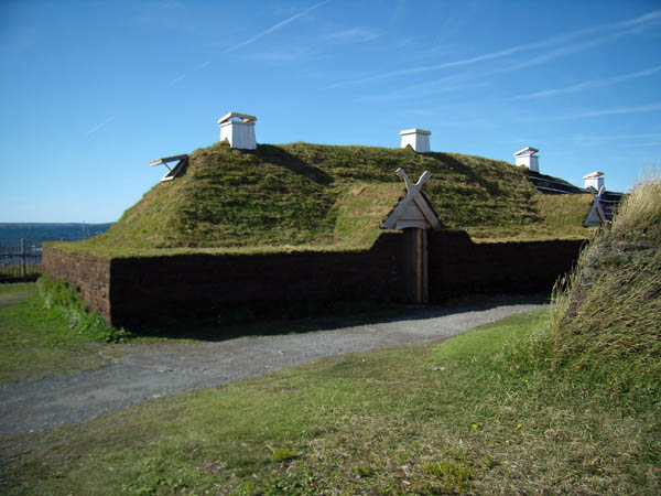

   / Terra-Dome Earth Shelter Build #106
Earth sheltered?
A couple of weeks ago I saw a reproduction of some early earth shelters!:D
   / Terra-Dome Earth Shelter Build #107
Earth sheltered?
Hi Egon,
Of what age and location is this reproduction? I am always fascinated by old homes that people actually lived in, they tell us a lot.
Dave.
   / Terra-Dome Earth Shelter Build #108
Earth sheltered?
Egon, China is one of the world leaders in earth sheltered residences. There are literally millions of people living in caves and homes underground. A popular design for underground homes is an excavated central courtyard open to the sky with the various living areas radiating out from there. This design keeps everything below the natural grade and virtually eliminates exposure to the cold winds. One detail I am not aware of is how or if they drain the recessed central courtyard.
Here in Oklahoma as in Kansas and other venues, there used to be lots of half dugout homes, some with sod walls and roofs. When I was in high school I only knew of one family living in a half dugout. They had a wind generator and 12 volt lighting. Sort of ahead of their time, eh?
Pat
   / Terra-Dome Earth Shelter Build #109
L'Anse aux Meadows - Goggle Images
One site with pictures. [ lots of goggle hits ]
I took some pictures but the truly interested will find much more on goggle.:D
The Vikings In Newfoundland
This site gives a very brief history. Note that these Vikings had been expelled from their homeland for behavior not sanctioned by their communities.
Up here on the prairies there were many "Soddies" built that sheltered the early settlers. I never did see one as they were all gone by my time.
I did see quite a few log houses that had survived. These were wattle and mud covered inside and out so walls were very thick. Many had home built clay stoves for heating.
I've always been intrigued by dwellings underground or or dug into cliffs. I do believe there are quite a few sites like this around the world but do have problems locating them.:D
