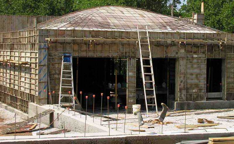

Sam, I know you are busy today with your pour, so when you get time, I'm curious about the curved rebar on your roof. In the photo below, is the rebar finished, or did they add the curved component all the way to the top of the roof? That just really caught my eye as being unusual.
   / Terra-Dome Earth Shelter Build
#28
The different layers of rebar are to add strengh and what you see is complete except for the electrical conduit and boxes on the roof area which will be completed today.
