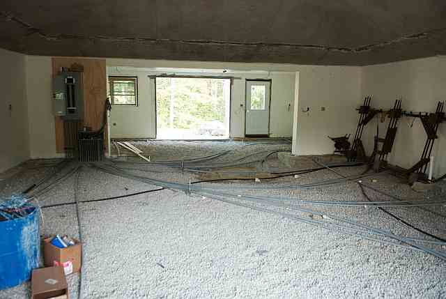

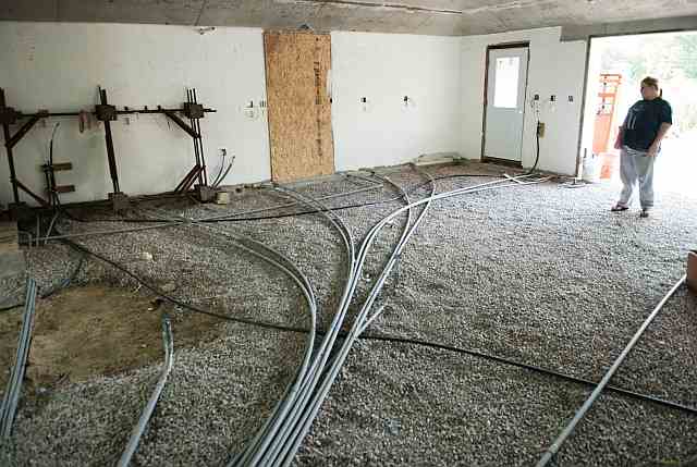

Hi Sam and other folk, Steve in Maine here.
As I mentioned previously, we have added perimeter drains on the roof two ways: the front of the shop leaked, we put a drain tube buried at roof level. We also added drains around the edges *above* the foam insulation board (because it holds the water). We had ponds up there last winter. The crew also put a bunch of clay-sand mix up on the roof (maybe 15 yards). Since we didn't want to crush and break the insulation board, this was moved in 5 gallon buckets. The electric lift got lots of use, as did the high school kids. The dirt went to make the contours a lot better to guide where the water went.
We finally had some serious rain last weekend. Previously, *all* the roof tubes leaked from a little to more. Saturday, only one leaked, the one with a sun tube in it. I went up on the roof and found a seam I hadn't caulked (I caulked it). It rained hard again Sunday--the tube stayed dry! Hoping our leaks are over.
Pics of the shop wiring conduits from last week. Monday they poured the floors. The first date our (former) contractor gave us for pouring floors was July 1 2009. The 4'x8' steel frames leaning against the wall are cast in the concrete, with the plates just flush with the surface. Each 8" square plate has four 3/4-10 holes in it (filled with set screws and wax right now) to allow tying a larger project (like a gate) down to the floor. The concrete guy spent hours on Saturday with a laser shimming each plate to the right height. It looked highly improbable, but they all came out near-perfect. Excellent work.
Steve

Hello Steve,
I am pleased to hear about your progress. I guess you are moved in? Right! I am impressed with your concrete guy. I would be interested to see more details on this conduit install.
We are busy with installing conduit ourselves. We are using the Schedule 40 rigid PVC for everything but the black and gray water drains. We are installing 1-1/4" conduit to later pull/push our 3/4" PEX water supply and 3/4" conduit to pull/push our 1/2" water supply lines. If anyone has experience pulling PEX through conduit please provide your thoughts. Pictures attached.
   / Terra-Dome Earth Shelter Build #310
I as an electrician that is some good conduit work and fore thought on the runs.
Just thinking out loud I wonder if you heat the pex and pull it it might get a taper on it and then hook it to your fish to create a tapered end.
I don't recommend using jet line or conduit measuring tape to pull in your runs (the measuring tape is great to measure the precut your runs though).
I've had them cut in to the sweeps and get stuck in the pipes, and unless you pull perfectly vertical on the riser it will cut at the top of the pipe.
I use a fiber glass fish with a 12" cable leader to fish and pull most all my runs and if that wont pull in a run I use a piece of #12 thhn with some pulling lube, that is slicker than snot on a door knob as my grandfather would say.
