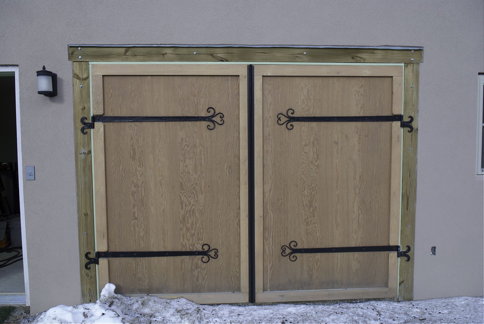

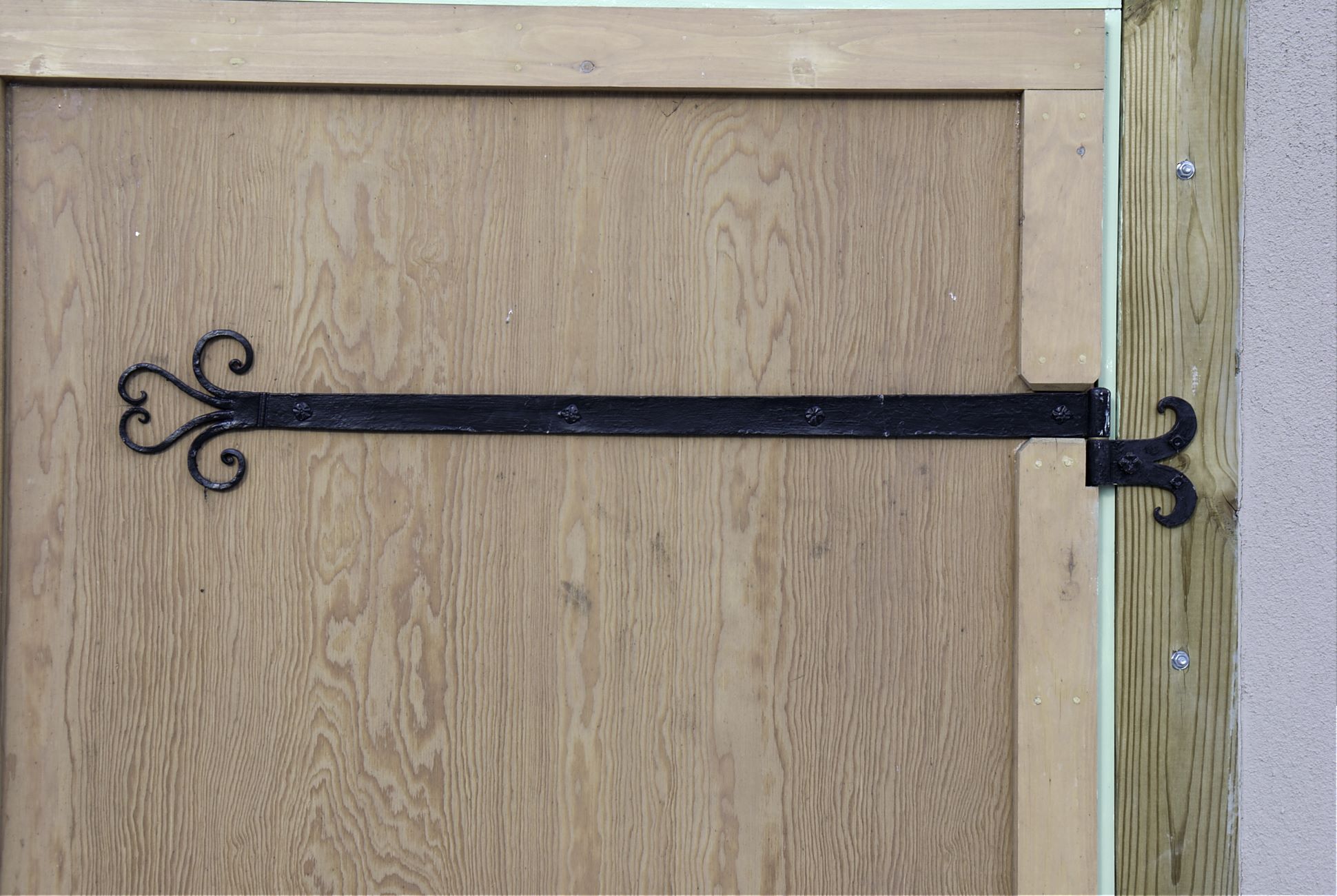

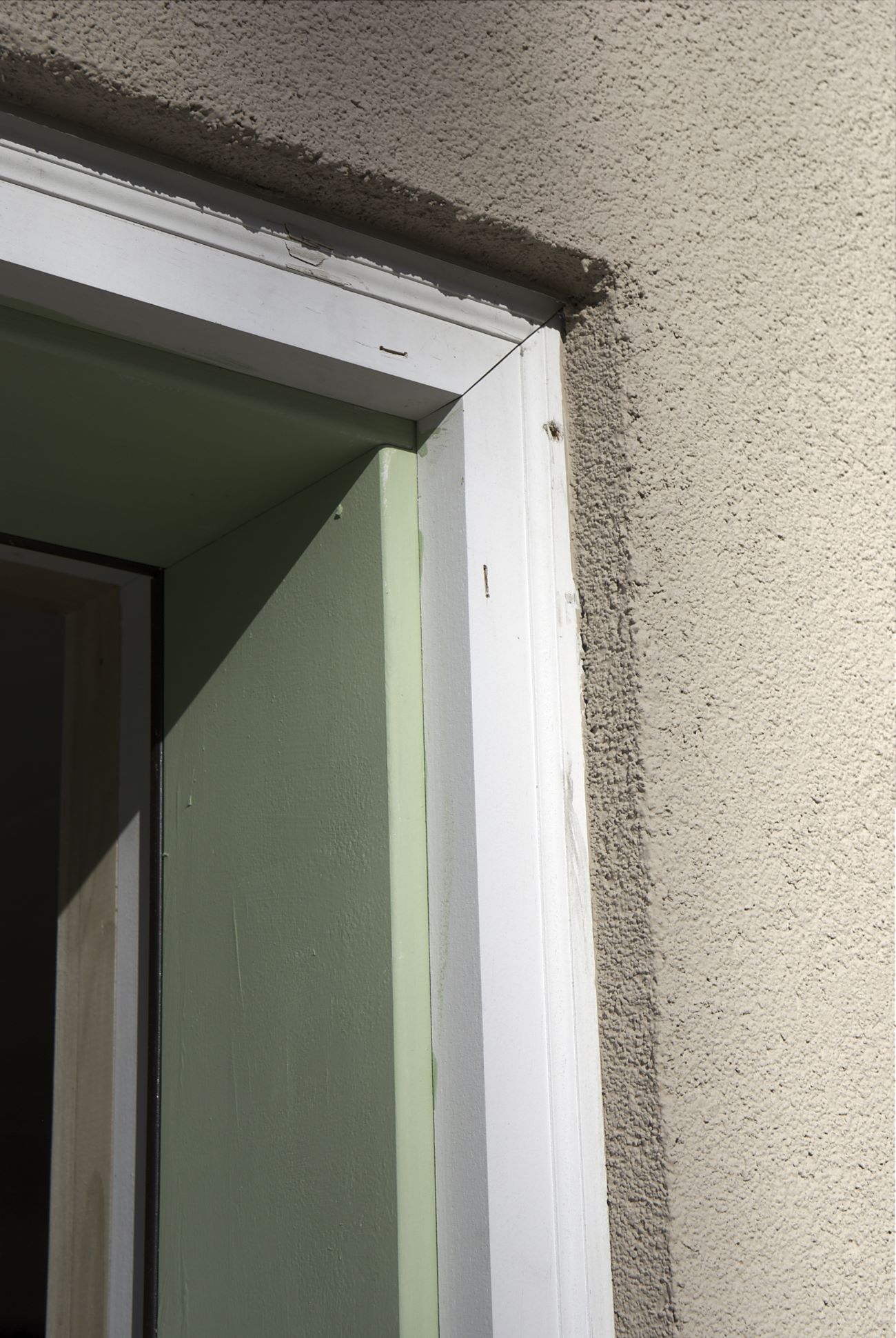

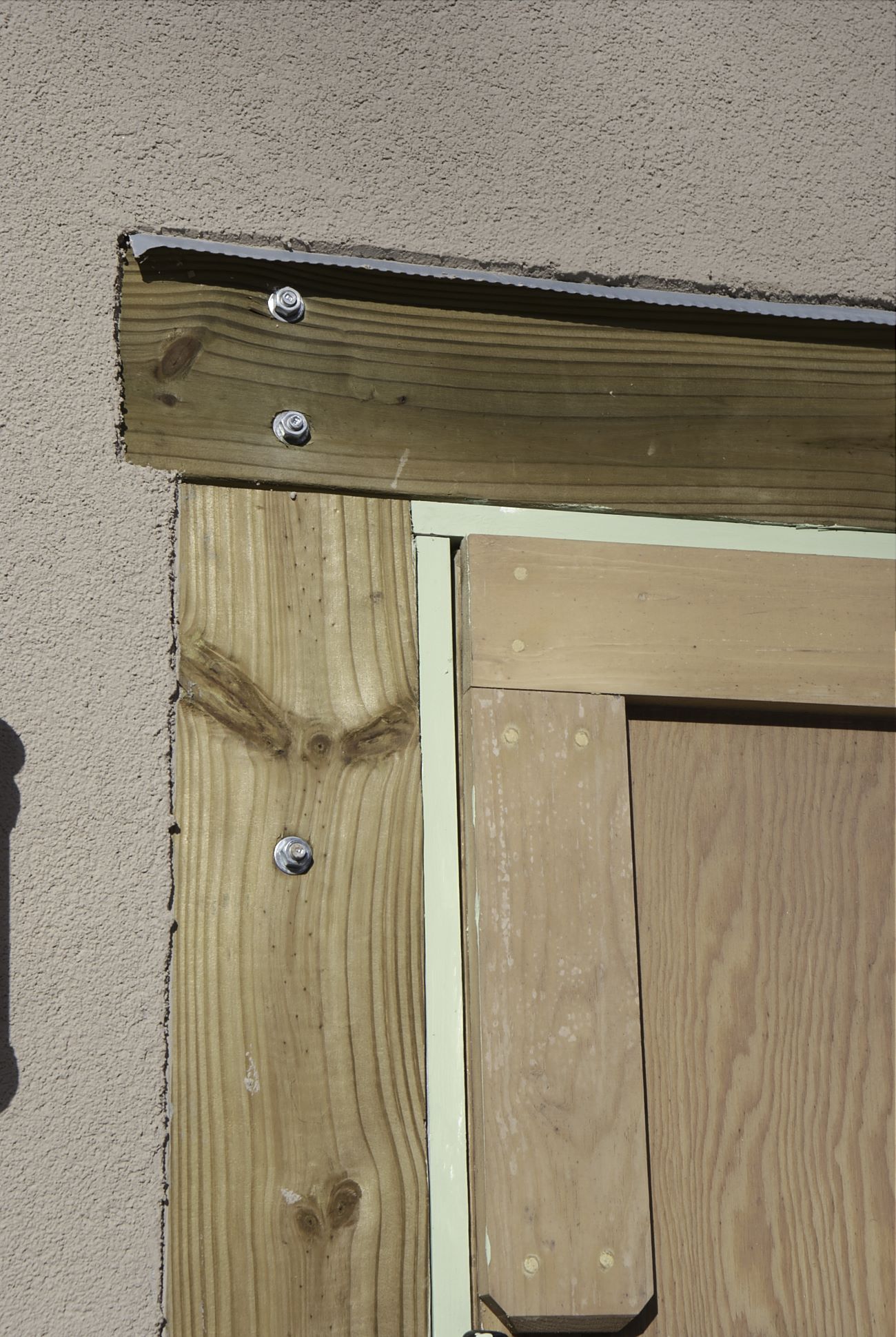

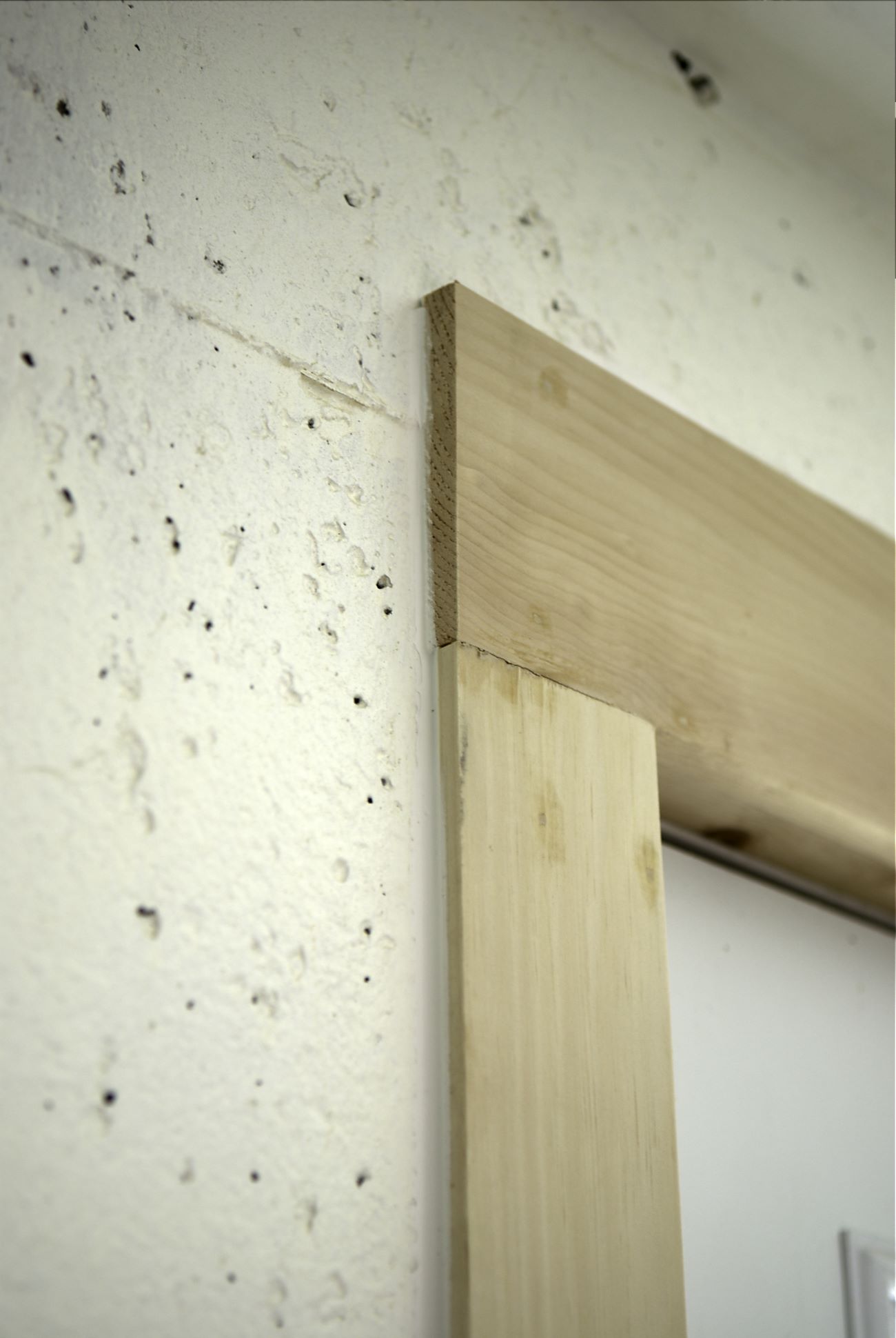

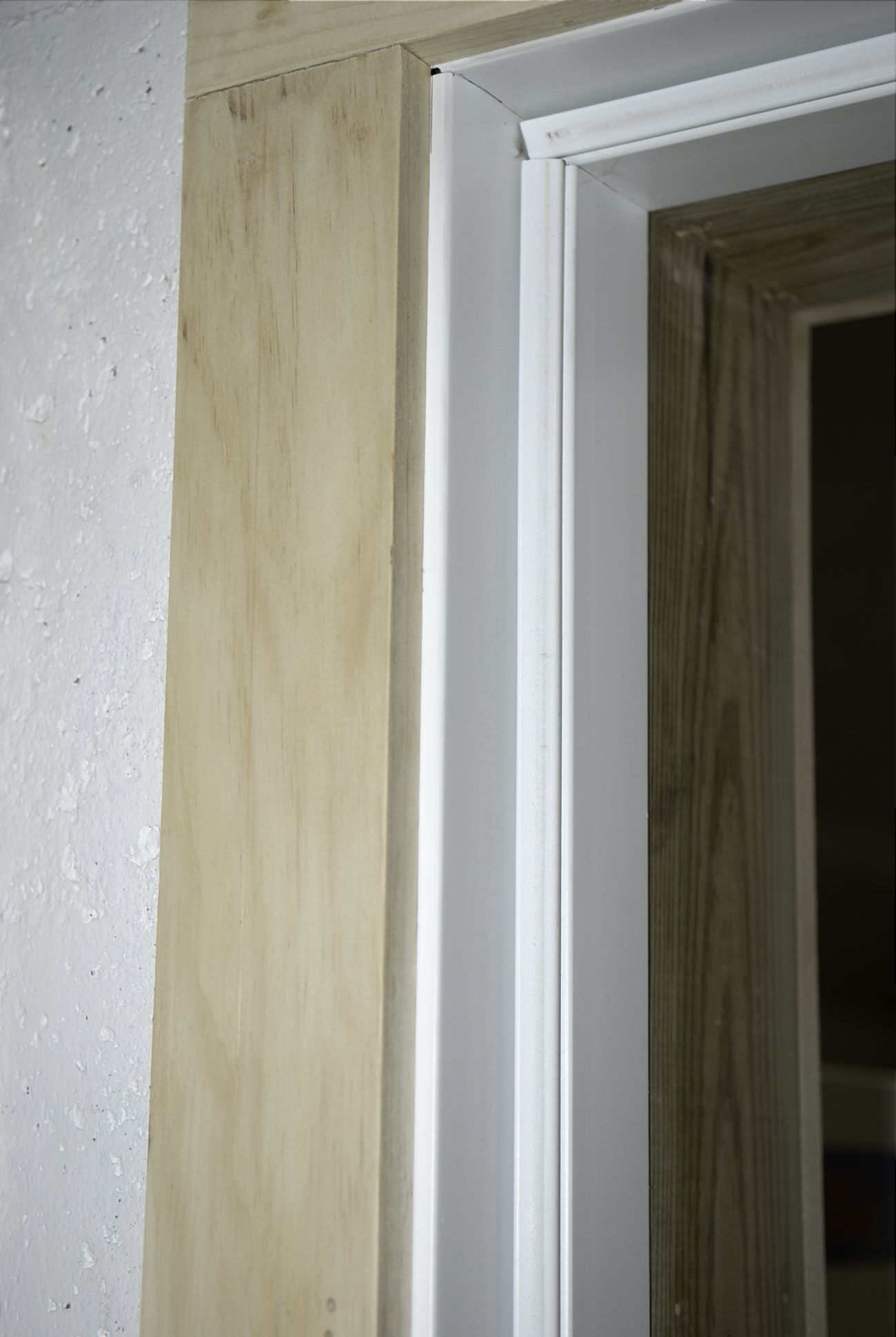

Door framing on our Terra Dome house in Maine.
1597 and 1598 are interior framing on a 36" door. The molding was planed to a useful thickness, shimmed where needed and the outside edge caulked. Without the caulking, some of it was unsupported and might have split if leaned on. 1600 is the exterior.
1601-1603 are shots of what I made for the 7x9 openings on the shop and barn. I specifically didn't want an overhead door track in the shop, swinging doors seemed like a good idea. I'm a blacksmith in my spare time, the hinges were straightforward but a lot of work. There are a total of 12 hinges (three door openings). The pin sits in a bronze bushing.
The gap down the middle is filled with door brush material to keep out most of the draft. I plan on adding some solar hot air panels next summer.
Steve
