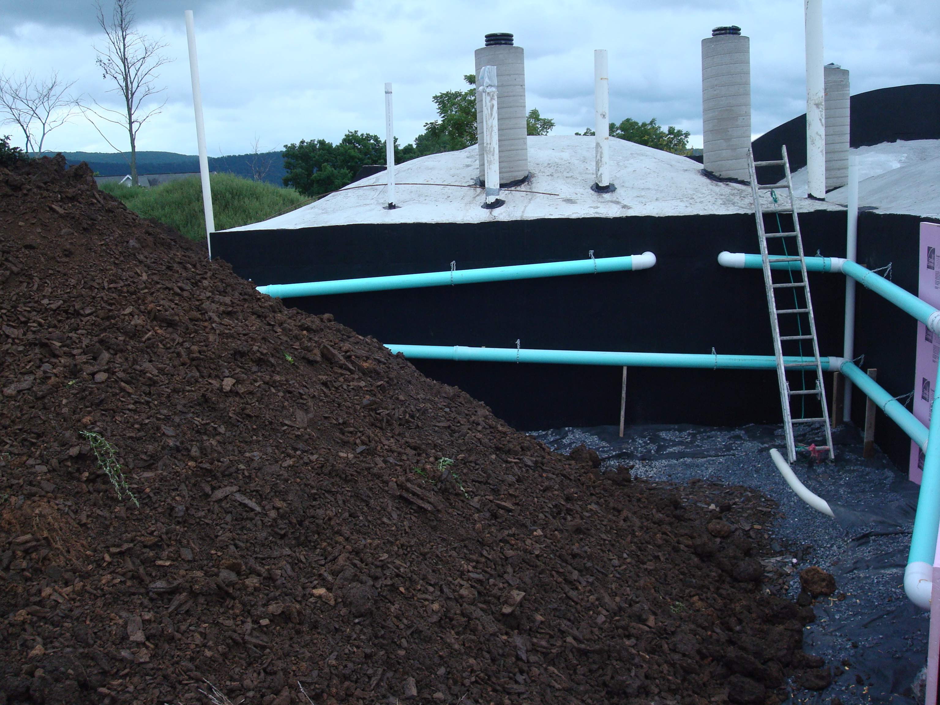

Hi Tom,
Your results are encouraging. Sealing the insulated duct should stop the condensation. Tempering the incoming air is a good idea and should limit the
defrost cycle on the HRV. The tubes around the wall are for this purpose.
Bob
