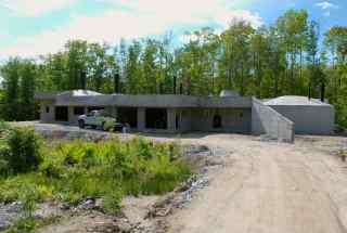

We're making headway on our earth sheltered house. Attached is a pic from this June. We've had an amazing amount of rain which has put in a lot of schedule delays. The roof and buried walls have been sprayed with waterproofing; if the rain really stops this weekend the bentonite sheeting will go in Monday and the rest can move forward.
Our house structure was also done by Terra Dome. The rest is being done by a local contractor.
Sam, I was interested to read that you're building yours on grade. We're doing the same thing. Our site is relatively flat, and we have pretty wet ground. Building on top sounded lots better than digging in for our case. Water in the basement is one thing, water in the living room is a whole different issue.
The house is about 1800 sq. ft. (three 24' square modules) plus a good sized shop (28x40) and barn (28x28, 11' sidewalls to allow for hayloft).
Better pics can be found here:
new house - a set on Flickr
To avoid confusion in the Flickr pics: note that we started with Formworks, some of those original plans are in the Flickr set. What we ended up with is Terra Dome, the second set of plans.

That place is Huge. Very nice design..
But why did you switch installers?
Also, what was it like getting things done in the winter?
