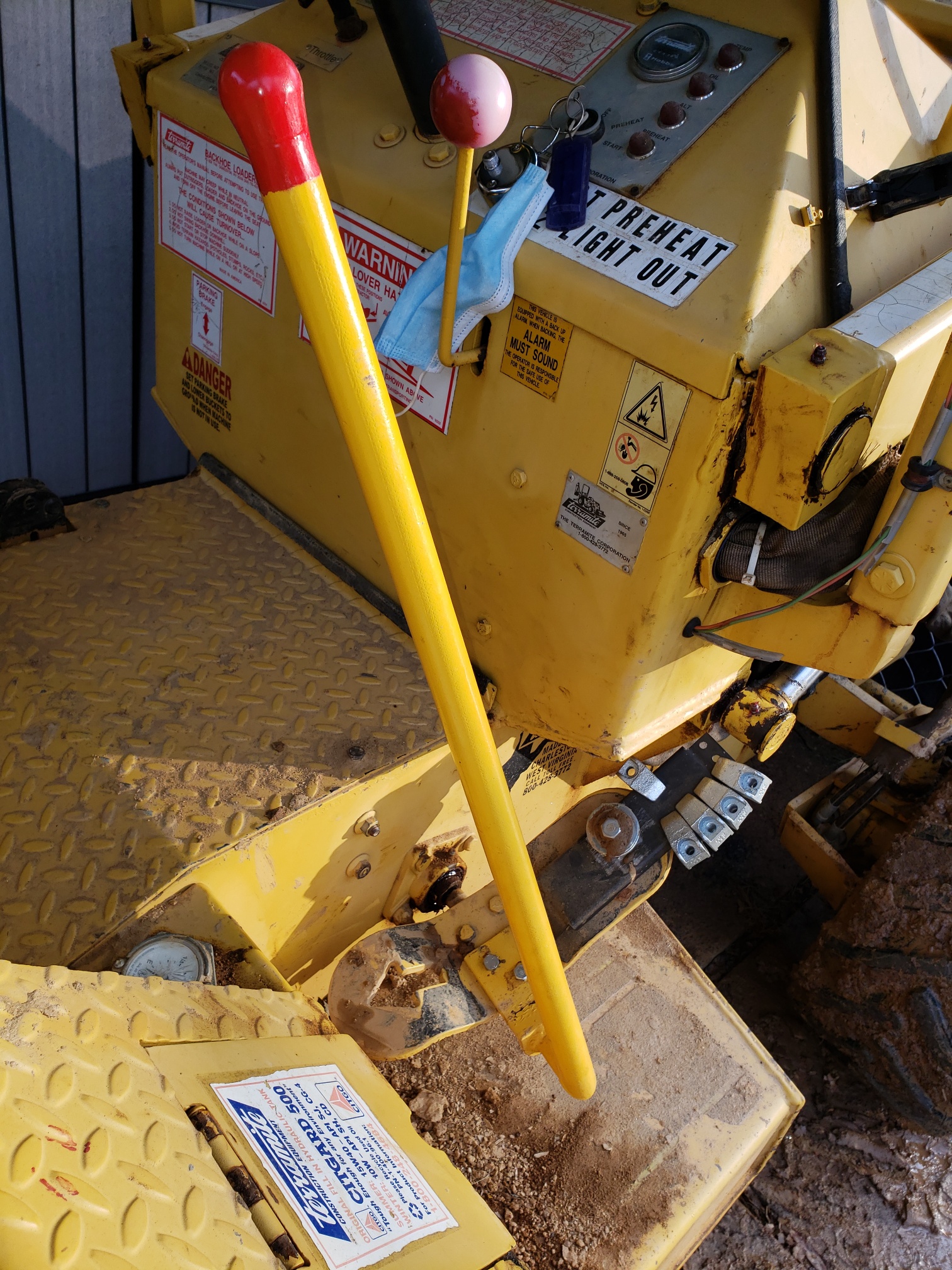

T6 extension handle for the foot pedal, reduces foot stress and allows machine to moved while seat is the backhoe position. Counterweight needed to control constant drag on reverse gear, combined to create a pedal extension to reduce foot fatique.View attachment 680441
Absolutely helps, I did something similar.

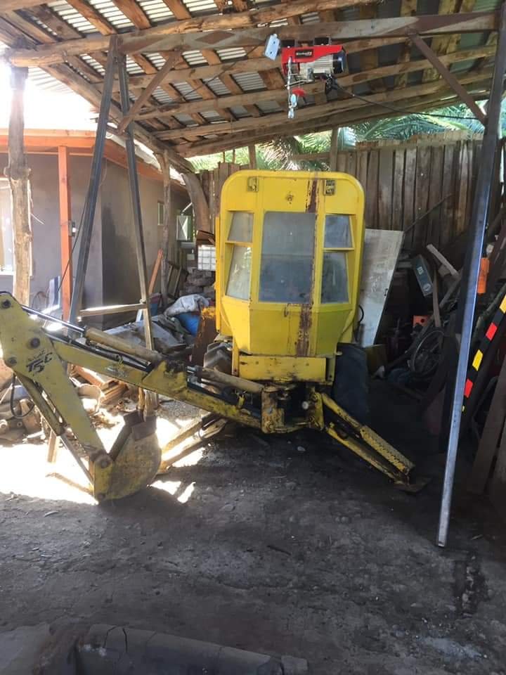

This forklift mod just popped up on a Creiglist post... Like this setup over the clamp on forks... Don't need to worry about bending the bucket and you can easily slide them side to side... 129760427_10159007308118619_8784378859548283314_o.jpeg130036936_10159007308103619_4917224961196612367_o.jpeg130599961_10159007308213619_530201730801968327_o.jpeg

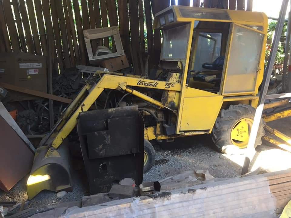

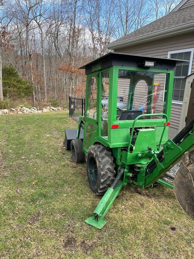

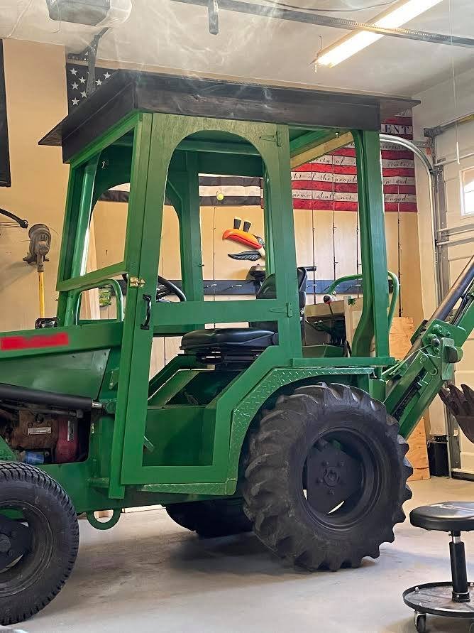

Cool T5C just popped up on FB marketplace with a custom built removable cab...even has a heater...141010184_10223950776174337_846535207213652672_n.jpeg140943678_10223950774814303_8081388205038425871_n.jpeg
