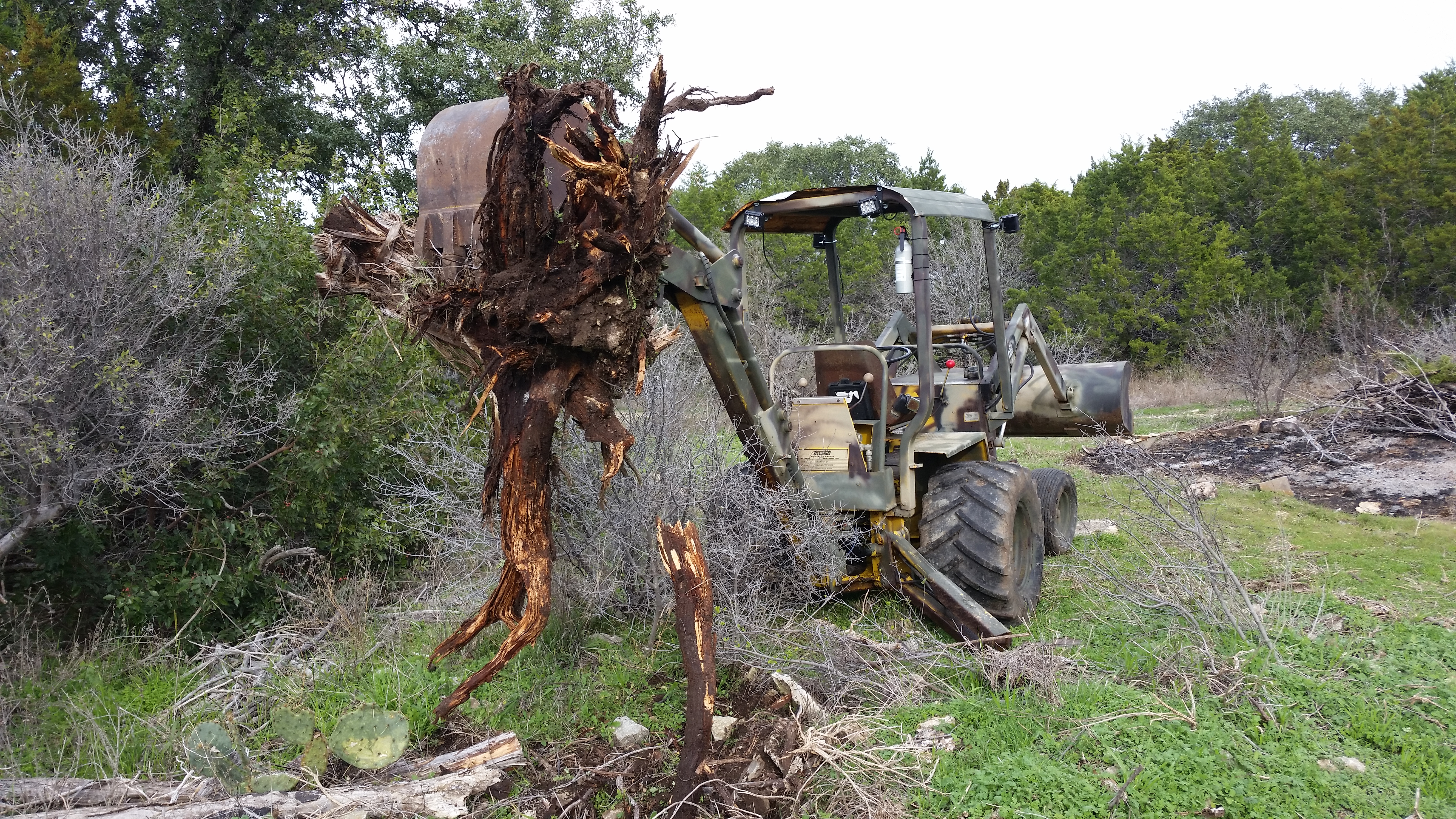

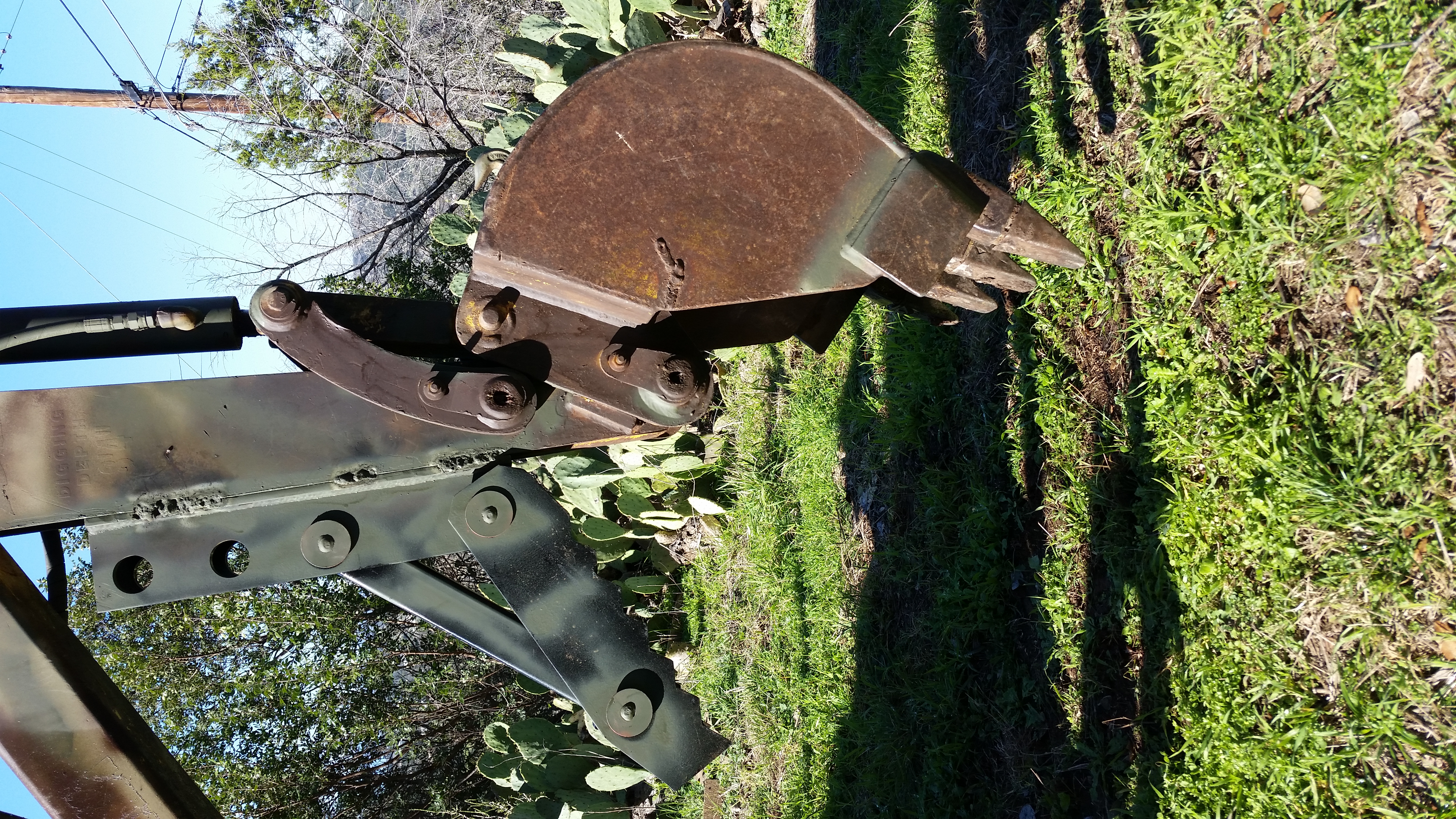

Hey Everybody.
I'm a long time reader, and just decided to join the discussion. I followed many others as they discussed the thumbs on a Terramite. I finally decided on my path, and now the thumb is installed and fully operational. It is very cool. I can pick up massive cactus, really big stumps, and all sorts of other cool things. It will pluck bushes right out of the dirt....roots and all.
I realized the thumb placement is very important, so I needed to move it closer to the hinge point.
   / terramite backhoe thumb #7
Hey Everybody.

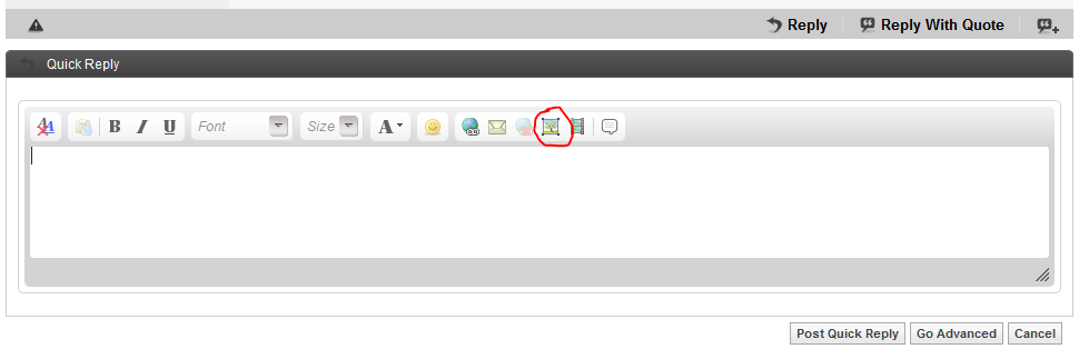

Dan,
I have made a very simple one. Not sure how to post a pic of it. This is all I get when trying to insert an image. 0512161037.jpg0512161037.jpg0512161037.jpg Please tell me how to post pic.
Geo

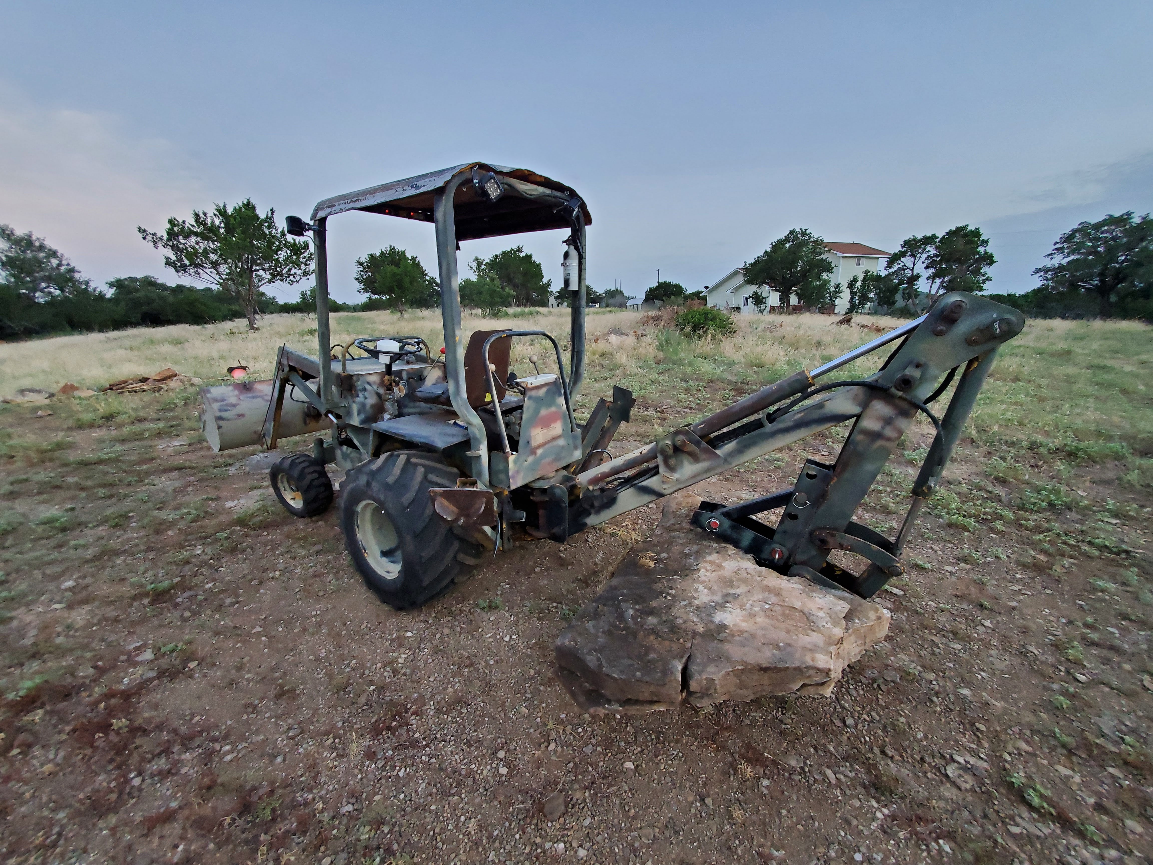

This T5C and backhoe thumb continues to amaze me. This lil tractor is a rock hauling and stacking rockstar.

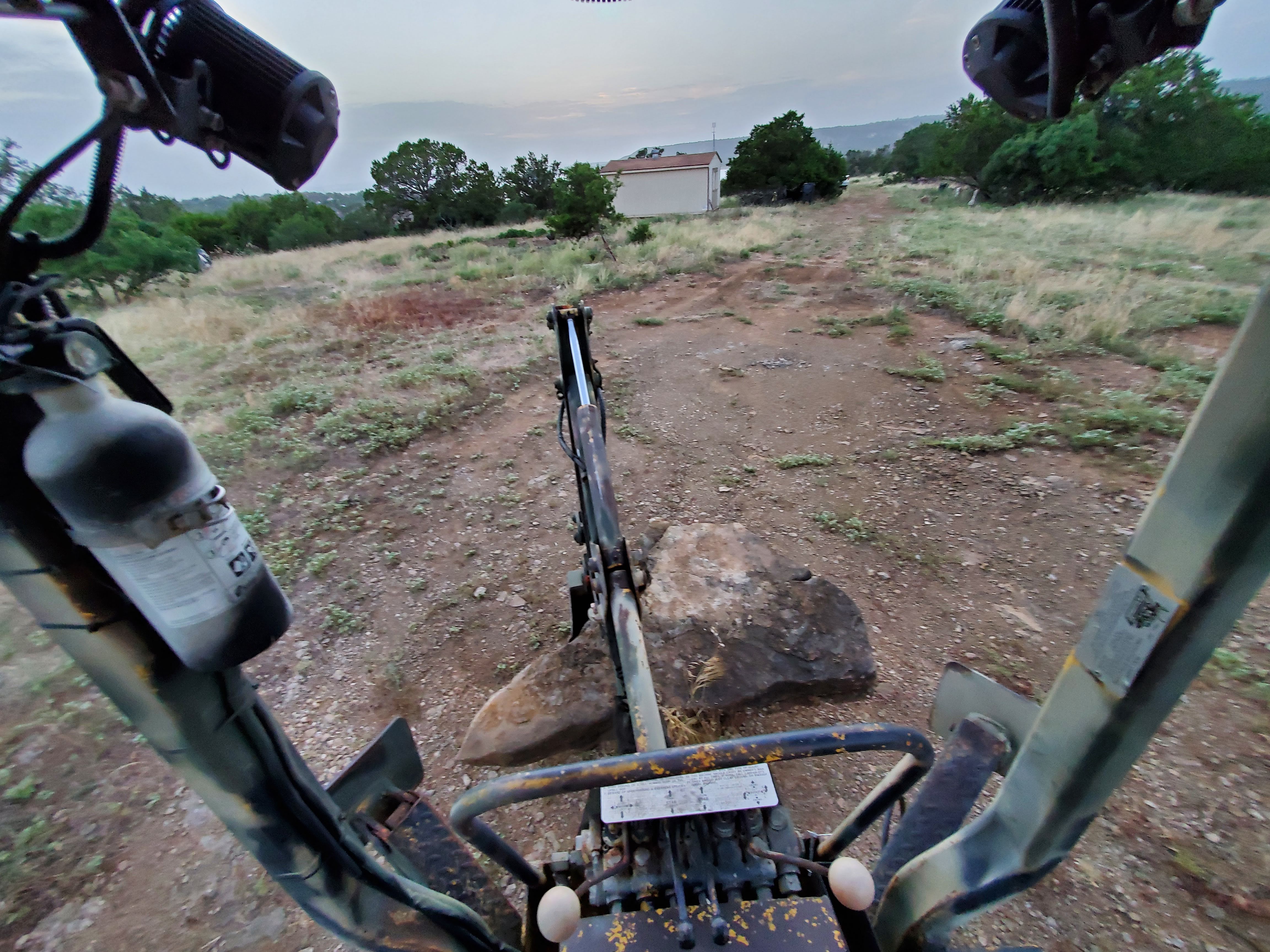

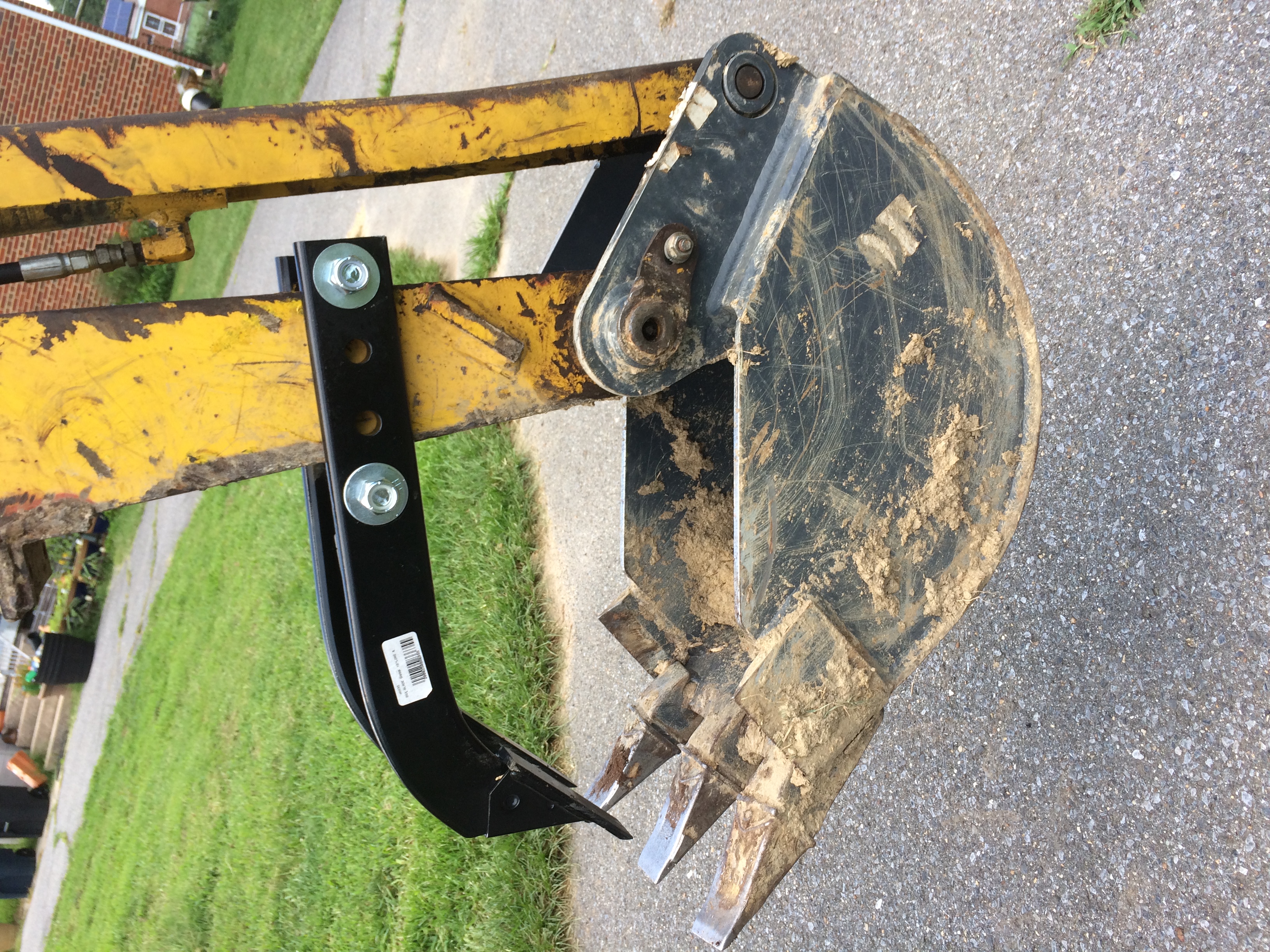

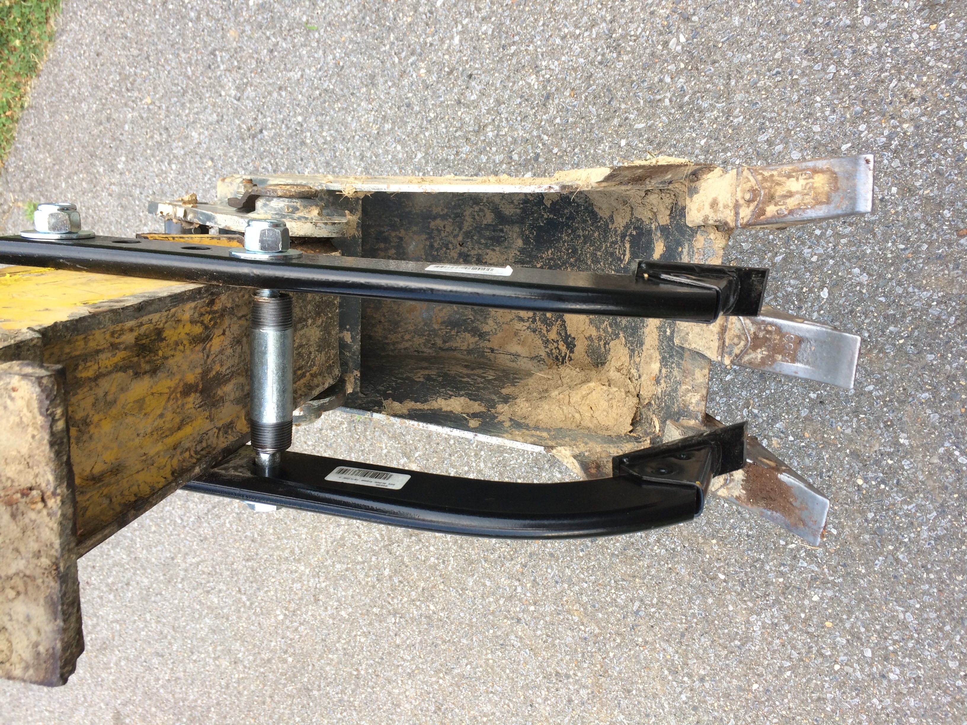

CHEAP THUMB
I can't recall where i saw the post but I have installed a cheap homemade one on my T5C.
LIST
Box blade shanks with the(4)holes (2)
Bolts 1/2'' x 7'' (2)
Nuts 1/2" (self locking type) (2)
Fender washers 1/2'' (4)
Pipe 3/4'' x 4-1/2'' (2)
You can adjust the size of the bite up & down the dipstick by just loosening the bolts.
Because there are (2) thumbs it is more stable when picking things up.
It will move a little with heavy use due to the taper of the dipper stick but a weld/bolt would keep it in place.
I haven't been able to figure out how to send pictures but I can send an email if someone can post it.
   / terramite backhoe thumb #17

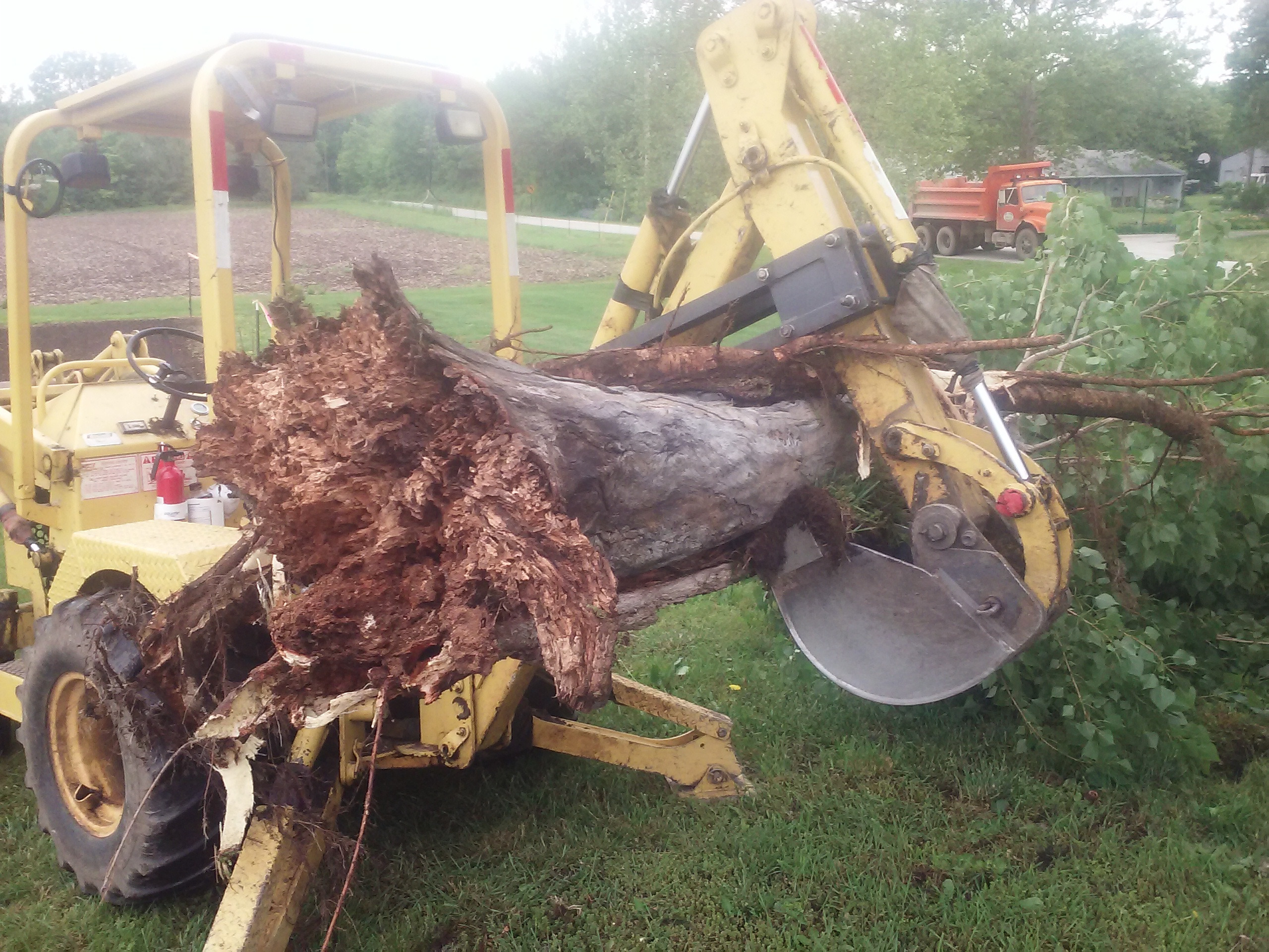

CHEAP THUMB PICTURES
Hope this helps a few of you who want a cheap heavy duty thumb.
I like it because if any part of it breaks it can be repaired from supplies from the farm store.
You may notice the pipe is acting as a spacer & to take up some room too.
I was considering welding some pipes along the dip stick to keep the thumb from moving around in heavy use & have adjustment along the dip stick.
Please let us all know if it worked for you & if you improved on it :)
