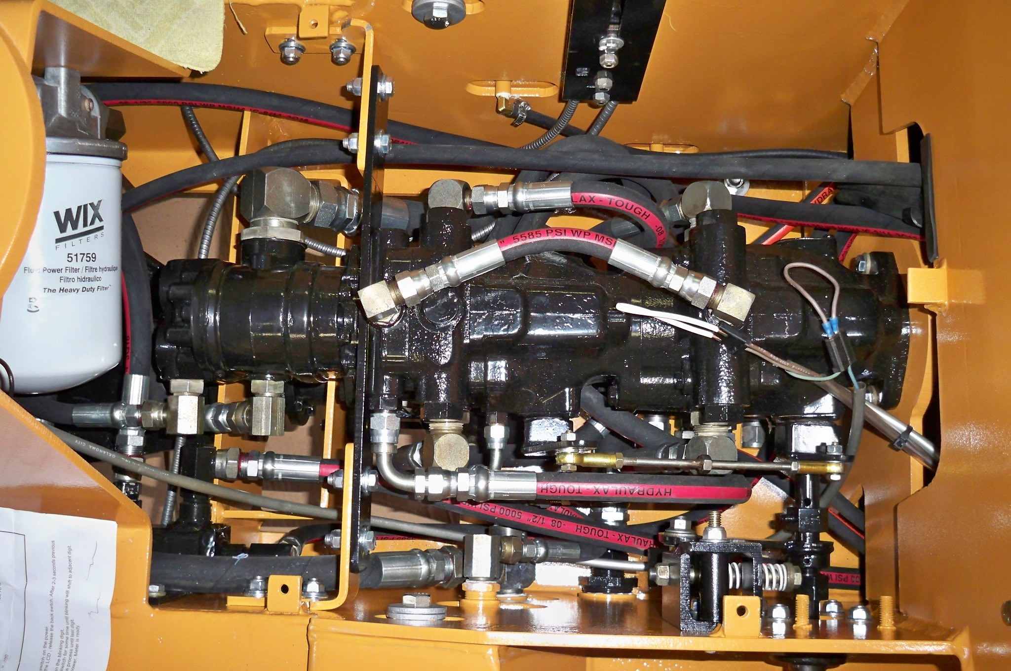

Here's what a 4 wheel drive setup looks like. The short hose right on top is supplying charge pressure from the rear pump to the front. The charge pump supplies relatively low pressure oil to the piston pump so it doesn't have to suck it up. If your charge pump is not supplying enough oil to the piston pump it can't work right and probably will make a lot of noise.

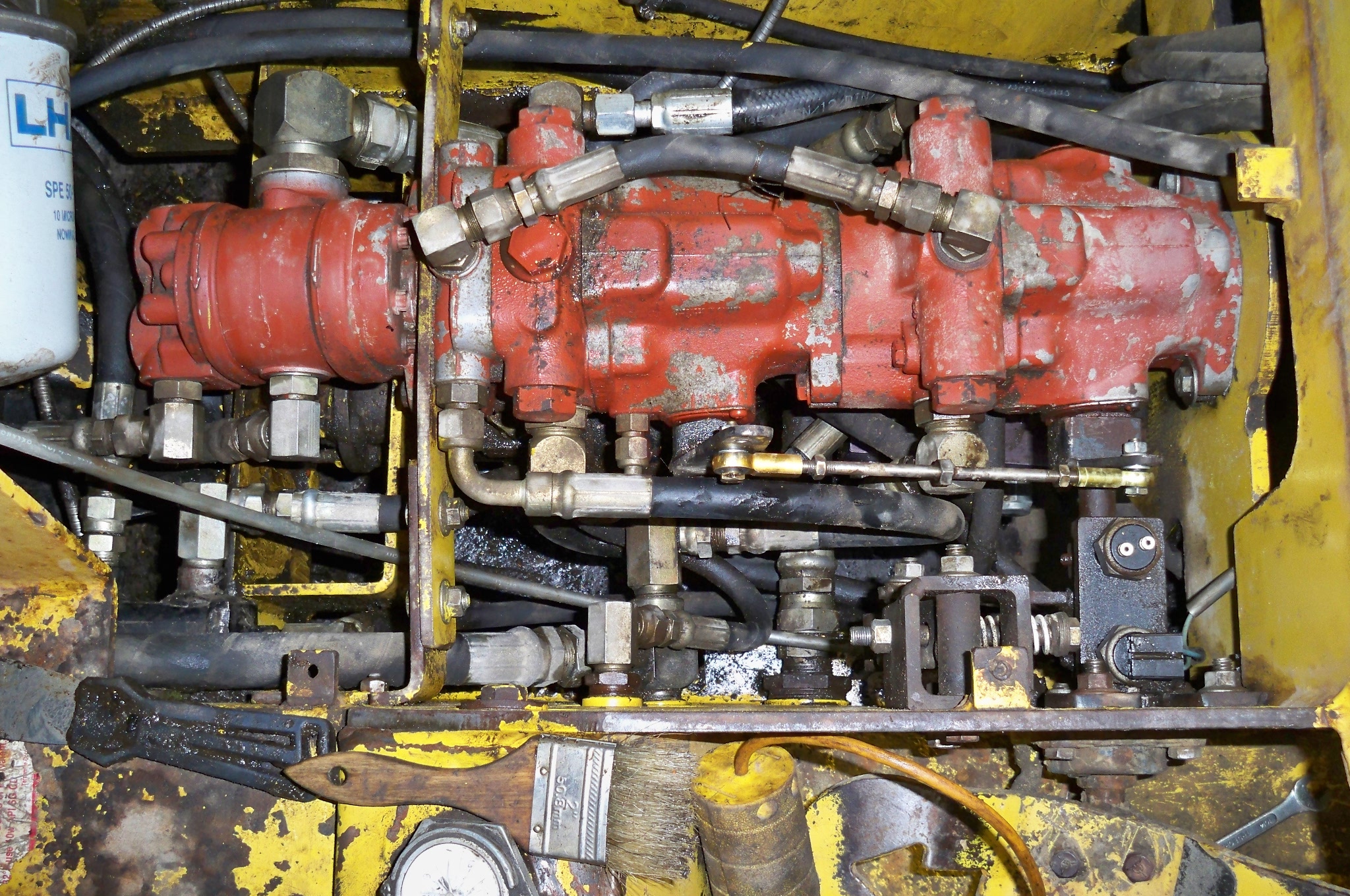

Here's one of things cleaned up a bit and new hoses. 10 pounds of S*** in a 5 pound box.
