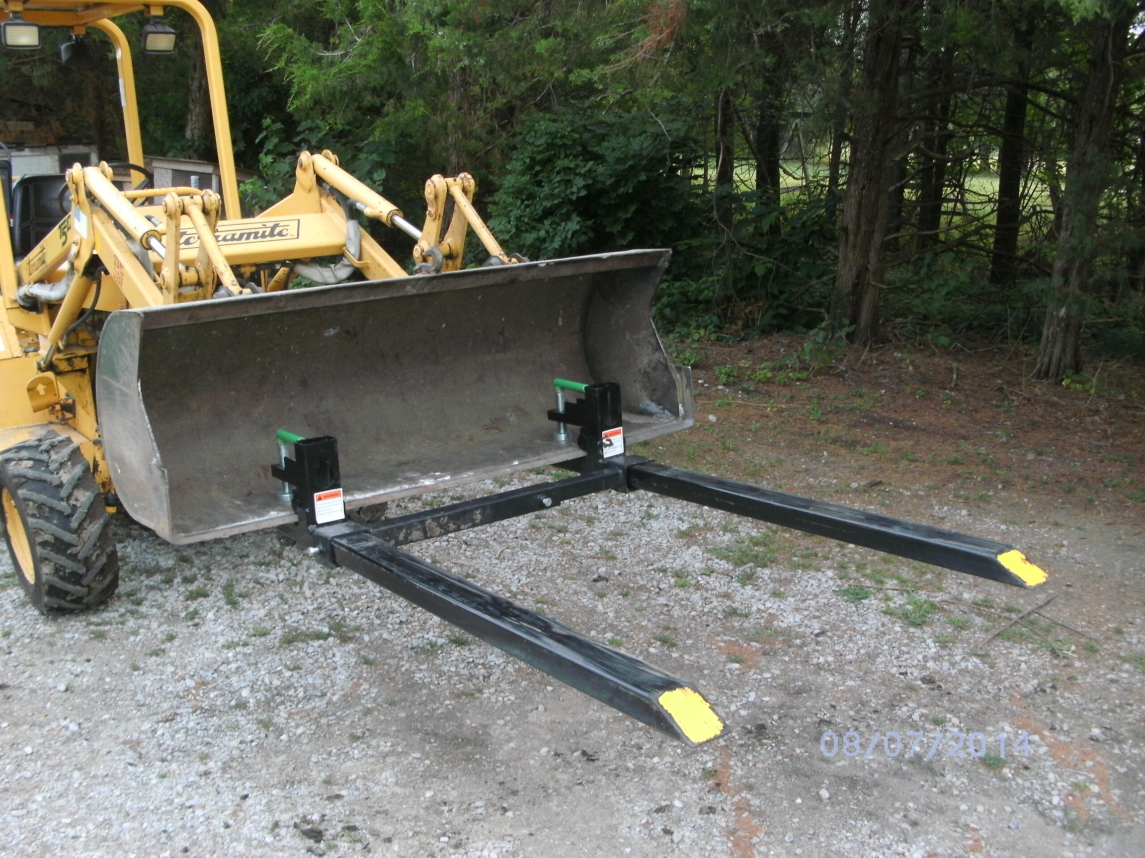

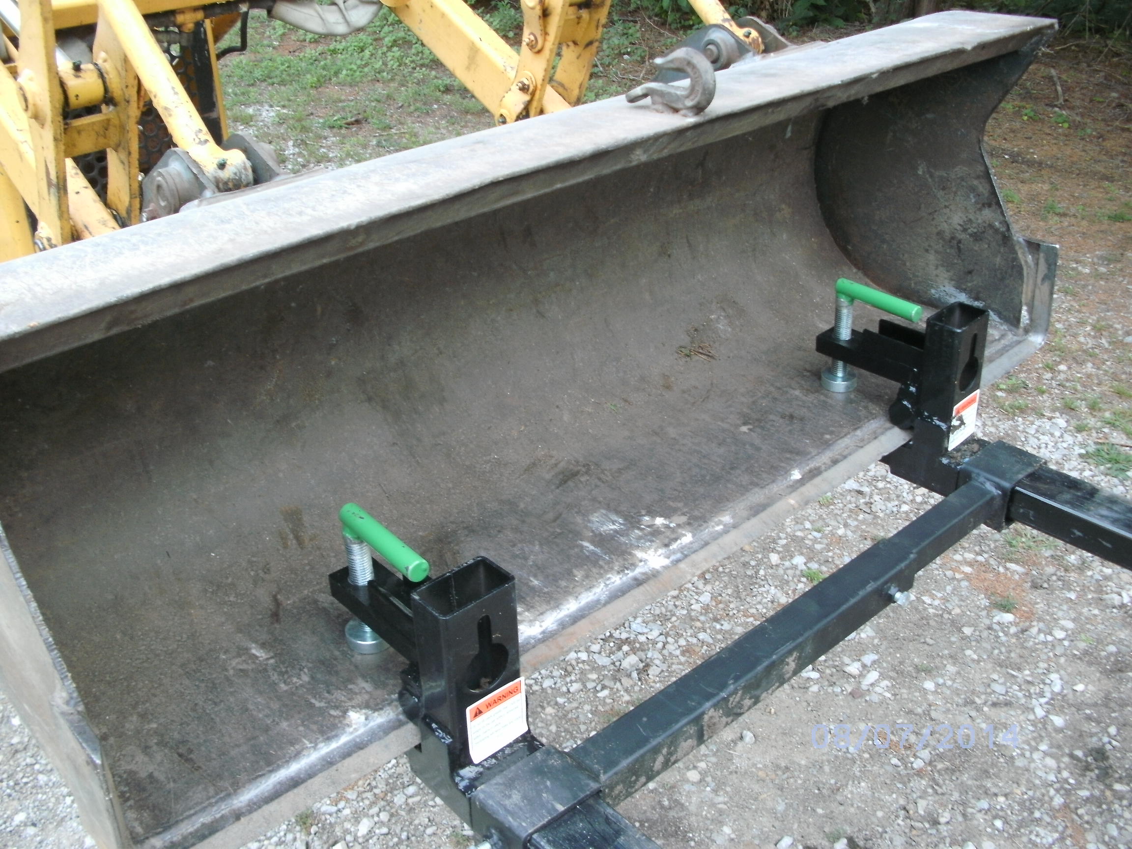

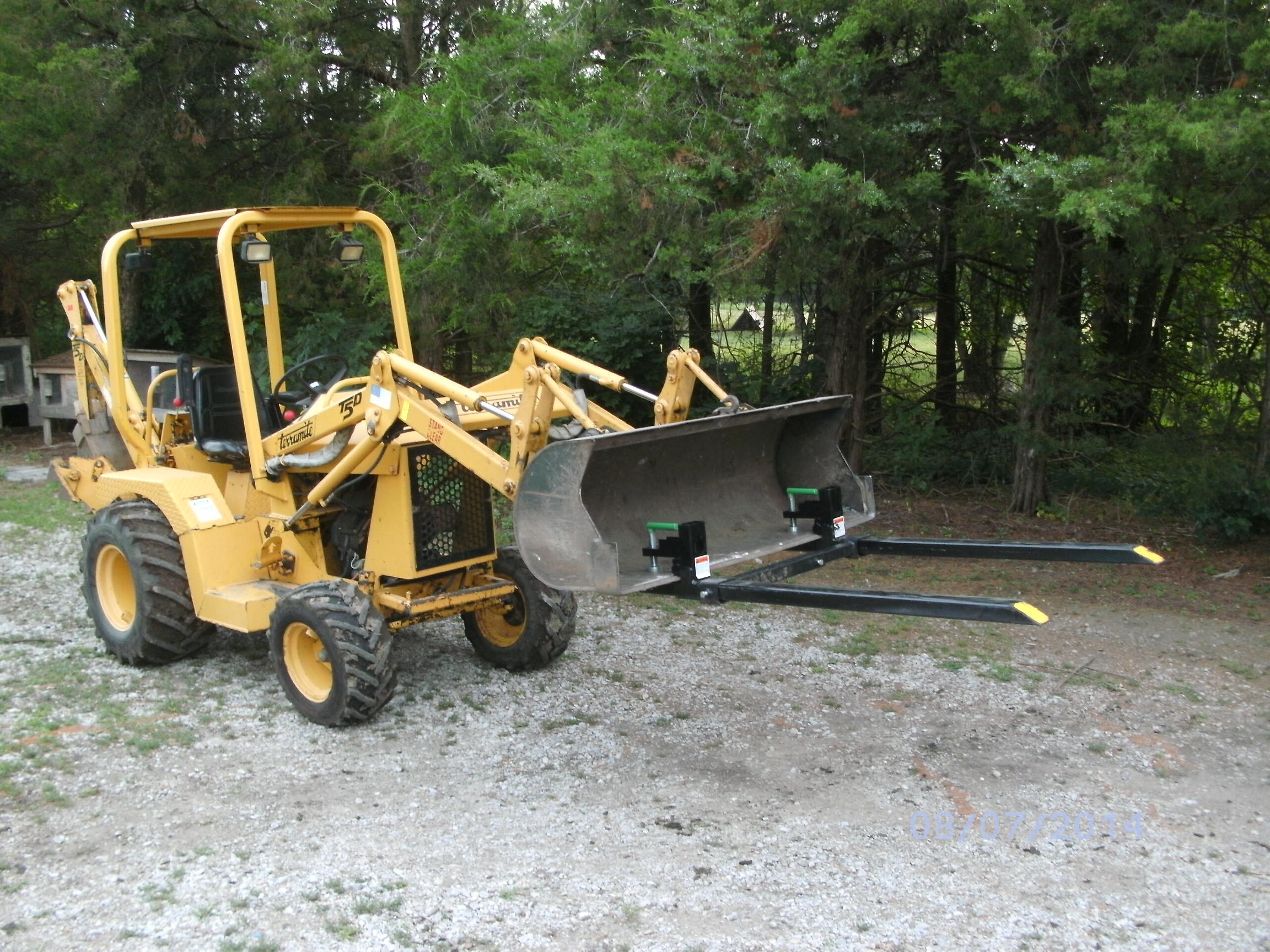

I bought these clamp on forks from a company called titan. They work Great for moving pallets, logs, and brush. I think they were around $170.00 with the cross brace. They install or can be removed in less than a minute. They also have pockets to put some stakes in for added roll back protection or brush hauling. They have slots to chain them around the bucket for added lifting strength. I have never had to chain them on, they work great just clamped on. These are rated at 1500 pounds lifting capacity.
