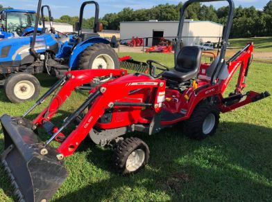

I stopped by my local dealer yesterday just kicking the tires, mainly to look at a used 2018 GC1710 TLB he had for sale for $13,900 with 188 hours on consignment, pic attached.

Salesman and I talked before looking at the GC1725M's he had on the lot, basically discussing the same old adage where you see people selling a used one with most likely 0% equity and just under what new ones cost. I see units for sale all the time that are used for very high and near new prices, same old story right? That led us into a new one just being the best way to go..........

Well look, you sat on (and I assume tried out) both. Is the new fender joystick and tilting steering wheel worth an extra $2600 for ya? If not, $13,900 ain't terrible for very gently used, but I'd work on the dude a little bit to get it down more, or at least toss in some goodies.

As far as the used one it looked fine with some wear but would never consider it compared to the new one at these prices and not knowing what I would have mechanically. He didn't offer many options here including financing.
