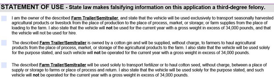

We were told by TWO Ag dealers that you *can* transport a tractor "to or from the 'farm'" on any trailer you wish and it is within the legal use of a "farm trailer" to do so.
We confirmed this with the county when we obtained the registration and plates for our farm trailer.
They did suggest that using a "farm trailer" to haul your cart to the golf course could cause you to mis your t-time and some financial difficulties ;)

Yep, I never meant to question the legality of hauling a tractor, but rather just to point out that hauling "farm equipment" is not clearly spelled out in the documents. The application for farm trailer tags has a section where you check the primary use of the trailer as shown in the attachment. You really have to interpret the language they use to mean hauling farm equipment. I'm sure other documents are clearer, but this document leaves a lot to be desired. I don't know why our laws have to be full of legal jargon and complex interpretations, but that's the way it is and probably keeps lots of lawyers in good paying jobs.;)
