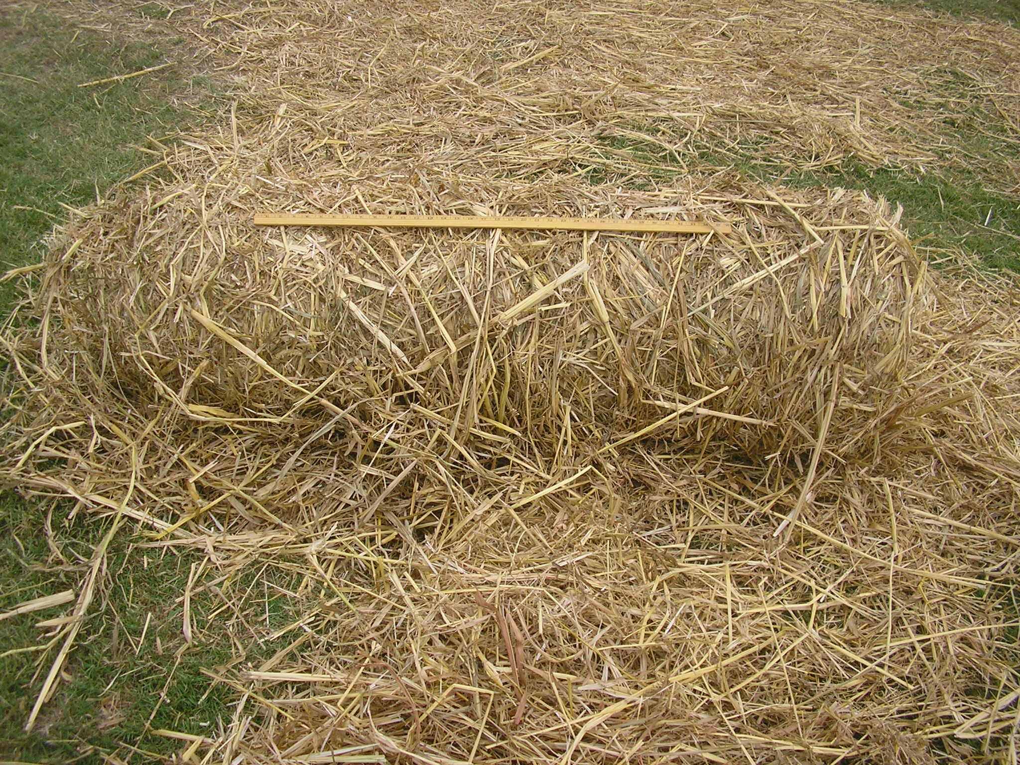

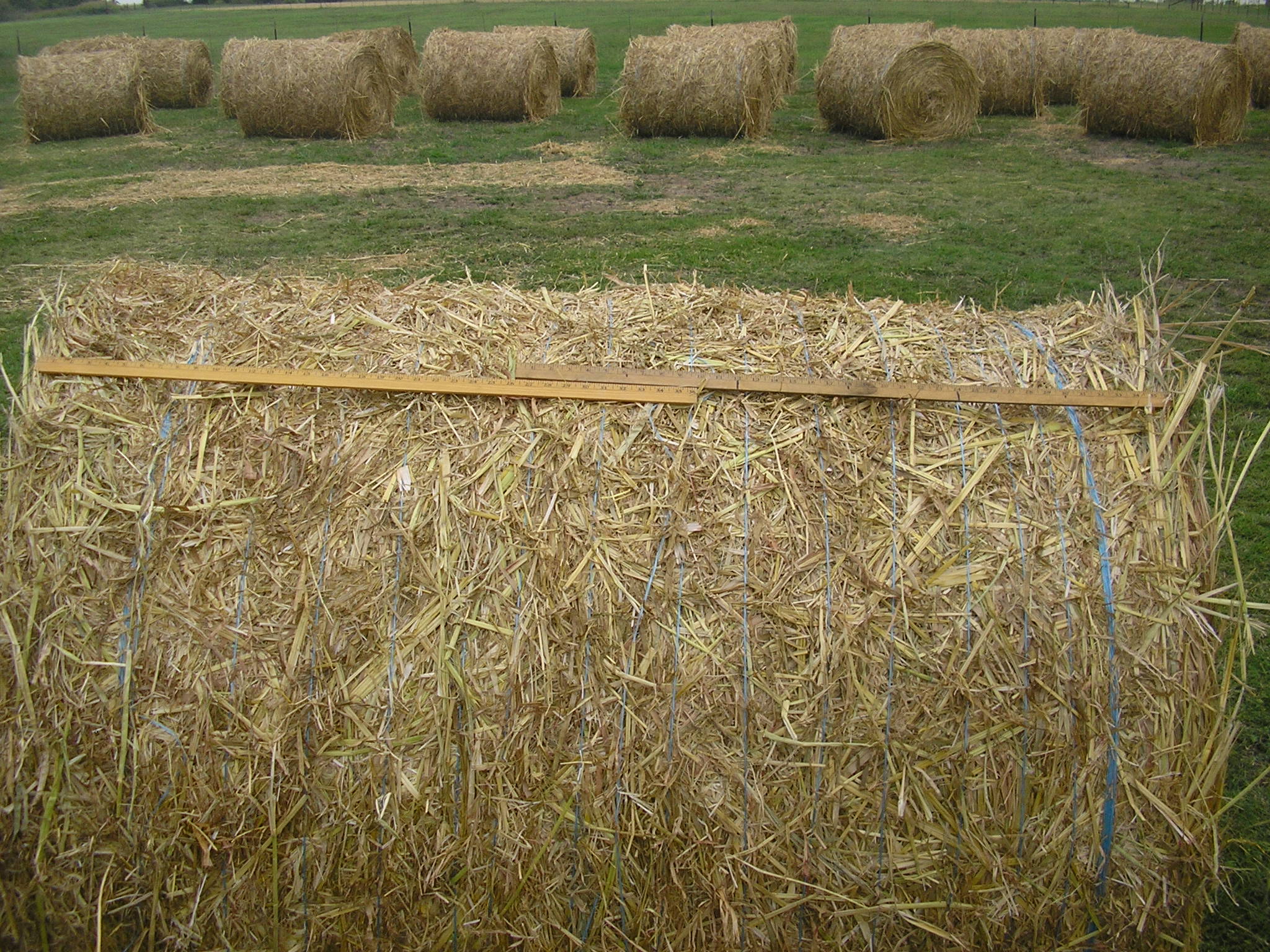

Some pics I shot today. Been baling for the third day now. Got-R-Done. In answer to some of your questions, pics not baloney. Called my buyer today and he came over and looked at it and took it all at my price....I was reasonable and he was thrilled. Chance of rain is 33% for this evening and the humidity supports the claim. Happy camper; hays in.
I realize that this verbal exchange is between the two of us but you know as well as I that there are folks out there that may not participate in the discussions, but none-the-less glean information from them. This is for them too and part of the reason for going to the trouble with pics and all.

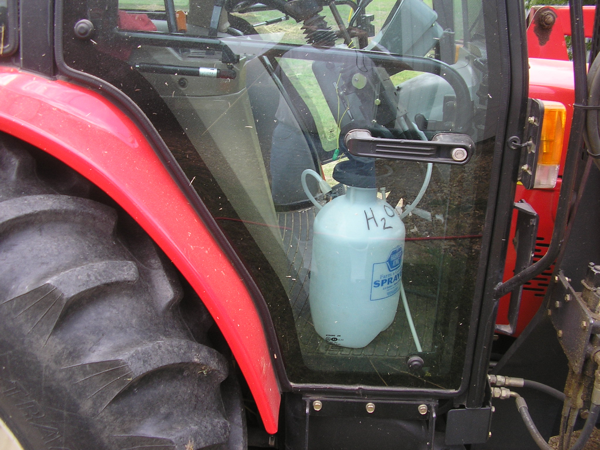

#1 Is my fire extinguisher. Put it in the cab as if the bailer were on fire I didn't want to have to go into the fire to get the extinguisher like you would have to for the ones JD mounts on the front left side of the baler.
#2 Is just showing the innerds of the bail I told you I dumped due to a clog and rolled down a hill.....no tobacco.

#4 and 5 True 4x5 bale dimensions.

I agree the stems appear small for a Sudan type hay. Bales look good and I'm glad you got it sold. And of course I'm glad you made ALL THAT $$$$$$$. On the tobacco hay it will take several weeks for that to appear if in fact it does but I doubt that it will from your description & from viewing your photo's.
   / TexasMark hay???? #19
That's good you were able to get it baled up and sold. It looks better than I expected from following what you had said so far.
