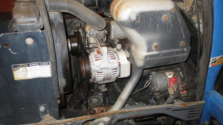

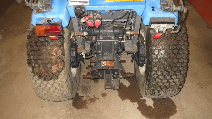

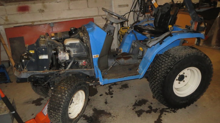

Could not wait till end of the week. .. Machine at home and now first impressions.

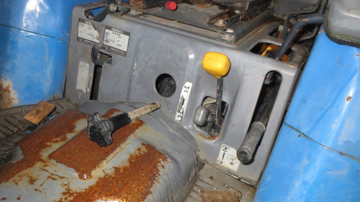

Machine was frozen, but here is some troubleshooting. It did rotate ok. , but I did not tried to start it up very long..
- Rear wheels not turning had to pull it from trailer by ATV right side wheel turns. somehow. feels like gear on all the time...
*** Answer from workshop. wheels not turning if not running (rear wheels solved, but front not as shaft is missing)
-Right front wheel jammed.
-Shaft to front end is missing.
-No any responce on clutch pedal. all seems to be ok, from outside.
-Left front wheel empty (rim needs a bit hammer).
-rear end tool attachment missing. Backhoe has been installed.
Adjusting screw under the seat (frontside) is broken. Dont even know, what it is. In knot it reads something. At least "slow" Can be seen in last photo.
So this is where to start this project.
Manual is very wellcome, if somebody have PDF... :ashamed:
One thing... I can choose from 0 to 4 gear and lever is connected to pedal. Is this machine possible to drive without clutch? Cannot find reverse...
And when i start to look parts, what other brands are same tractor???
Atleast MF1235 should be same machine. Then bolens ? Agco?

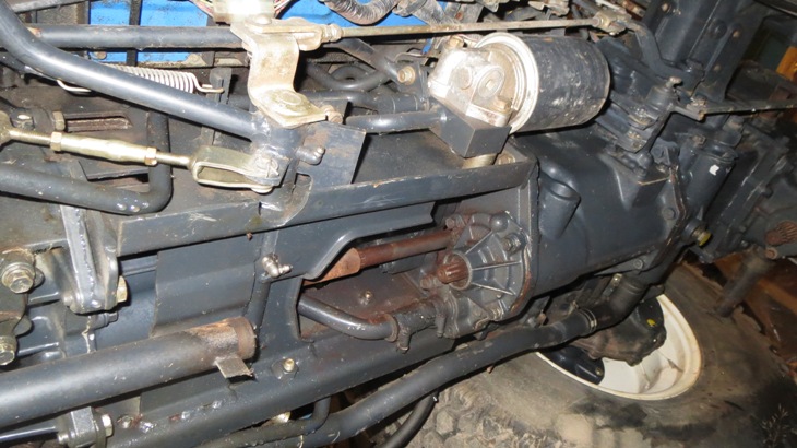

Damage founded.
At clutch. Small bolt missing and it was smashed between flywheel and cluch box. so when pressing pedal, nothing happens.
->New clutch kit+ pressure bearing. new threads for shaft+ hard bolt with clue.
View attachment 348148View attachment 348151
-Clutch shaft From disc to (input gear hst system) -->teeth broken
Shaft from input gear to Hydraulic transmission -->Teeth broken, bearing broken, bores broken and coupling welded earlier.
cover also broken when bearing has wear out.
View attachment 348149View attachment 348153View attachment 348152
HST shaft not good. 20mm damaged. Should work with extended coupling or if its possible to find Hydraulic transmission main shaft.
4wd shaft + couplings missing View attachment 348154
now to market place.... but where to buy these From EU area... Tips???
One question more... 3 point linkage not working. Where it does take power? Not working, because these damages of something else?
Steering pump has pressure. and steering is working. aux. hydraulics reported to be working, but not tested. could this broken adjjust screw cause malfunction of 3 point linkage??

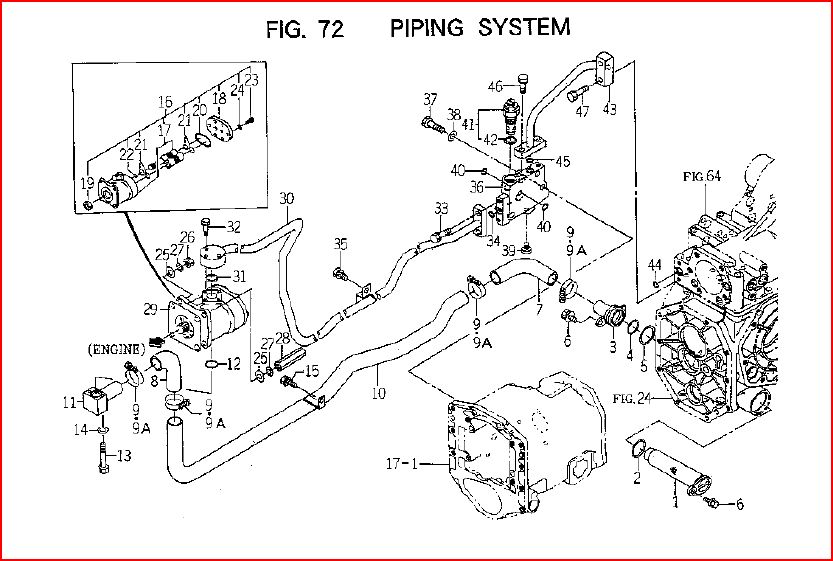

One more problem.... And very hard for me to solve without hydraulic flow charts of this tractor.
Tractor is started and driven back and forward one meter. However, I did broke 2 o-rings.(31 and 34 in explosion pic) from both end of working pressure metal pipe . Both were old and connections has been open but..
Engine sounds that it runs normally and then rpm gets lower.. and same again (short periot when it sounds that something is against smooth running.. and then some seconds normal. like waving. even when I press clutch that whole power train is disconnected. --> only thing what can try to stall engine is hydraulic pump taking too much power. Is there some safety system, what bypass oilflow, if there is something preventing free flow???
I try to explain.

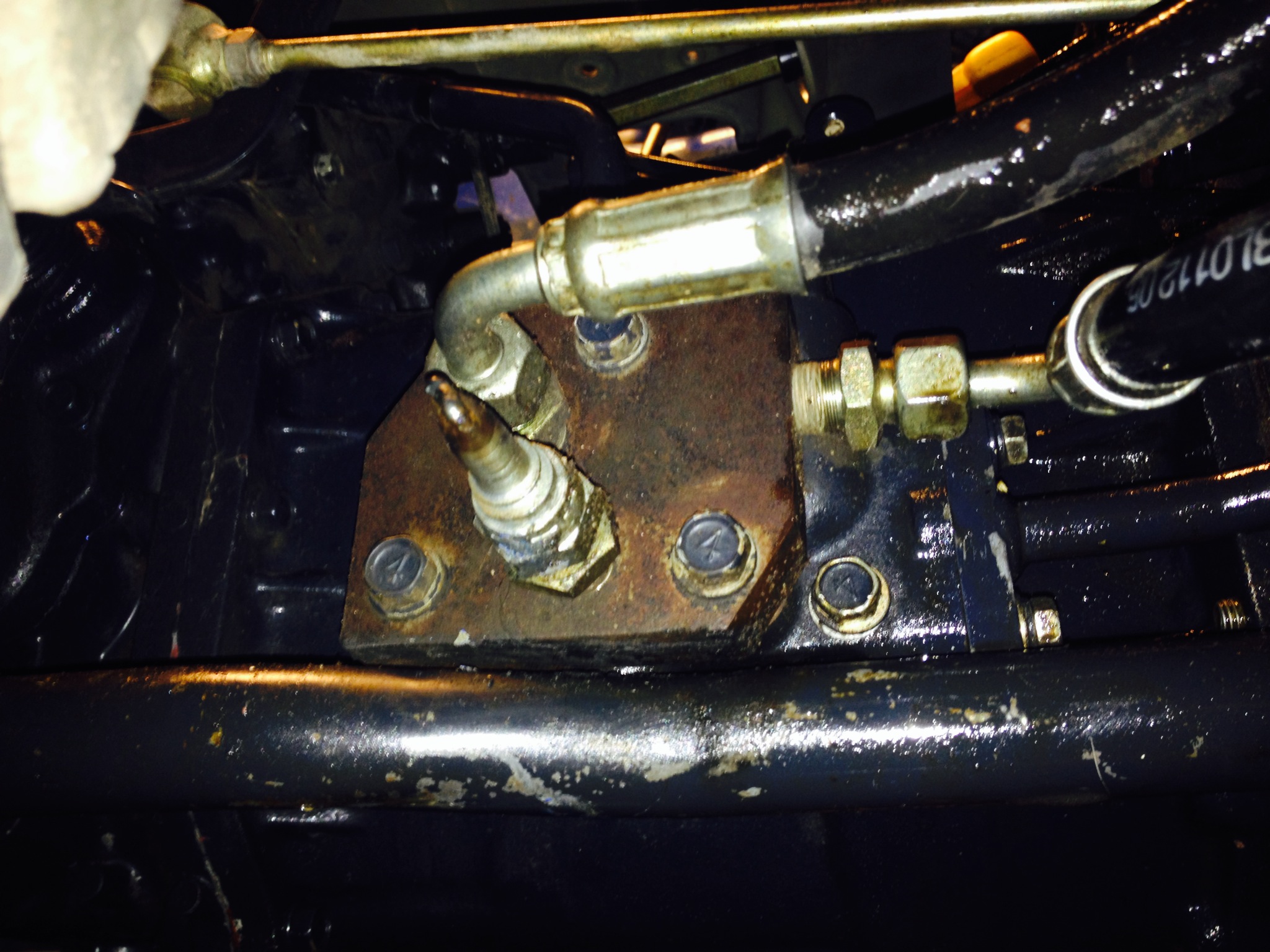

I dont know, but I believe that this tractor has had front loader and backhoe earlier. on right site is hydraulic block (explosion picture number 36). There is other block connected side by side with bolts. (Photo). I think that is for front loader. On that block one pipe is plugged and welded and two connected together with hose.
Before I go to buy plugs and remove that other block I would like to ask question...
Could it be that for front loader (or what ever that block is used for... )there is 2 output and one input... and 2 outputs is now connected with hose??? I think loader has been removed after tractor has been broken, so it is possible that somebody has connect hoses just to keep oils in. Now it try to push full pressure and there is no place for oil to flow? How to test? Pressurized air? or just remove block and plug holes? is there one or two? have to look from explosion pictures... If these blocs are connected like "serial" I understand bit if blocks are side by side, what can cause problems in circulation?
3-point linkage is not working either... no any feel.. can lift it very easily from links.. maybe something is broken also on that or could it be bacause of this hydraulic issue? Atleast pressure pipe continues from that expanded block to block, where is 3 point hitch linkage piston located.
/ TF330 Hydrostatic Problem. Not moving.

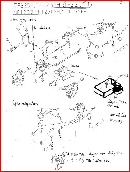

I think... Maybe... we solved the problem in our coffee place at work.
in some explosion pictures can be seen that if there is no extra block, there is cover where is machined area. --> Oil flows from lower (now welded pipe, which I assume to be pressure out as it is same level with oil pipe from pump) to higher and then to rear end. like 3 point hitch.
Now loop is closed and I broke O-rings 2 times before relief valve opens. (fig 72 above, part 41) Now when o-rings are bit better tractor waves together with relief valve operation..(Increase the pressure, ---> decrease rpm---> relief valve opens ---> pressure down and rpm up.
--> So if I move welded pipe to that what is going right on photo and use hose to make loop between lower (now welded) and higher it should work. Oil should have free flow to rear end.
I try to do that tonight.
