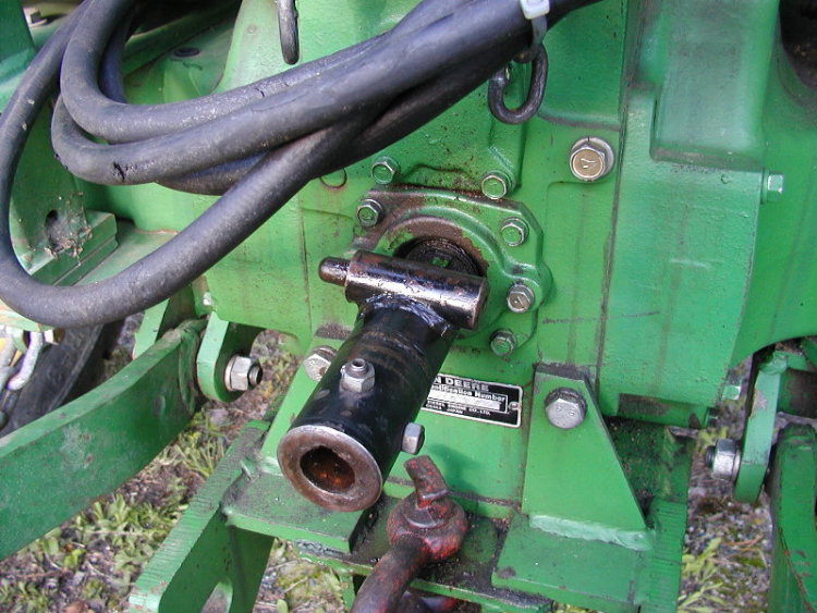

just outa curiosity.....the lil knob that releases the adaptor from the shaft, I couldnt tell from reading all the threads, is it still in there? Not in there? was just wondering....IF it was still in there, rotate it with a pair of pliers?maybe it is a 1 side flat, 1 side round locking shaft? I dunno, just an idea.If it is not in yet, is there a piece of the spring in there yet? If you knocked it out with a hammer/punch, a piece coulda got broken off and stuck in there?

All that has been removed.............no pins......no springs....that we know of

mark: spray the adapter with wd40, or such, spray it in every opening u can find. then after it has a chance to work for a bit, as u are prying, tap it robustly with a hammer. if it has not been off in a long time it may have formed a coat of rust, which can seem like a weld joint, hope u get it off.

I'm still thinking debris is in the adapter.
Try placing a round magnet in the hole where the pin was and move the adapter back and forth / side to side. This might allow the debris (assuming it's metal shavings) to dislodge and attach to the magnet.
Someone else mentioned a feeler gauge (very thin metal strip). Insert between the adapter and spline to feel for debris and/or move debris.

If the pump ever wobbled around on the PTO shaft during use, the softer steel splines of the adapter may have mushroomed and are now wedging against the PTO shaft. Look at the bright side, when my first one did this it took out the pump bearings and cracked the pump case.

I have a PTO adapter that recently came loose. In the process of fixing it I discovered that although loose I could not remove it. First I discover a set screw and thought I was home free....think again, 2nd I discovered an opposing set screw on the other side of the adapter once again home free...oh oh still won't come off, next in playing with it I determined that the short internal key was catching on one end. I used a skinny punch to go through the set screw hole that was above the key and reset the key by tapping with hammer. Adapter slid off....Geez why did I take it off?? I put it back together and tightened it up. This adapter was on a PTO pump shaft. Maybe something similar is hanging?

Nope !! no progress, but then I haven't had any time to spend on it. I re-installed the backhoe, so I could move it out of my lawn mowing area, set it out of the way, un-attached it and the adapter still sits on the tractor.
Where a,s I have no other 3PTH implements, there is no reall hurry or need at the moment to get it off. So hopefully I will get back to it soon.
