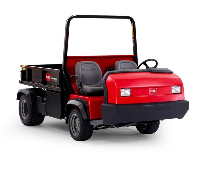

Personally, if I were spreading mulch someplace where you could fit a 50 horsepower tractor in, I would want something like a Toro Workman HD (formerly the Workman 3000 series).
Much lower ground pressure and it will move a LOT of mulch (especially if you put extensions on the walls).
Used they are available for $3000-5000.
