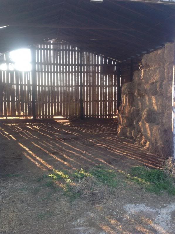

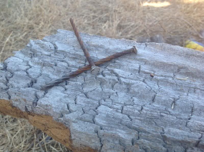

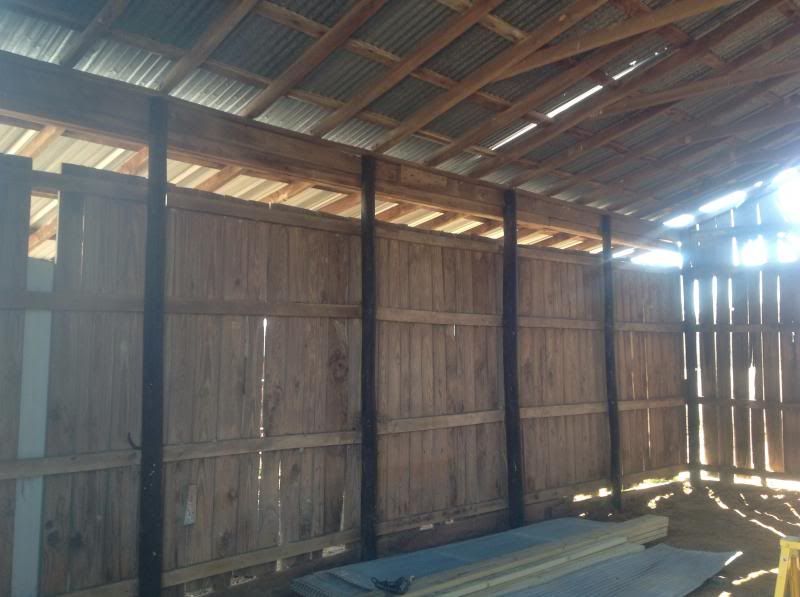

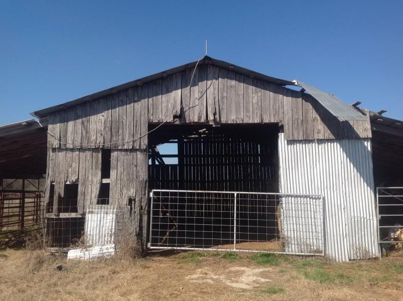

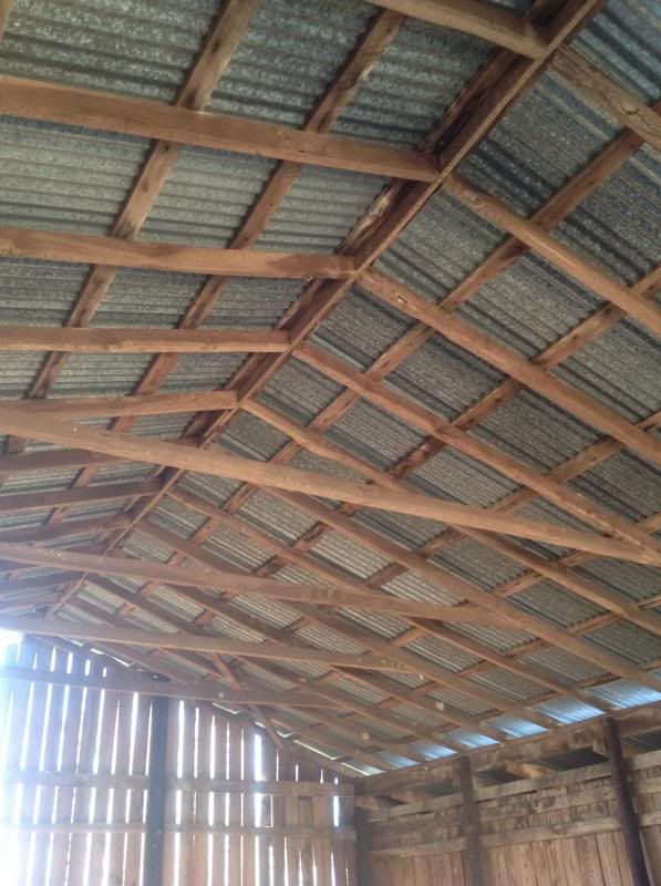

Built some time around 1970 (the year I was born) by the farm's previous owners, and located approximately 100 yds south east of the house, the barn initially consisted of a stand alone rectangular structure with its opening facing due east. Although it was only 30 ft long, 26ft wide and stood 20 ft at the roof peak, it seemed throughout my youth to rival the Roman Colosseum in size. It was constructed in typical pole barn fashion, with dark black 12" diameter creosote poles at each corner and smaller 8" diameter poles spaced 6 ft apart along each side wall, as well as the front and rear. Four rows of full dimension 2x4s were notched into the poles horizontally and attached using long steel nails with a hatched head pattern and prominent spiral grooves along the entirety of the shank. These heavy boards composed the general skeleton onto which the exterior walls were nailed. Rough-cut 1x8 and 1x10 oak planks oriented vertically composed these 4 walls. I suspect that initially the planks were fitted tightly alongside one another to keep out the rain, but most certainly succumbed to the inevitable shrinkage common to all "green" lumber. I say this because there have been 1/2 inch gaps between the planks as far back as I can remember. Its roof was constructed of the heavy corrugated ( currently unavailable) sheet iron of yesteryear. Even today, I regularly hear farmers and ranchers complaining about the shortcomings of modern tin. That sheet iron was attached to oak lathing with lead headed nails, many of which I later pulled off to use as sling shot ammunition, or simply to roll down a groove in the roof's corrugations. Sitting defiantly atop the roof peak were 3 aluminum lightning rods, each connected via a cable of braided aluminum which ran east along the ridge cap, down the east eve southward, and ultimately to a copper rod driven deep into the ground alongside the barn's southeast corner.

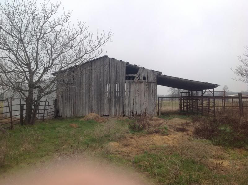

After purchasing the farm in 1973, Daddy added north and south wings to the barn, nearly doubling its capacity. The rafters used in the construction of the north lean-to addition were long, thin persimmon trees. Cedar trees were used on the south addition. When asked years later why he used persimmon trees for rafters, Daddy replied "Because when I built those add-ons I didn't have enough money to buy a hamburger when I wanted one!" On top of the persimmon and cedar rafters, old 1x8 boards were used as lathing. They were undoubtably recycled from a previous structure, because I can remember that some of them were coated with a layer of cracking white paint, and some were tongue and groove. I suspect that the persimmon rafters started out straight, but ever since I can remember, they sagged prominently under the weight of the lathing and sheet iron. The North wing was enclosed to the north and west, and used as storage for feed, wire, T-posts, and what few tools daddy owned. The south wing was left open, and generally reserved for a well used tractor, whose exact make and model changed several times throughout my childhood and young adult life. It was here I learned that a small puff of ether could be sprayed into the air intake of an unwilling tractor to help prompt its cranking. It was here that I learned how to use a set of jumper cables to jump start a cold or dying battery, and to use a farm jack and lug wrench to remove a flat tractor tire.

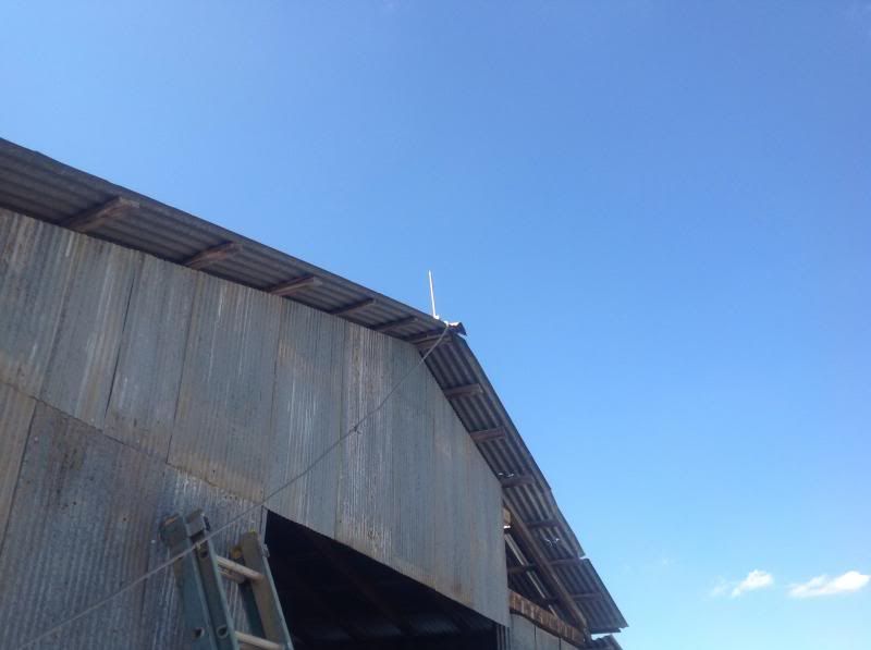

This barn that once stood proud and strong has fallen into general disrepair over the past decade, due in part to my father's failing health, nonuse, and time constraints. The persistent wind has loosened several pieces of the roof's tin, and constant exposure to sun and rain has finally broken the will of the exposed lumber. This past week, I set in motion a restoration project so they the barn might have a chance to give my children even a small portion of what it has given me. If I allow myself the luxury of being honest, I must admit that this restoration project is as much FOR me as it is for the barn that built me!

Nice story. Sounds like you had an amazing place to grow up. Is this where you live now?
From the pictures, the framing and poles look to be in great shape. Does any water get in from runoff or does the ground slope away?
What's the plan? New metal roof and wood siding? Muellers has the best metal and they are very good to work with. For siding, I like Hardie better then anything else. Real wood will always have the shortest lifespan and highest maintenance. Install OSB and wrap it, or Zip System, then the Hardie and once you paint it, you wont have to do anything else to it for decades.
