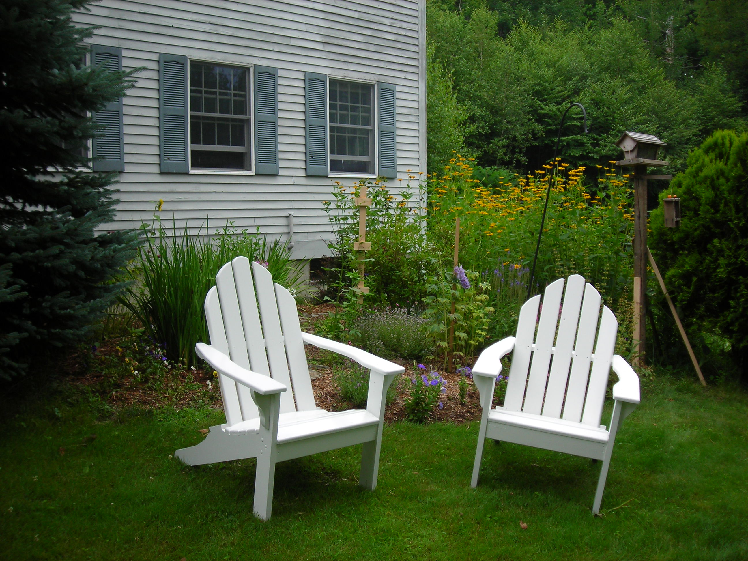

Nice table Scotty! I guess ray pattern has something to do with the grain, Right? Woodworkers do have a way about them. All I seem to find time to do is make a few chairs to sit in....

BTW, Wayne nice Adirondack chairs with the right beverage they can be quite comfy !

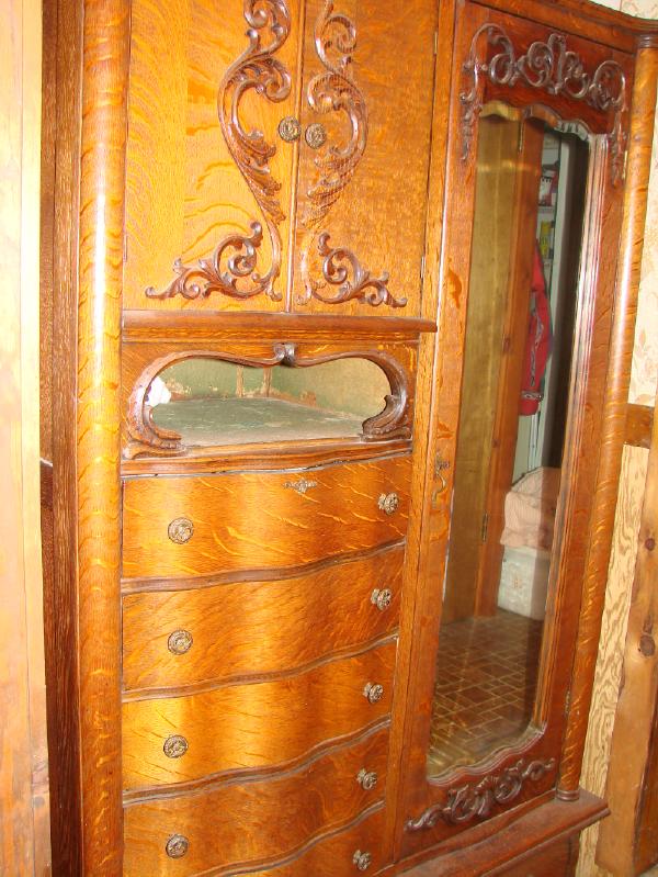

"Ray flake" can be found in lots of wood species (look up lacewood some time) one of the easy ways to make sure it shows through a finish is to wipe the wood down with linseed oil a couple days before putting on your finish coat. This is an easy way to make most figure "pop", no matter what the species. After the oil has a couple days to cure, you can coat with polyurethane and still have the look.
