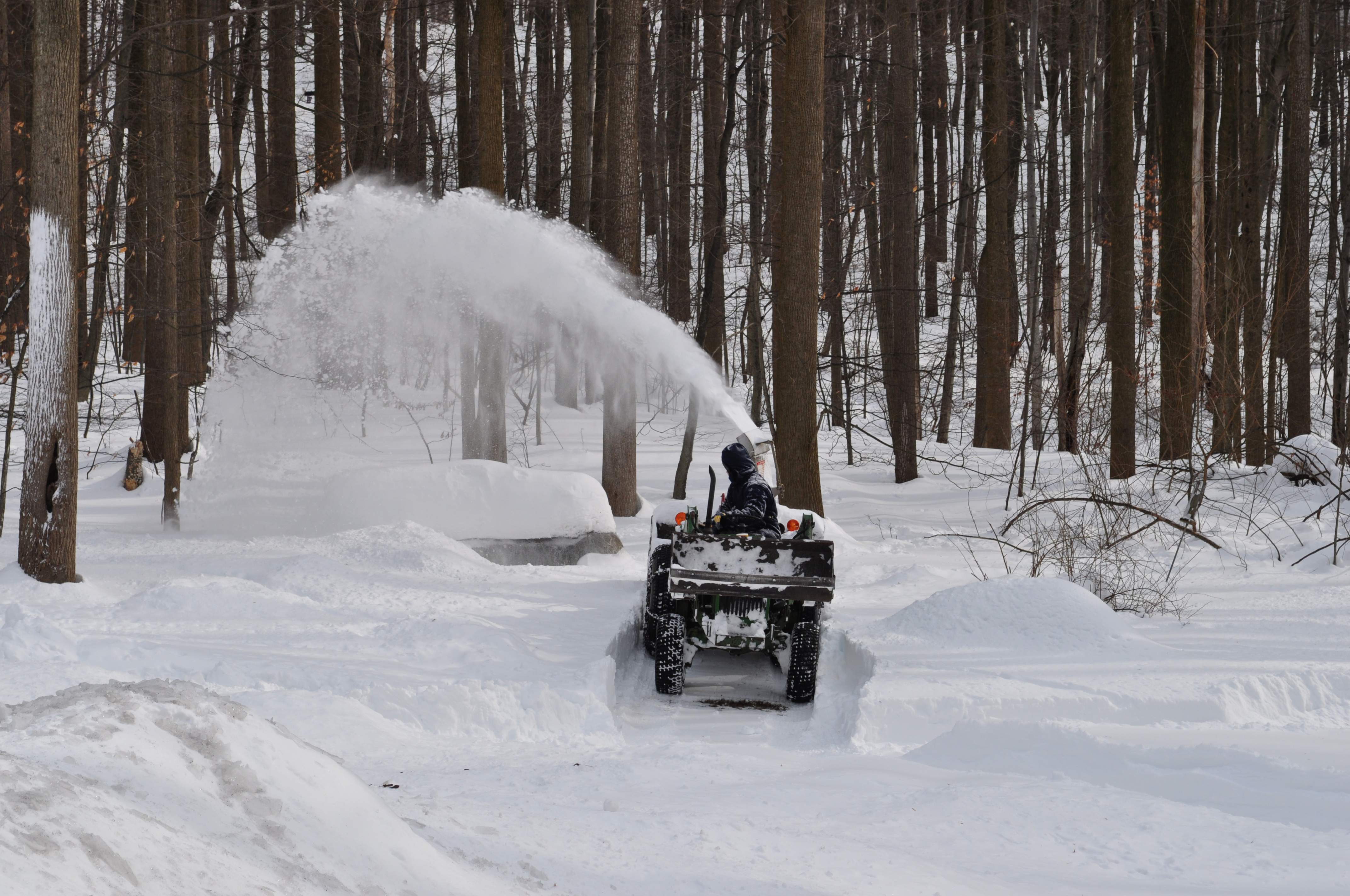

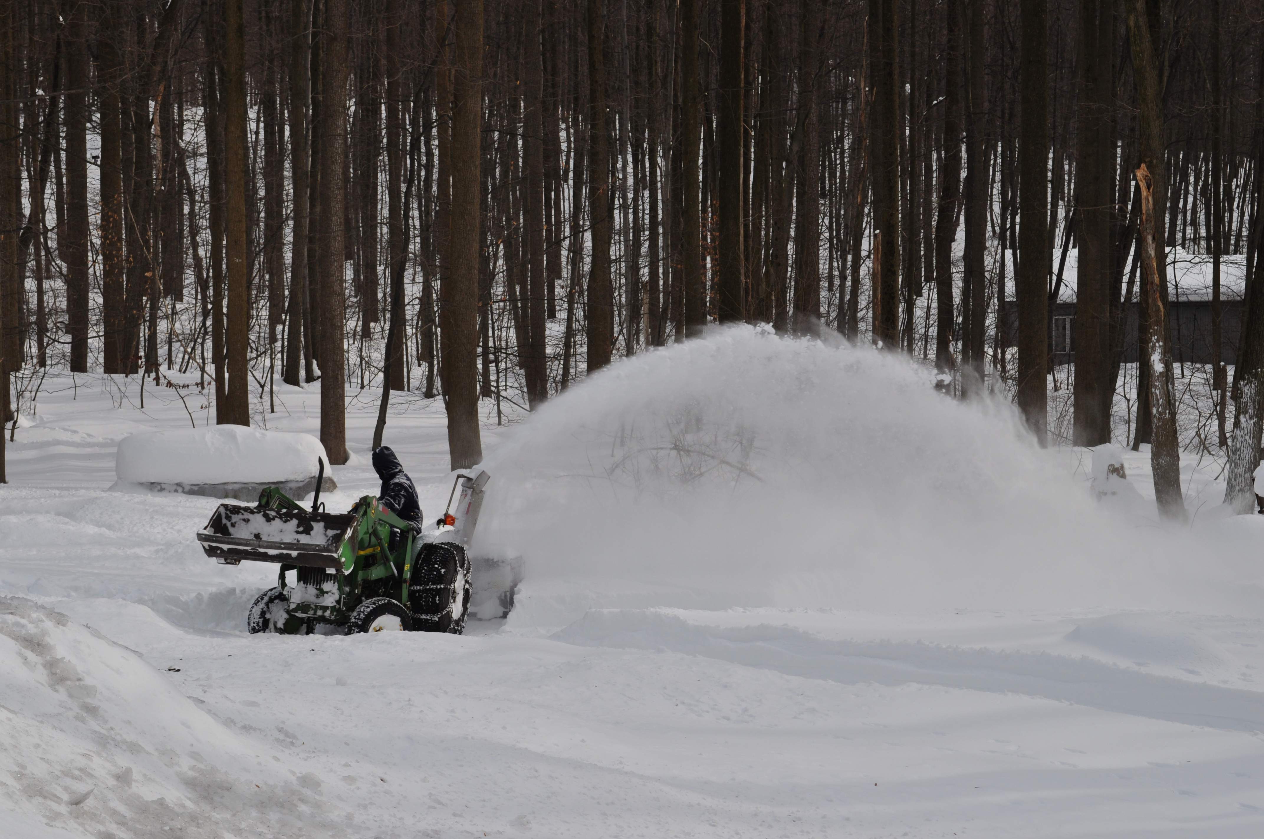

   / The blower must be the right size (that's what he said) #16
I had a 60" rear facing blower on a JD 750 with 18 pto HP and manual transmission. Not once did I have a problem due to lack of HP or felt a smaller blower was needed. The few extra inches in width will aid clearance when turning.
