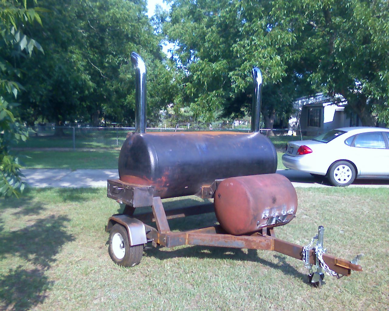

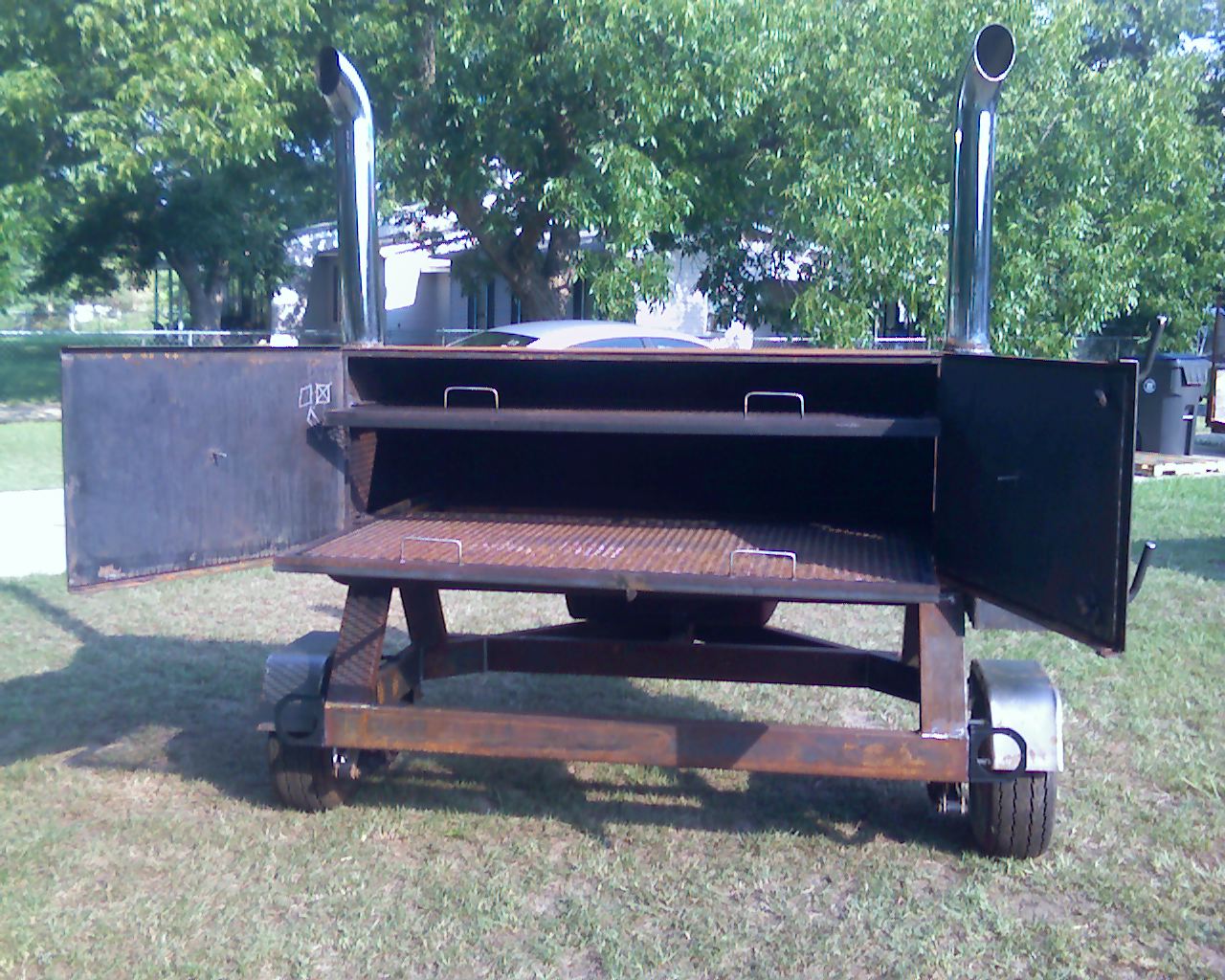

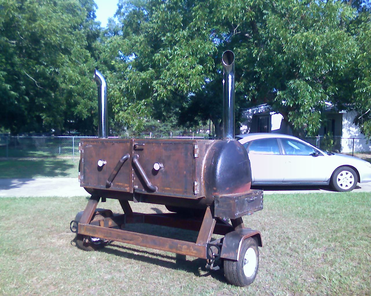

Goodmorning TBN!!
Here's a little project I've been working on a lot here lately, its another custom BBQ. It'll be the third one I've made, and I feel like I'm making good progress on it.
I bought a huge boiler tank on Craigslist for $100 and brought it home... Built it a stand, made a firebox from 1/4" plate, welded up some industrial smoke-stacks, and I've started putting it all together...
Anyway, I just wanted to share. The videos here tell it better than I could in words... Hope y'all like it!! Like I said, I'm *ALMOST* done, and I'll keep this thread updated as things progress... Its been a really enjoyable build so far. Anyway, here are a few videos:

Almost there!! I've logged over 50 hours on this build so far... Its been a TON of work, but I really hope you guys enjoy it. I'll have more here soon. Have a nice week everyone! :)

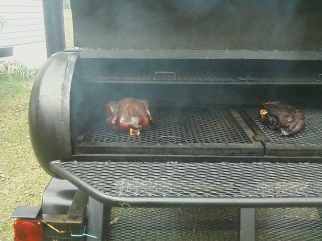

One thing about the reverse flow smoker/cookers...They consume a lot of wood before they get hot enough to safely cook. I've built my share of smokers, and the reverse flow do a good job, but I've had to convert some too from reverse flow to another style because of this issue (plus the plate burns out).
   / The "Burninator" Reverse-Flow BBQ/Smoker Build Thread
Yeah, so I've been told. Thing is, Reverse-Flow is ALL the RAGE around here.... I've made two that werent RF, and when I went to sell them I had multiple people say they "needed" reverse flow, or that was what they really wanted. I converted the second one to RF...
So, now thats what I build :)
   / The "Burninator" Reverse-Flow BBQ/Smoker Build Thread #9
There are other alternatives that work just as well and heat just as evenly...like these.
They do have a baffle plate in them that "spreads" the heat and smoke but does not cover the full bottom. Think of the way a muffler works.

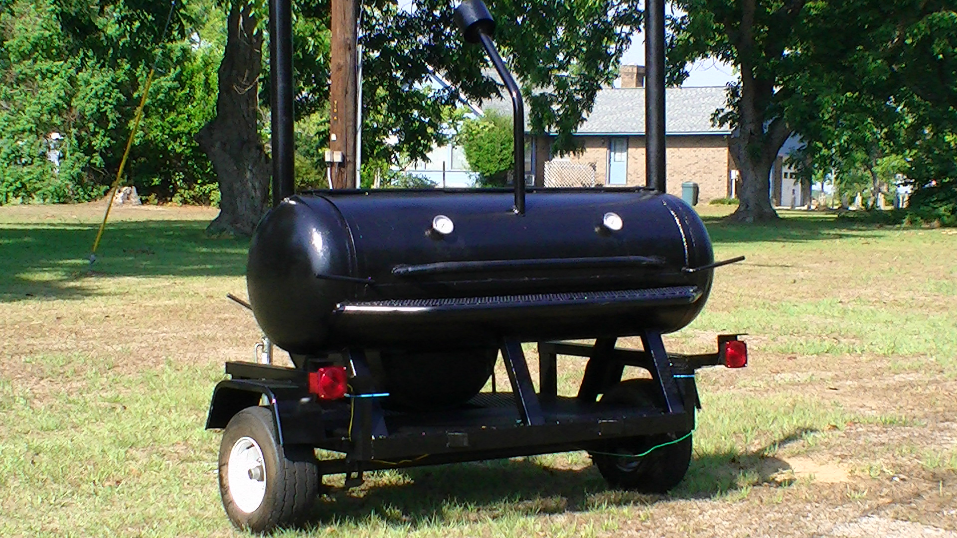

Goooodafternoon, everyone!!
Heres the next part of the build series, I spent some time on this project, and accomplished a lot in the video. I finally feel like it's ALMOST done. Hope y'all enjoy the video...
And have a happy new year :)
