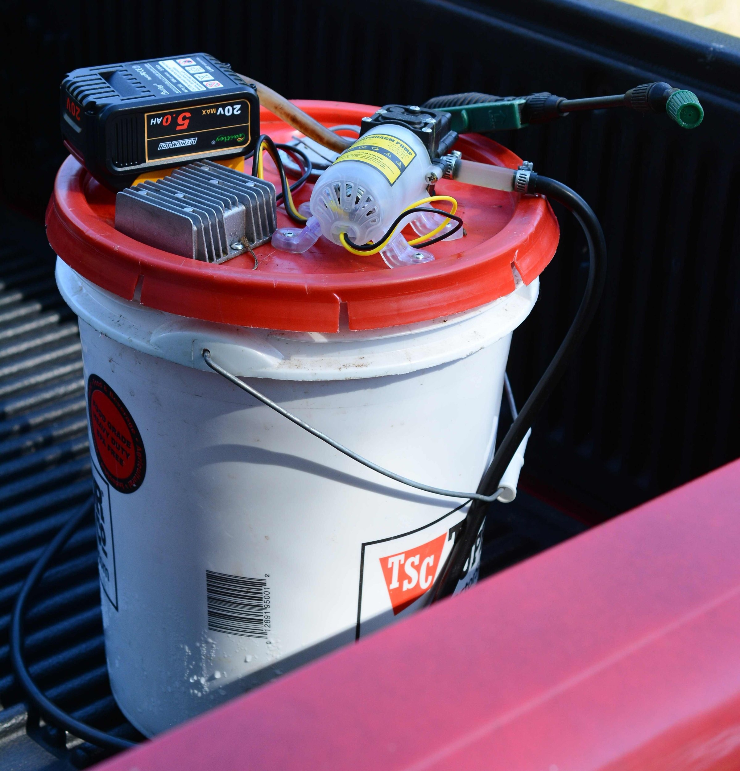

With the increasing cost of herbicides and needing to spray kudzu in some places where it is safer to reach it on foot, I put this electric sprayer together last year. I waited to post anything until I felt like it was actually useful.
The pump is just a $20 pump from Amazon powered by a 20v power tool battery that is stepped down to 12v by a converter, also from Amazon. The spray wand and hoses were taken from pump tank sprayers I already had.
The issue I was having with pump tank sprayers was they didn't quite put out the volume I wanted and required frequent pumping by hand. The electric sprayer does a better job in both respects. The sprayer is also good for spot spraying from the tractor seat and can be carried on foot to spots that I can't reach with the tractor. When full, it's a bit heavy to carry. So filling to 1/2 capacity might be a good plan when most of the spraying will be done on foot.
