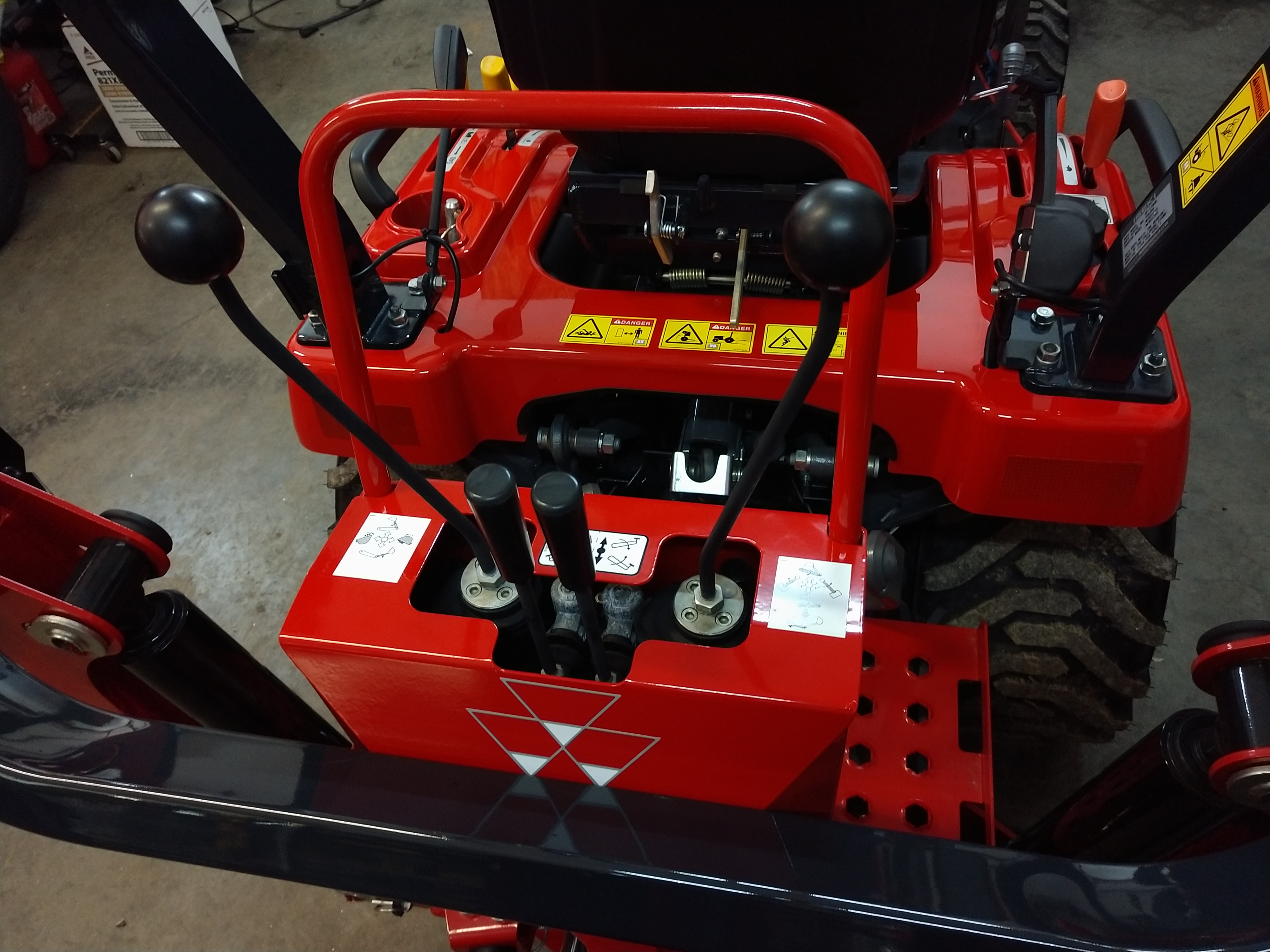

Definitely a better guard for the hydro filter and mid PTO, but still no protection for the HST fan blades.
Why do they not do that?
   / The Changes in the GC1700s in 2018 - steering, seat, couplers - an open house
#12
Cold,
1st off, the Massey GC fans are much better protected than the Kubota BX units. In addition if one needs repair it is a fraction of the cost to repair compared to the BX line because it is far less labor needs and much less difficulty. .
As to why they don't protect them more. . . If they had more protection, it would make much greater buildup of grass or leaves and result in failure or hydro overheating.
If protection is a big need, then an under shield for the back would give you that without creating buildup around the fan area. I believe Bro Tek makes them at a moderate price. For all the GC models.
   / The Changes in the GC1700s in 2018 - steering, seat, couplers - an open house #13
The backhoe joysticks & steel cover for the valve manifold is different than my old one also. I really hope the valves are the same since the old ones worked nice.

That is definately an upgraded guard. Is this unique to the TLBs only or do the non backhoe versions have this too?
