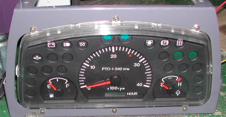

The other day I noticed for the first time there are dash light indicators on the dash panel for what gear range the tactor is in. H-M-L and P just above the RPM meter . These lights never come on, are they supposed to be working? It would be nice if they did.
What the story behind these indicator lights? :confused2:

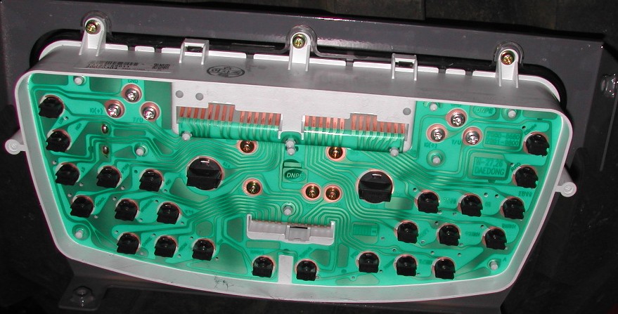

There are a bunch of unconnected lights in the panel. Here is a photo
of the back of my CK30 panel. The extra lights all have bulbs, but the
wires on the harness go nowhere. I tried illuminating some of the lamps,
but the symbols made little sense to me. Some are for other markets,
I would assume.
My Kioti does not have the switch that the DK has for ranges, KCO.

I looked at the shop manual electrical diagrams and the H M L indicators are only being used on the hydrostatic models. I noticed the dash lights when I bought my DK40SE shuttle shift and wondered the same thing , so I looked at my shop manual .
DK40SE SS
   / The CK35 Dash Lights
I’m going to take a closer look this weekend to see if the switch is there for the range shifter.
I think the lights are wired to work on the DK models only.
