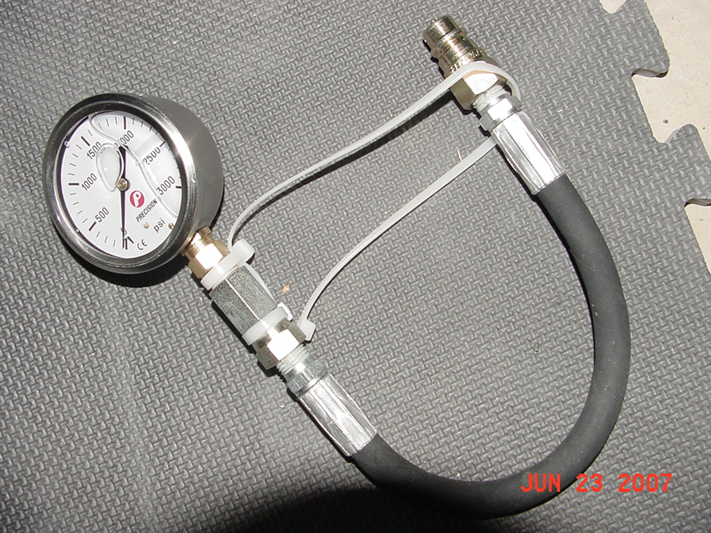

I wish I would have checked mine before adding shims. I have been curious to, but was needing the tractor so did not take the time.
When I did add shims I hooked up a pressure gauge . I purchased 2 packs of shims, adding 1 pack + the second to the thinnest of the other. Working the valve with the engine running at 2000 RPM caused the needle to swing up to 2700 psi then quickly drop to 2400 psi where it would stay. did not take pictures of gauge on tractor but here it is on table.

Thanks for the post on the guage.
I was wondering about that guage setup. I have bought the shims for my JD790, but have not yet got the guage or fittings to hook it up (been hoping to borrow somebody's). Do you need to have a flow-though setup as shown in your pic? Or, could you simply have a "dead-end" gauge and then operate the valve to read the pressure?

Deadheading into the gauge is fine, there is no need to Tee it into the system. Here is a picture of mine.

I was at TSC the other day looking for a guage. They had none, but the associate i was talking to said a guage meant for gas (like on a welding tank) would work properly on hydraulics. Can anyone confirm or deny this?

I only used fittings because 1. this would only need to be done once 2. they were cheap 3. it left me with a set of couplers if I should ever need them. The pressure reading was taken deadhead. I did not hook the loader up when doing this. My wife operated the valve while I watched the gauge. Purchased the gauge and fittings from Burden Sales Surplus Center on line, then got the couplers at JD.
I see no reason why it would not work-you just need a 0-3000 psi gauge...but finding adapters to get it hooked up wouldn't be worth the trouble when a new gauge is under $20.00.

LOL.....No problem. My local farm store has the guage for about 14 bucks and has most of the fittings...but they don't carry the small Pioneer couplers. I just need to buy another coupler and get off dead center on this pretty soon. Need to make a trip to the JD store.
I want to find out the pressures before and after....as others have suggested.
