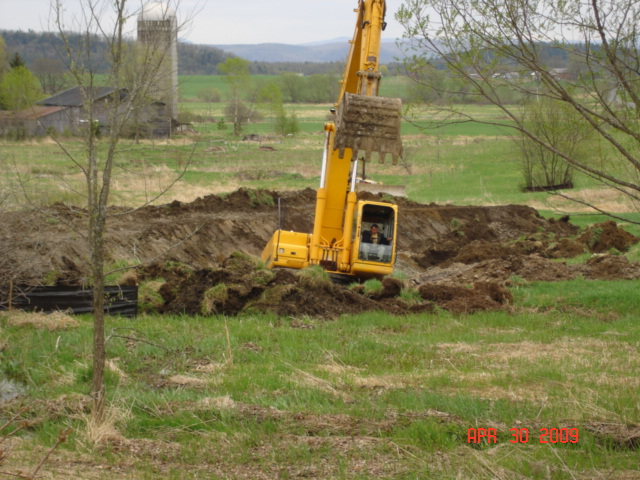

The trout pond project is underway. Other than having the transporter back out a 5 o'clock Wednesday, and scrambling to find transport for a 38 Ton machine after COB for Thursday morning....everthing went swimmingly. :eek:
My friend with the excavator, Nicola, worked so fast it was hard to keep up with the camera. He moved about 3000cy, about half of it twice, in about 6hours total. My friend Shawn, who was pushing with the D4, was buried by the volume.
Enough narrative....here's some pics!

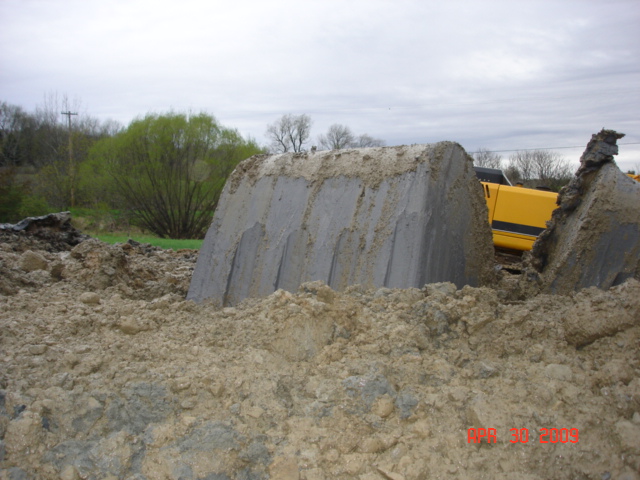

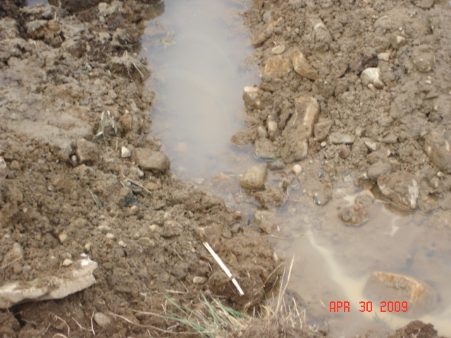

Still pics from Thursday. We hit several springs. At about 12 feet, we hit the blue clay left by the Lake Albany which covered the area after glacial retreat. We couldn't get the machine own in there, because as Nick says "you may as'a well cover her up". The suction is unbelievable. We excavated about 2' of it out and covered it with the overlying gravel.

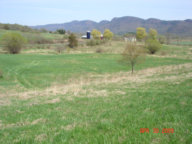

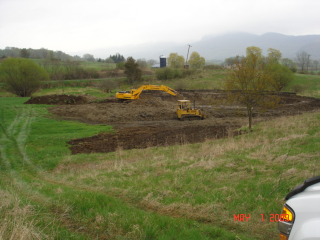

Here is this morning's progress. As you can see, Nicola is an animal. He had to attend a party, and he left at around 11:30. He got way ahead of Shawn, who is no slouch himself. It doesn't help that the gravel/clay is juicy though. It pushes easy, but doen't stay in front of the blade too well.
One pic shows the deeper end - about 14', and the other end shows the shallow end - about 6 so far. The shallow end will be tapered up to the surface after I get some of that slop out of the way. Yes, I get to play big-shot on the Hyundai!
We also may enlarge the deeper section before we finish. The blue clay limited our depth, but 14' will be fine.

One either provides a surface water source (and discharge) and seals the bottom with clay to prevent infiltration, or one digs one in areas of high groundwater elevation, where permability is a benefit. In doing the latter, I am basically daylighting the groundwater which has flowed down the mountain atop bedrock by removing the gravel it has saturated. As you can see in the pics, the groundwater is perched upon that thick (probably about 6') blue clay layer. If we punched through that, the water may go down the drain! The gravel is confined between blue clay on the bottom, and clayey topsoil.
The water will eventually be clear...and COLD, and is going to be a swimmable pond.

First, the clay is the water-confining layer. Without it, we could lose the ability to hold water in the pond. Second, it's at least six feet thick and really soft. It could be much thicker. You can lose that 38 ton machine in it. Even several feet of overburden will not help that much, because it's wet. We're not taking the chance to lose a $250,000 machine.
That clay will not stop that machine - not much would. See the pic. We removed about 2' of it because we could reach that far. Then he put a foot of gravel over the top so the clay will be less likely to suspend in the water column.
