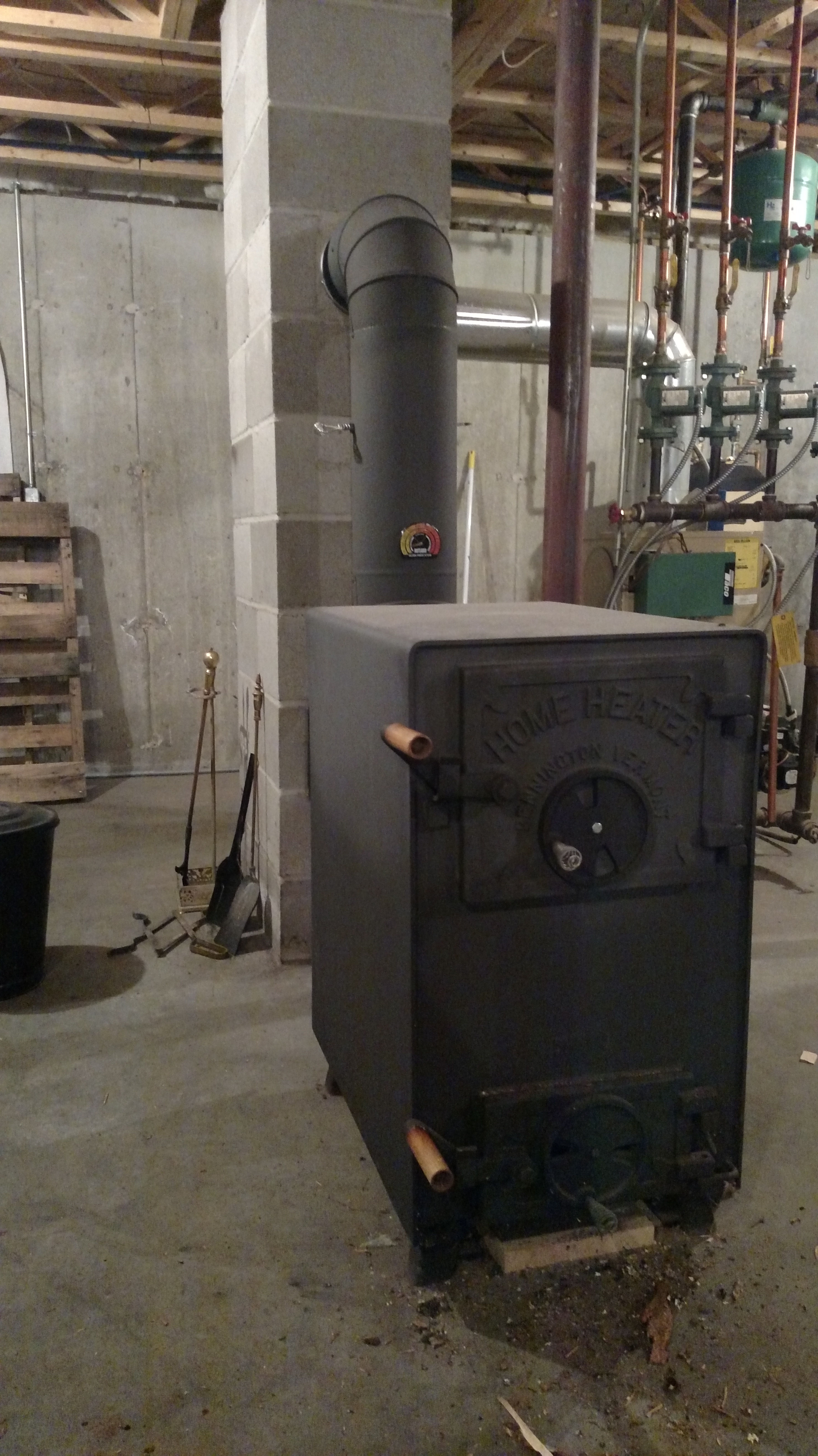

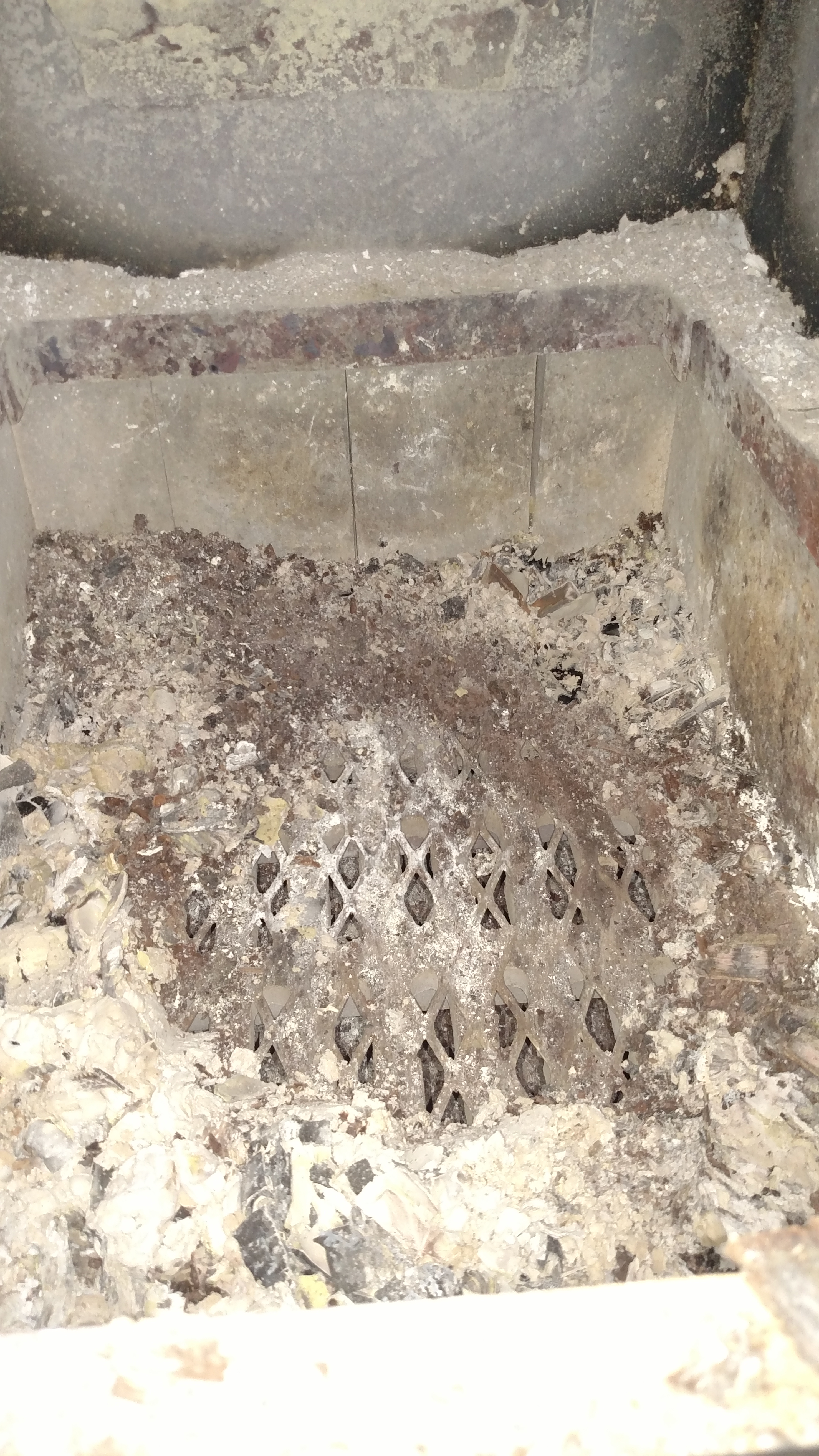

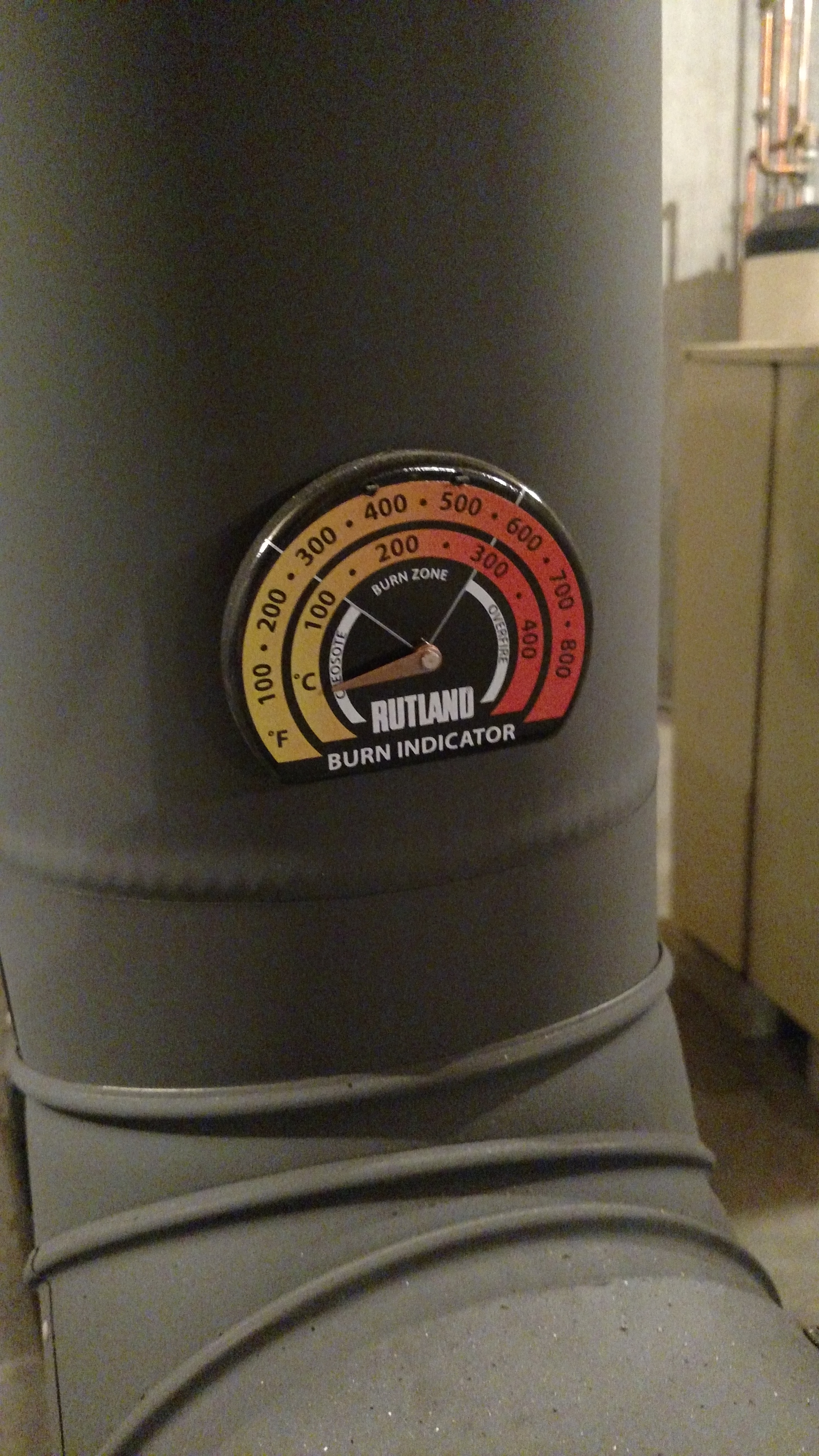

I generally try to run 550 to 600 deg on the outside of the stove pipe about 6-8" from the top of the stove. Here is my grate. IMG_20160229_214532260.jpg

I bought that stuff long time ago, went to a steel shop and asked for screen like stuff made of steel with diamond shape holes, know wonder he didn't know what I talking about. But you might have something there, I'll look into that see how thick it comes, might be able double layer it.
