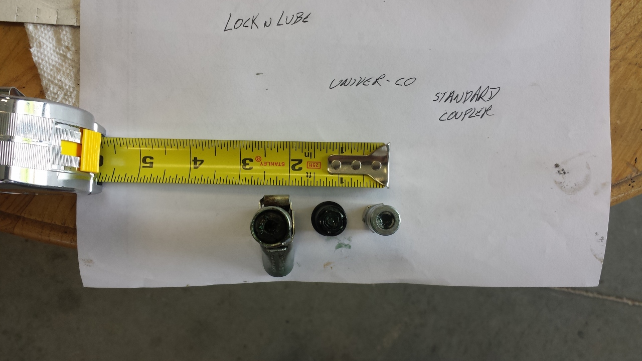

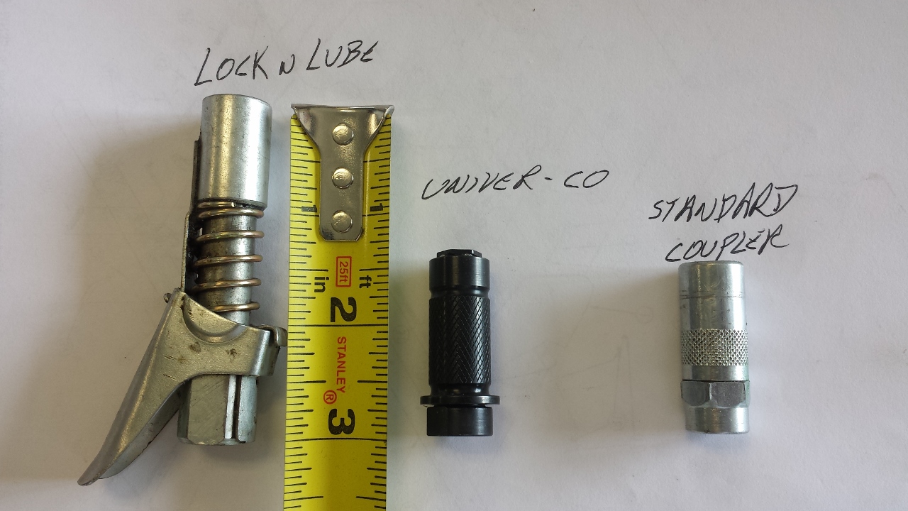

Year ago or so I bought a LocknLube coupler. I used it for a bit and then put it on the shelf. Recently I heard of Univer-Co's version so ordered one. Here's some pics and opinions.
First thing noticed is the bulkiness differences. Here's a couple pics.

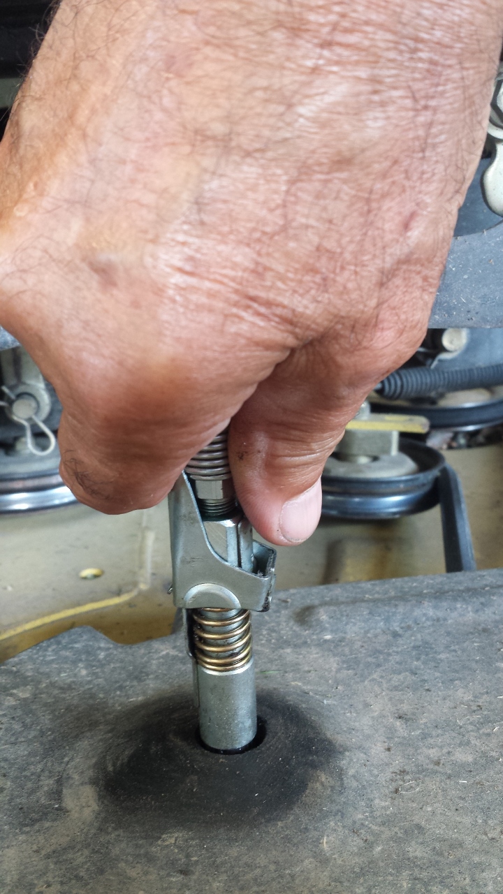

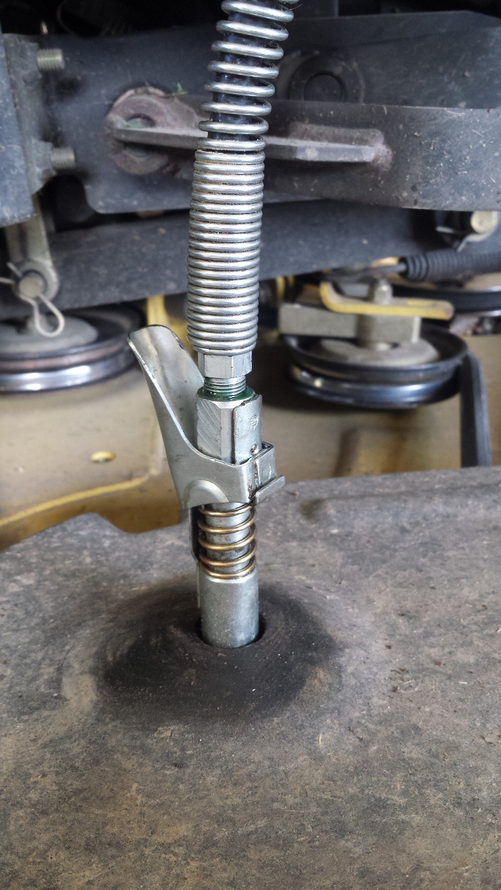

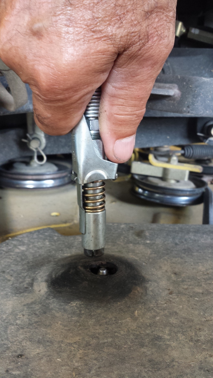

The LocknLube is operated by a lever on the side. Normal position is closed. To attach the LnL to a Zerk you have to pull the lever which slides the outer collar back allowing the locking jaws to open and go over the zerk. Release the handle and it's locked on. Pump grease. Then again pull the handle to release the locking jaws and remove the coupler from the Zerk.

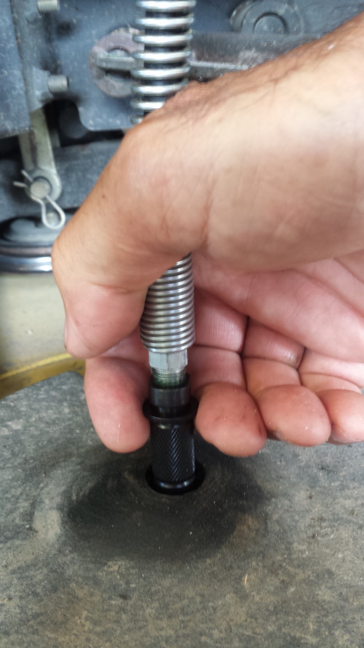

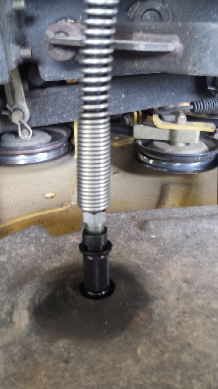

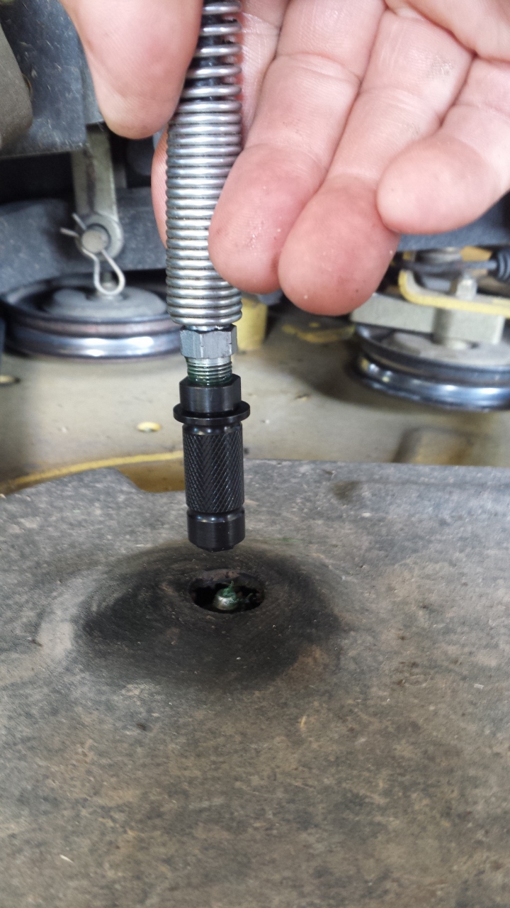

The Univer-Co coupler also uses locking jaws. But they are controlled by a sliding outer collar. This collar has a flange that can be pulled. Normal position is open. To attach the Univer-Co you simply push it onto the Zerk like an ordinary coupler. When pressure is applied to the Zerk this releases the collar and it slides forward and it's locked on. Pump grease. Then pull the outer collar to release the locking jaws and remove the coupler from the Zerk. It rests in the unlocked position ready for the next Zerk.

At a glance. I like the concept of the Univer-Co model. It's always in unlocked position until snapped onto Zerk. Also it appears easier to unlock. As soon as you pull on the collar the spring loaded internal mechanism pushes the coupler off the Zerk and locks itself open. It's also much less bulky as shown in the first pictures. It's actually no bigger than a regular coupler. I think there are less parts to wear out. I also think it will be less messy to work with.
My complaints concerning the LnL were it's complexity and bulkiness. Also I didn't find it to be tidy and mess free at all. The advantage was that once locked onto the Zerk you didn't have to hold it in place. That was a small enough gain that after a couple tubes of grease I removed it and went back to a standard coupler.
As to a standard coupler. There might be readers that do not realize they are adjustable. By loosening the outer collar they can be set to snap onto and off of a Zerk easier. On a new coupler, if the collar is tightened all the way you might even find Zerks you struggle to remove the coupler from. I keep the collar finger snug so I can adjust it as needed. My only complaint about that is it gets turned out of adjustment by use.

Looks like someone had a better idea on couplings. If it is the same size as a normal coupling, then it should be useful in any situation. I especially thought the LNL coupling was a bit too bulky to fit in many of my grease spots. I usually don't have any trouble greasing with a regular coupling when using my pneumatic gun, just hold coupling on zerk with one hand and trigger the gun with the other. No need to spend $35 for a coupling when I got my gun for $24 and it works just as well in most instances.

My concerns about the Univer-Co would be if the zerk is deeply located to the point that you can't get ahold of the collar to release it???
