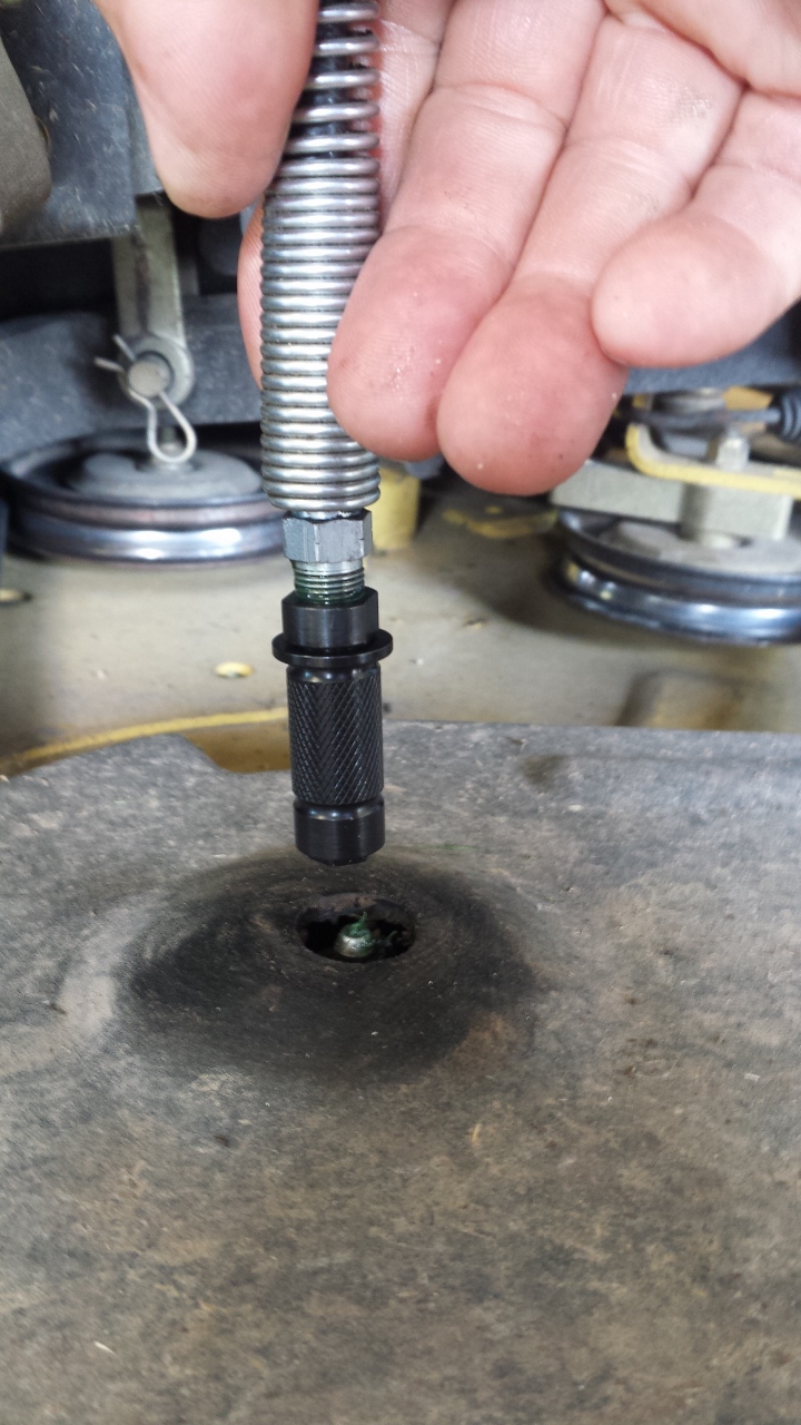

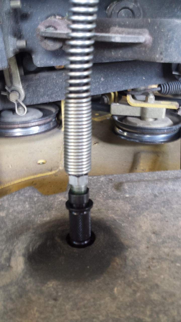

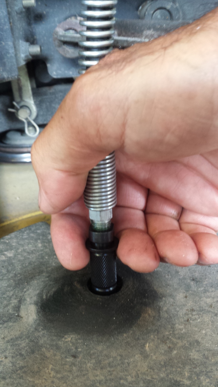

The Univer-Co coupler also uses locking jaws. But they are controlled by a sliding outer collar. This collar has a flange that can be pulled. Normal position is open. To attach the Univer-Co you simply push it onto the Zerk like an ordinary coupler. When pressure is applied to the Zerk this releases the collar and it slides forward and it's locked on. Pump grease. Then pull the outer collar to release the locking jaws and remove the coupler from the Zerk. It rests in the unlocked position ready for the next Zerk.
View attachment 430537 View attachment 430538 View attachment 430539
Having to slide back a collar with greasy fingers gets a no vote from me. I've been very satisfied with my lock-n-lube so far. Works even with greasy gloves on and I haven't accidentally pulled out a zerk fitting yet.

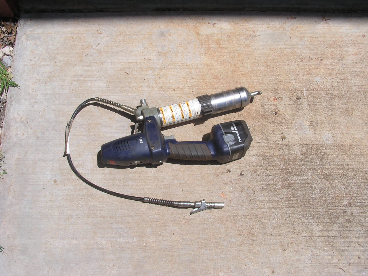

I squirt a lot of grease. Best investment I ever made was a battery powered gun. Don't need any type of locking fitting with that.

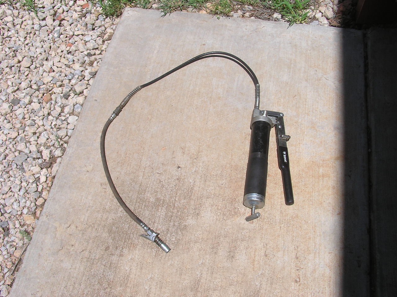

I have a battery powered Lincoln, liked it better after I put a LockNLube on it:
My favorite is a high pressure lever gun. Replaced the pipe with a hose and a LockNLube. Just recently added another hose.
With the longer hose, I can put the gun against my chest with the hose pointing down and locked on a zerk that won't take grease, then pull the lever with both hands, allowing the gun to reach it's 10K psi rating. So far the grease has always gone in:
