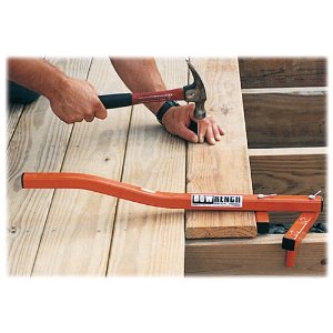

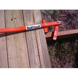

MotorSeven beat me to the punch on the reply.
Here is the link to amazon and a couple of pictures:
http://www.amazon.com/Cepco-Tool-BW...24UP/ref=sr_1_1?ie=UTF8&qid=1319118392&sr=8-1
I was able to bring in some pretty serious warps with it, so I was happy (I was also working with 5/4 cedar).
The other feature which I appreciated is that it is reversable. You can use it as they show in the pictures working from the deck to "pull" the deck boards into alignment or you can reverse the two components on the handle and use it to "push" the board if you are working from joists.

The first board bender I ever saw was made by Stanley and we picked it up around 15-18 years ago. 84 lumber had one here and they were the only place. Asked at some of the other lumber yards and they laughed at us so we went to 84 and bought it and brought it in to show them. A month later the other yards all carried the same stanley board bender. Its been great and weve used it on a lot of projects over that time. Even lent it to friends/neighbors for their projects and it still looks as good as the day we bought it. Definitely was worth the money as its so much easier then the old drive something into the joist and pry method.
