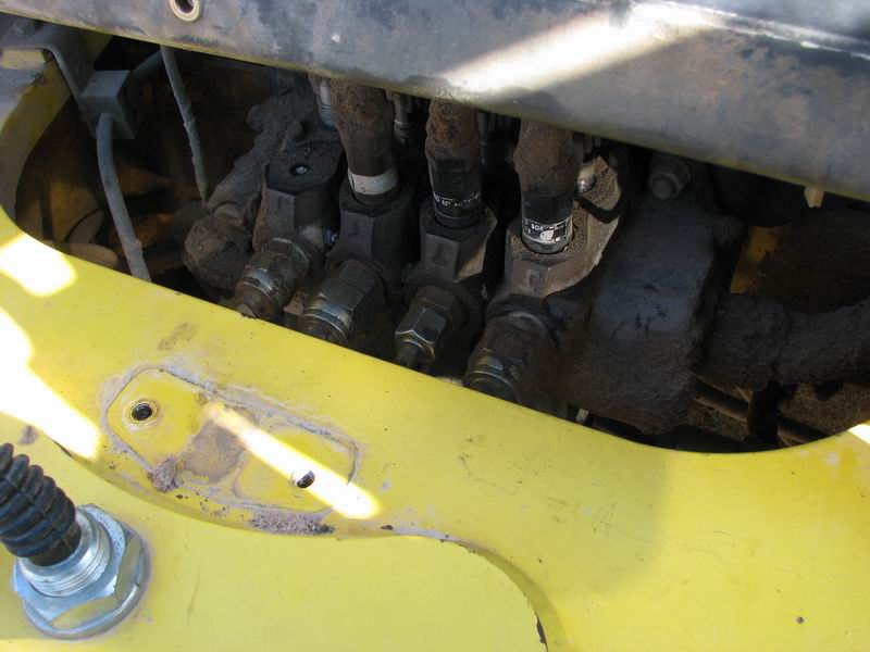

Here are some photos of the area. The hoses leaking were the bottom two hoses in the stress relief clamp in the center of the first photo below. The second photo shows the backhoe control valves from the top. Of course, none of the hoses were on this top row. They are all on the bottom. The final photo is zoomed in so the bottom row of hoses are visible. The bottom left two hoses are the ones I had to replace.

Dang! Of course, none of the hoses were on this top row. They are all on the bottom. The final photo is zoomed in so the bottom row of hoses are visible. The bottom left two hoses are the ones I had to replace.
Jim,
Is that another example of " Murphy's Law":confused:
It sounds crazy, but I have found places where an old fashioned monkey wrench works better than the fancy offset handle wrenches.
48mm is no problem, and the jaws are thinner than a reqular wrench that size.
Only grips two flats but so does a regular hydraulic wrench.
The handles are short and a couple burps with an air gun/chisel with a thuimper point against the handle usually loosens the fitting. The wrenches are made of an aluminum alloy so they don't mess up the fittings.
I'm not sure thery make them anymore.
Ron

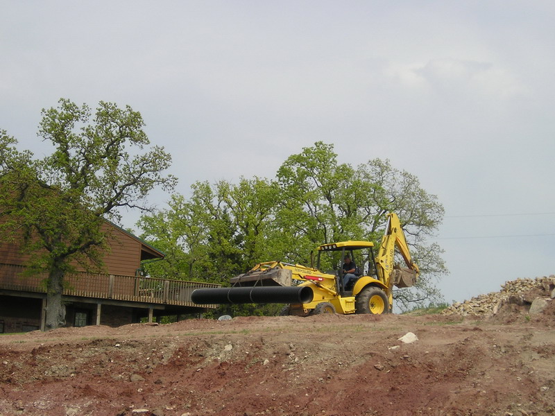

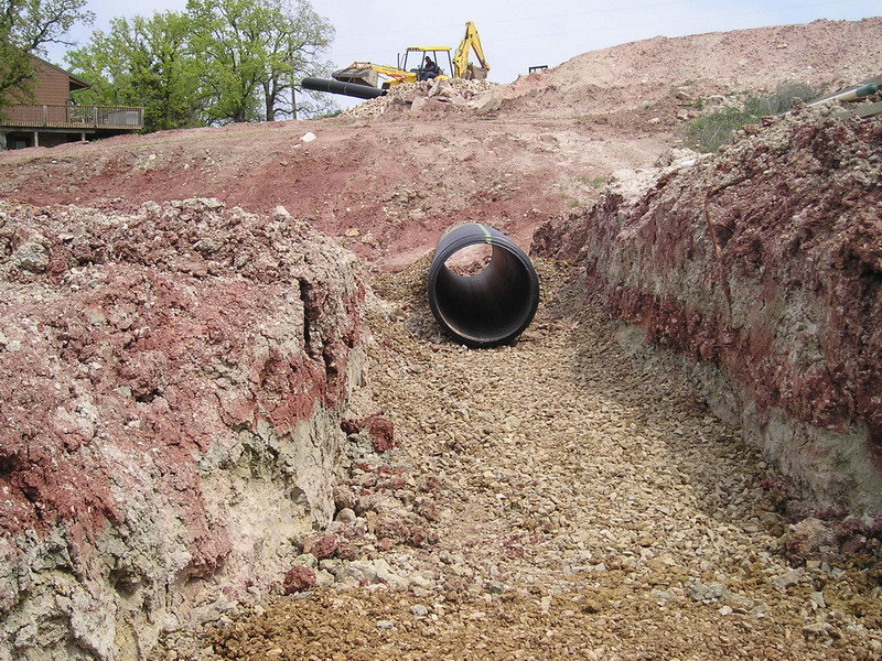

Here are a series of pictures of the culverts going in. I had to put two culvert sections together. I had some small road-base gravel with a lot of clay sand in it that I used to make the base of the trench and fill around the culvert sides/bottom before clay. Although the pictures don't look like it, the first culvert drops 6" front-to-back and the 2nd drops almost 10". The last picture makes it look like the culvert is low on the water side, but that's an optical illusion. Putting the culverts together was a breeze. I used the grease the dealer gave me and it made the culverts slip together nicely with a little coaxing from the backhoe on one end. :D I backfilled the trench, but didn't get pictures of that yesterday. I'll add rip-rap and try to get some photos of that today.
