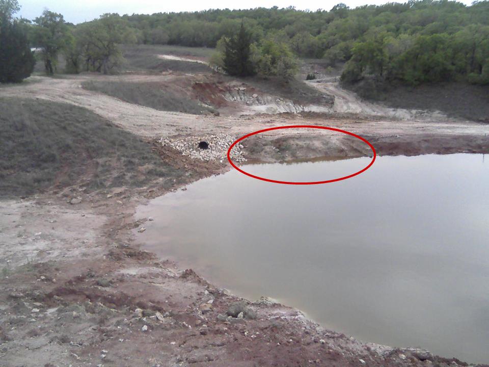

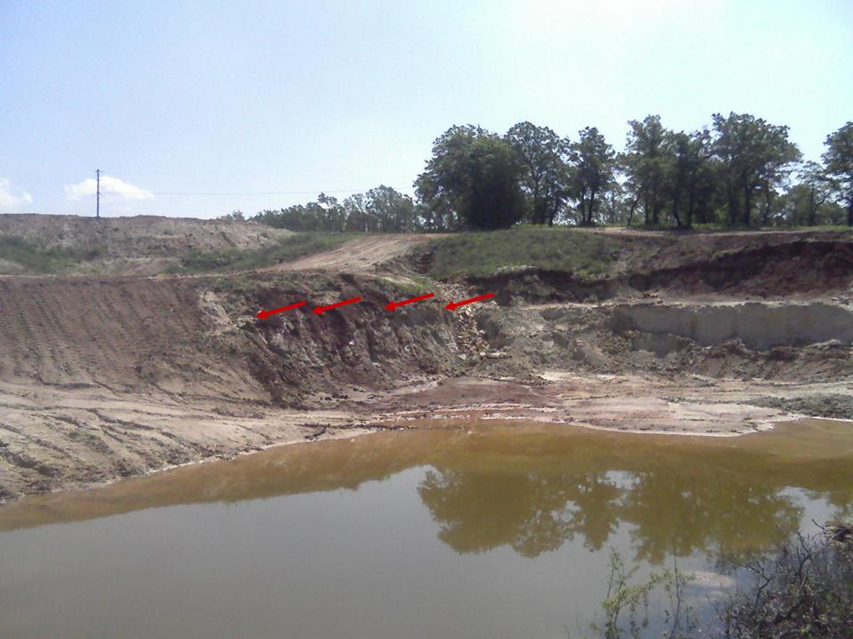

I had a setback yesterday, but think I may have found a cure. While I was haulin' dirt to the 2nd pond's dam, something caught my eye on the backside of the 1st pond. While the sun was just right, I could clearly see four seep points on the back side of the dam. It's not in the dam that I built, but the hill that was there originally. I made sure that I notched my key trench into this hillside about 10', but the leaks were all at exactly the same level. In the first photo below, you can see the points line up perfectly in a horizontal line. These points are just above the hard caliche "shelf" that you can see in the right of the photo. The water is seeping through a sand layer just above the caliche.:(
In the 2nd photo, you can see the one exposed area where I did not get clay lining the walls of the pond. From this point to the area of the leaks is about 50' through the little natural hill that existed here in the beginning. In an act of desperation, I hauled about 6 yards of the gray clay from my clay mine and dumped it into the exposed area. The gray clay is not clumpy like the red gumbo clay I have, so it spread nicely as I dumped it along the waterline. Sure enough, the leaks slowed by yesterday afternoon and may have stopped. I'll add another 6 yards of "insurance" clay and hope this seals the area where water is seeping through the sand. I don't want to have to drain this pond and rework this area, but I'll do it if I can't get the leak sealed.

Success! The leak seems to have stopped due to the clay. I put a 2' thick layer (minimum) over the sand and the leaking area is just damp from yesterday's seeping. I suspect by the weekend to see it dry or nearly dry. My heart sure sank when I first saw the leak, but 20 yards of clay later, I think I'll win this one.:D

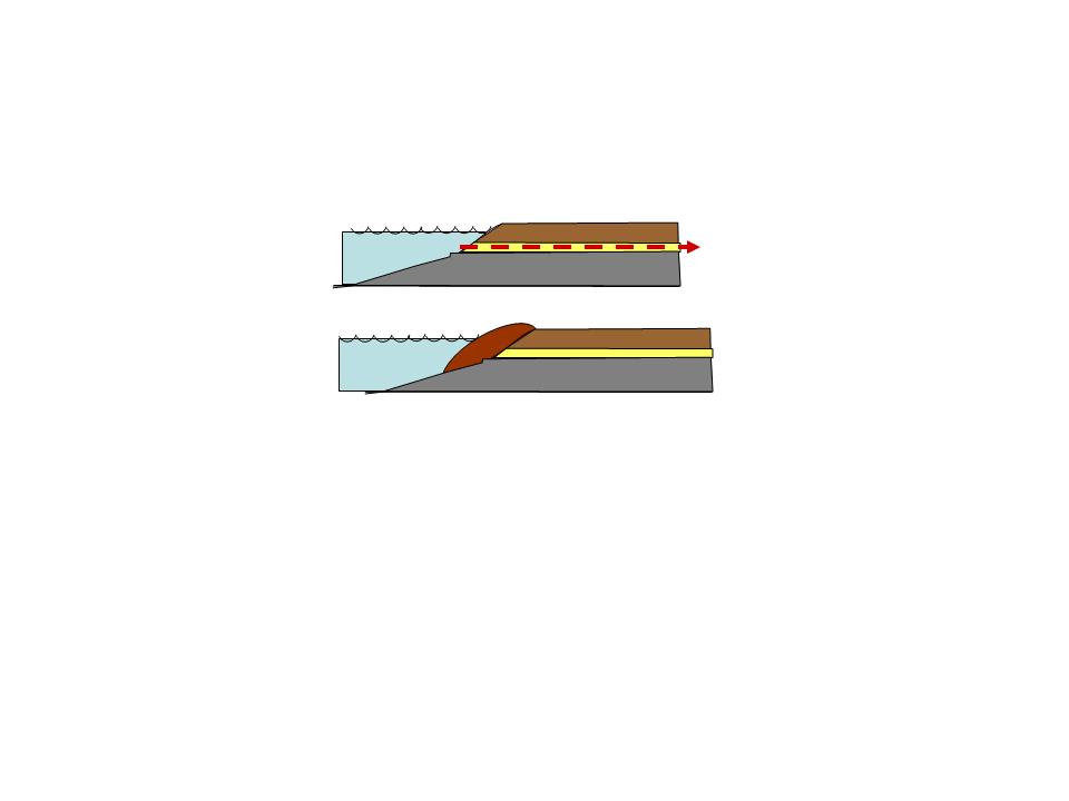

Luckily, I have zero problems with the dam I built. The only problem is the water above the level of the sand layer in the native soil. My little pond was leaking down at a rate of maybe 3" per week at these seeps. Actually, 1 inch could have been evaporation, and the rest was actual leaking. My biggest concern was the fish I stocked last week. If the water gets too low, the oxygen content goes away without an aeration system. Since all the leaks will eventually end up in the next pond, I could pump the water back into the high pond and get aeration at the same time, but I'd much rather have a leak-free pond where I didn't have to add make-up water.
The illustration below shows my case. The yellow sand in the top graphic allowed water to seep through. In the lower graphic, I added enough clay to cap the leak and stop water flow.
