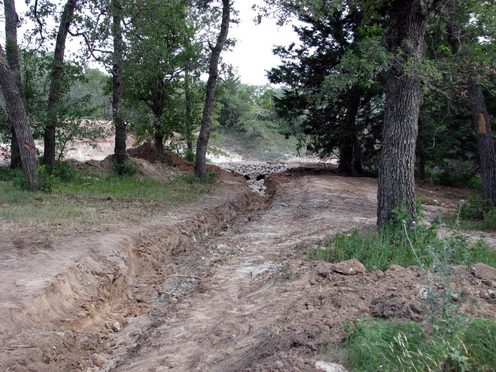

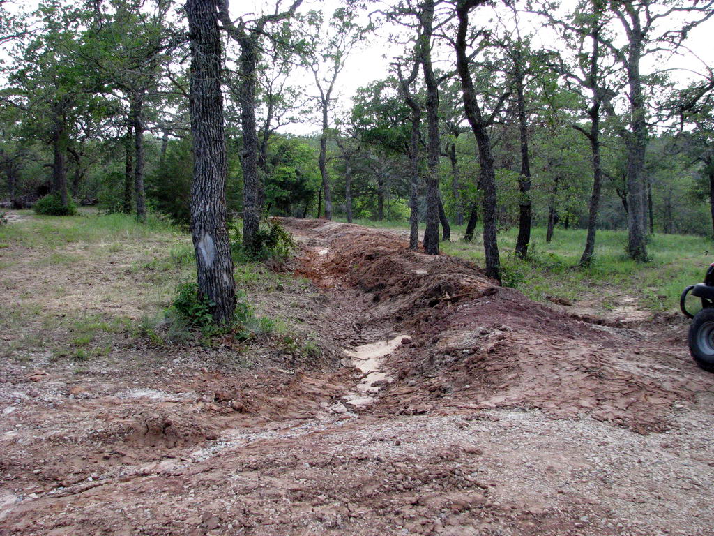

I haven't posted much on my project in a long time because I've used all my spare time to do maintenance and fix broken tractors. I believe my New Holland TC45D's hydraulics are back on line after many replacements of one seal that kept blowing. It turns out that I damaged/bent an o-ring flange and the o-rings extruded themselves out of the gap after about 4 hours of use. It took me awhile to figure it out, but I've replaced the rigid tubing with a new part and its flange is nice and flat, so I expect success this time around. After having the tubing off about 5 times, I'm really good and quick at it, but I'd rather be successful that good or quick.:rolleyes:

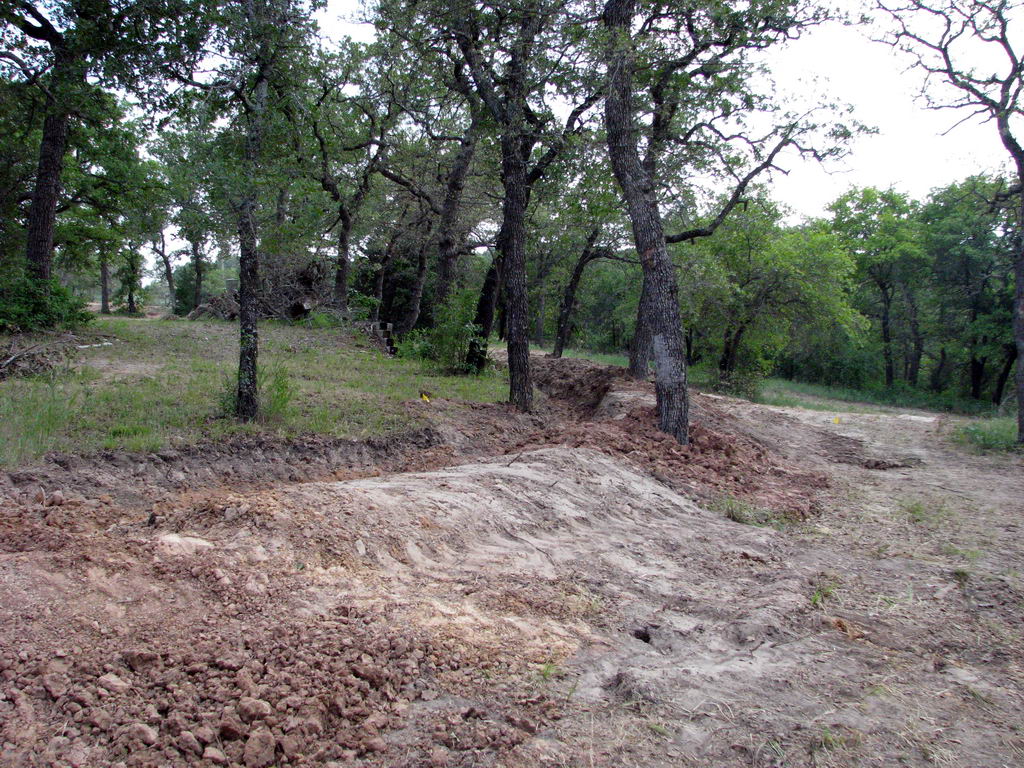

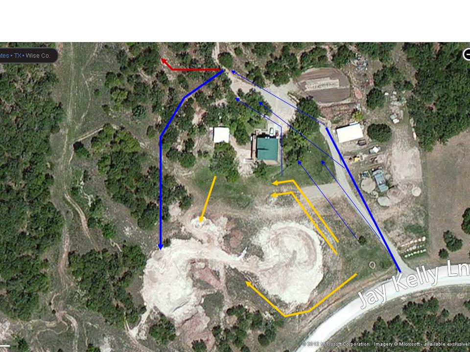

In the last couple of weeks, I've made good progress on building up my 2nd dam and I'm about 3' to 4' from finished. The dam is currently about the height of the full level of water I'll allow in the pond before overflow. Most of my work has been on getting water redirected so that it fills my new pond instead of going down to my gully and filling an already-too-full pond near the lake.
I've marked up the aerial photo below to show two main runoff paths that I want to catch in my new ponds. The yellow lines show the paths of water flowing into my first little new pond and the blue lines show the path of water to flow into my 2nd and bigger new pond. The red line shows the current path Mother Nature selected that goes directly into a valley and into the ponds by the lake (see pacerron's photo here). After verifying that I could make the water flow to the new pond with a surveyor's transit, I set out to dig the trench with my backhoe. I couldn't do a really neat job because of all the trees. I'll have to remove some of them eventually because they will die anyhow. I also brought in many loads of clay from another area to build up the terrace. After the first good rainstorm, I'll complete the trench and remove the excess materials.

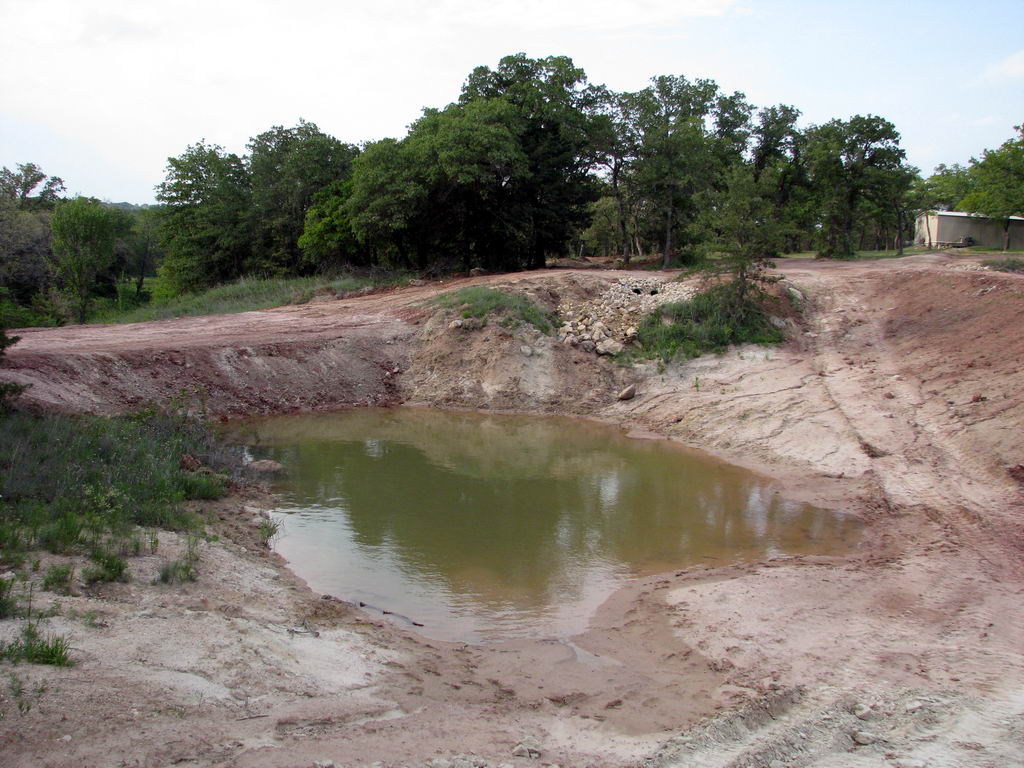

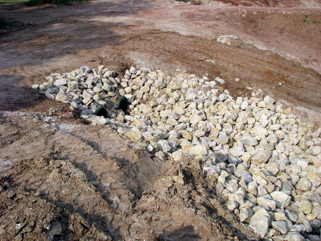

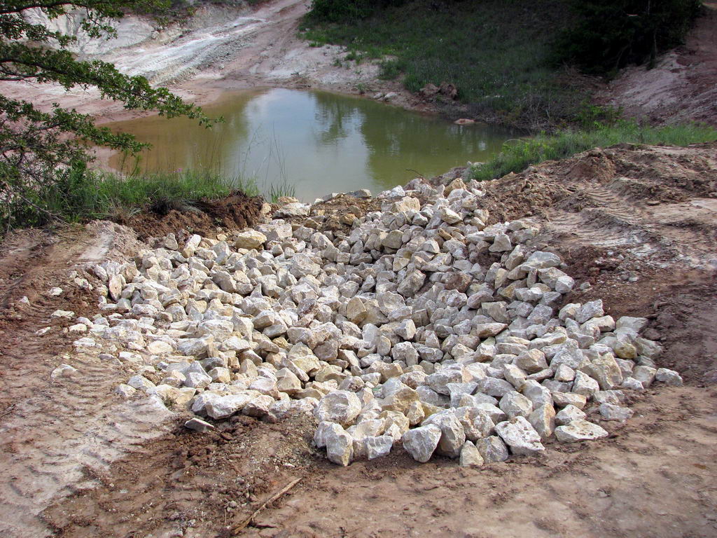

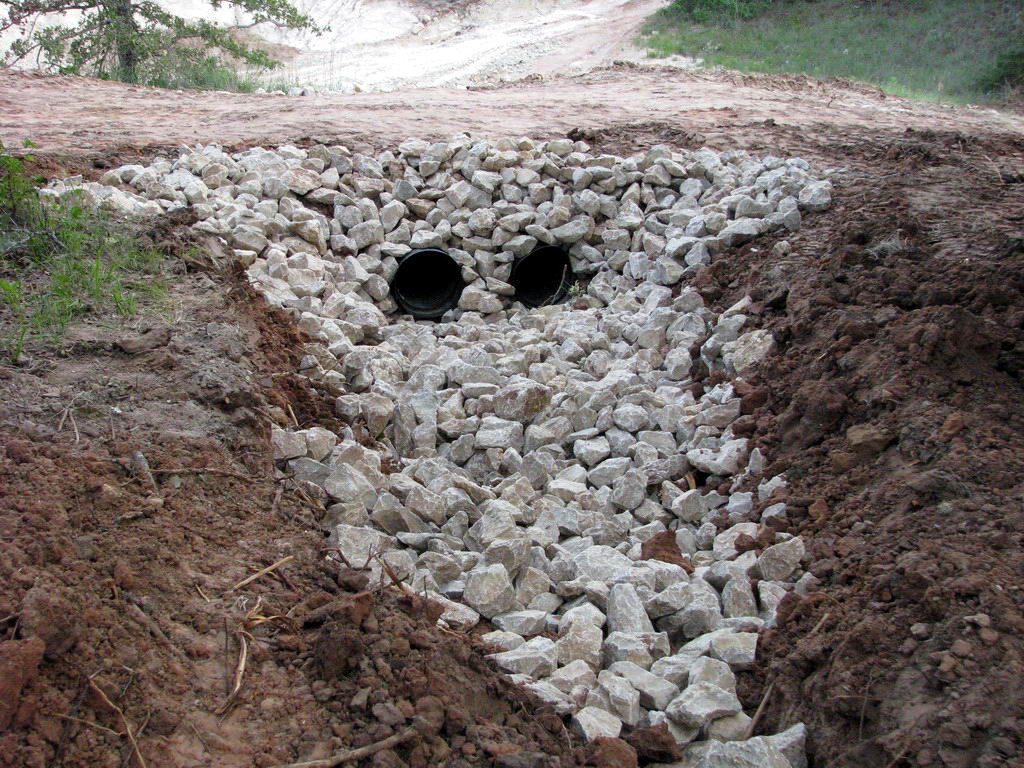

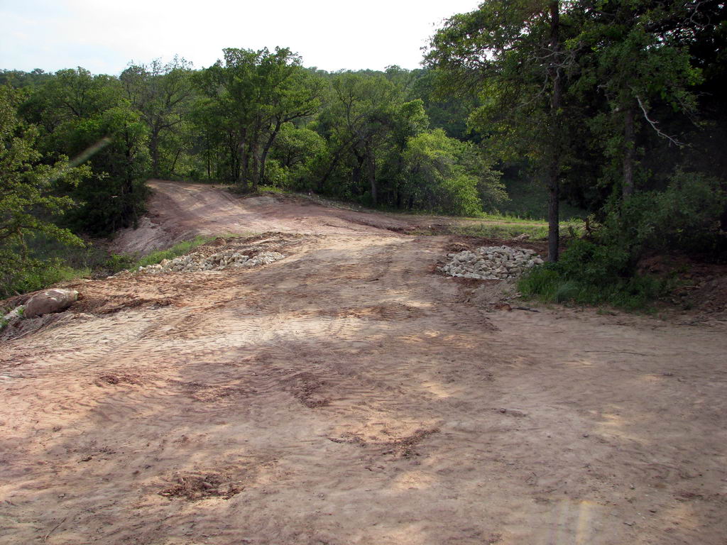

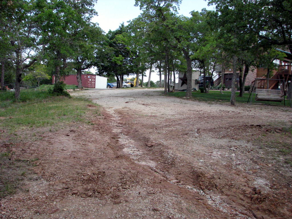

The 1st photo below shows my yard and driveway where water runs off. This area flows quite heavily in a rainstorm. As you turn 180 degrees, you can see where I built a high berm to direct flow down and to the left. This is the area that usually flows down to my valley. The next two photos show the flow continuing through the trees The 6th photo shows the inlet to my 12" culverts with rip-rap. Next, the road over the culverts and then the outlet side two photos: one looking toward the culverts and the other looking toward the pond. I also drove down into the pond area and took a photo of the culvert drain from across the pond. The level where the rocks end will be slightly below the normal water level. You can see I've really raised the dam level since the last time I posted photos.

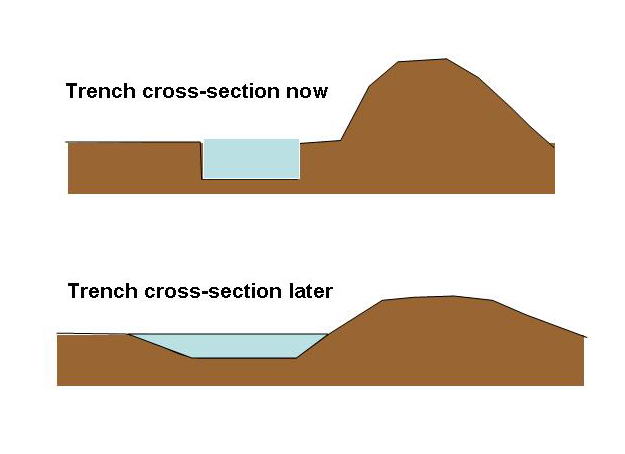

Finally, my runoff trench looks really rough now, but after a rain I can tell how well everything works. I'll make the square trench more of a swale and lower the level of the terrace so it is a gentle slope to keep water in the swale as I've shown in the illustration. Having my smaller tractor fixed and available for the tight spots will be a big plus.

We had 27 drops yesterday afternoon. :rolleyes: But hey! May is supposed to be our normal wettest month. I tested and fine tuned the trench by turning a garden hose down it. It took awhile for the water to quit soaking in, but it finally made it all the way to the pond.:thumbsup:
