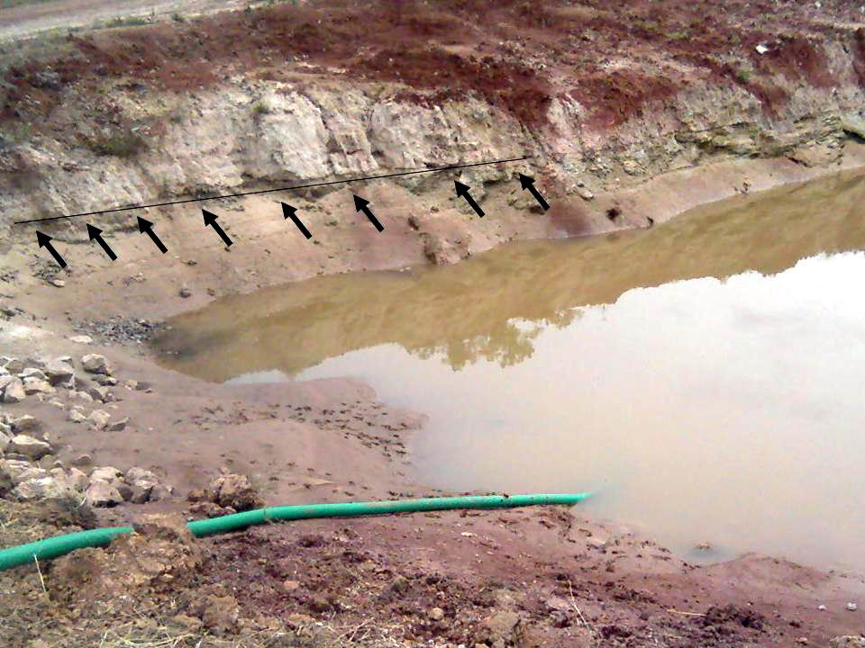

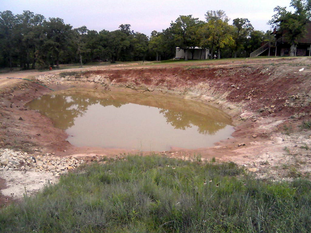

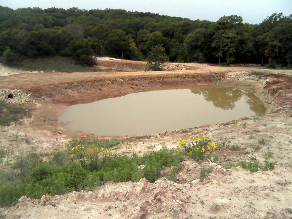

I was out a few minutes ago and took some photos of the ponds after two days of transfer. The first photo below is the pond I am transferring water to. It is really coming up and I have a bunch more water to put into it.:thumbsup:
The next two photos show the progress on pumping the leaky pond down. The final photo shows another area where water seeps out of the pond. In the area shown, I didn't have any leaks until I pumped water into the pond from my well and raised it up to this level. When I did, I saw that seeping was bypassing the dam on this end of the pond too. What the hey?! If building ponds was easy, anybody could do it.:rolleyes:

It looks like your sand layer goes most of the way around the pond. Were you planning on putting a layer of clay all the way around to cover it up?
I hope that there is not any rain in your forecast for a little while to give you time to pump it out and for it to dry out before you get into it. Rick
