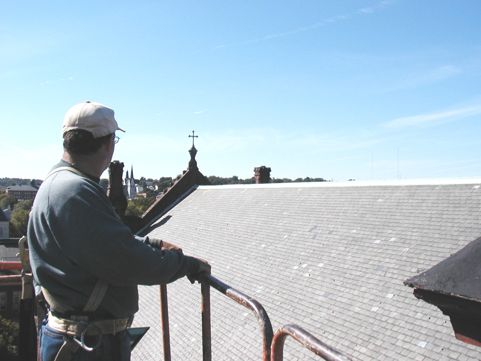

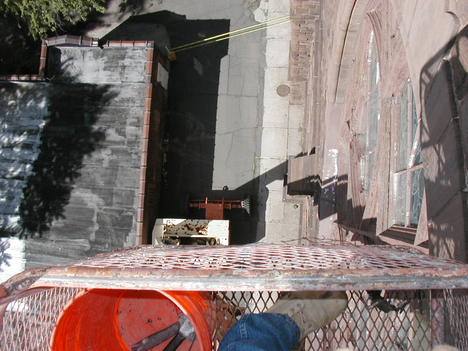

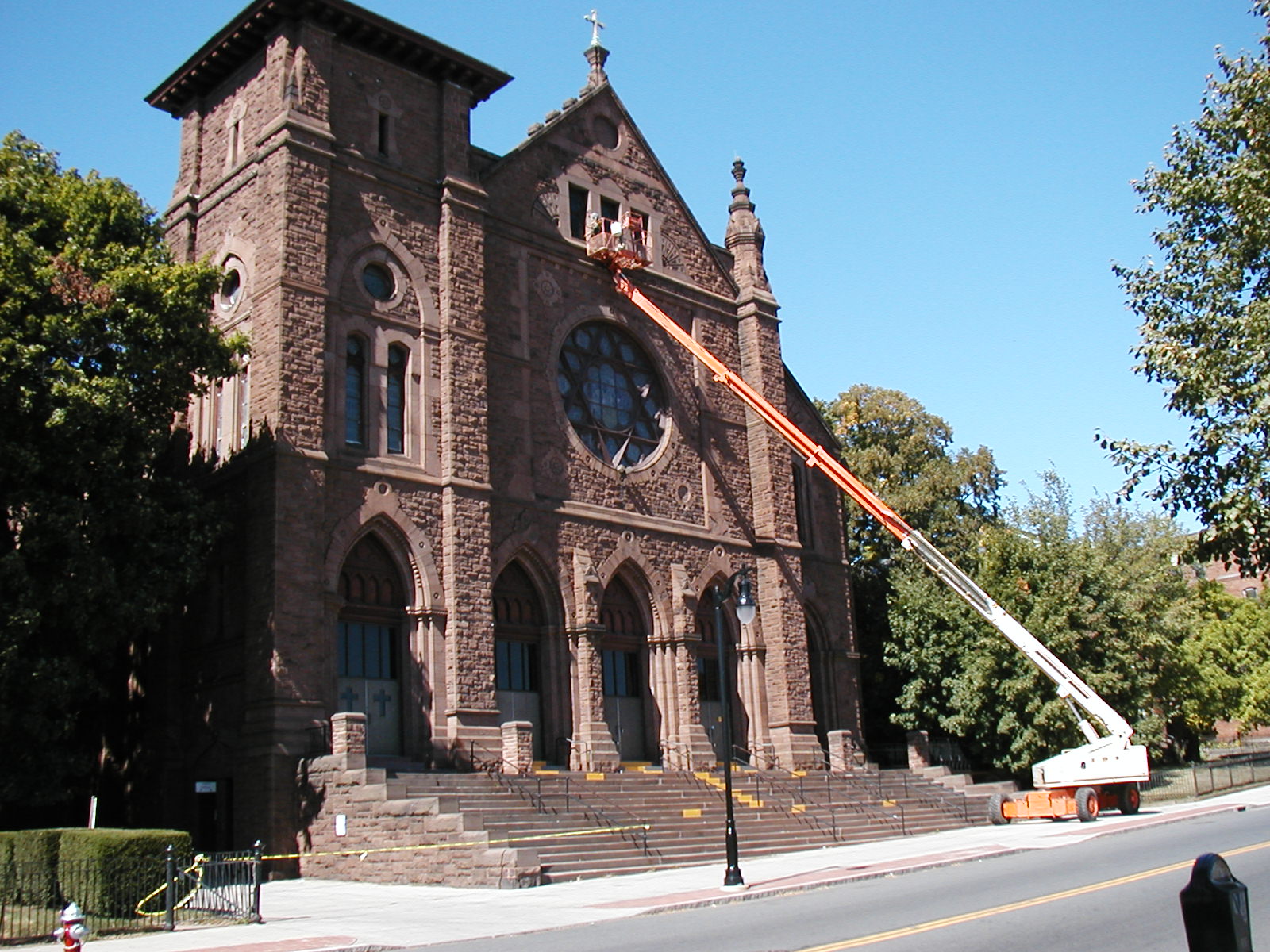

We rent the boom lifts in our building maintenance business, from 40 footers to 110 footers, 60's and 80's mostly.
Here's a 110 footer in action.

Yup thats a condor lift. I have license for 1 of those. You can actually catapult yourself out of the basket if you don't know what your doing. Tire flex alone is several feet in the basket. 7 feet of lanyard is perfect for pounding you pretty good on the outside of the basket.
Just a note on using a pallet as a platform & I do not recommend it at all but the bottom boards are more important than the top ones to keep it from flipping off your forks

Those are some awsome pics, I saw them on here when I was building my manlift. Dont know that I could go that high, got to really respect guys like you that do those type jobs! I do love looking at pics like that though
