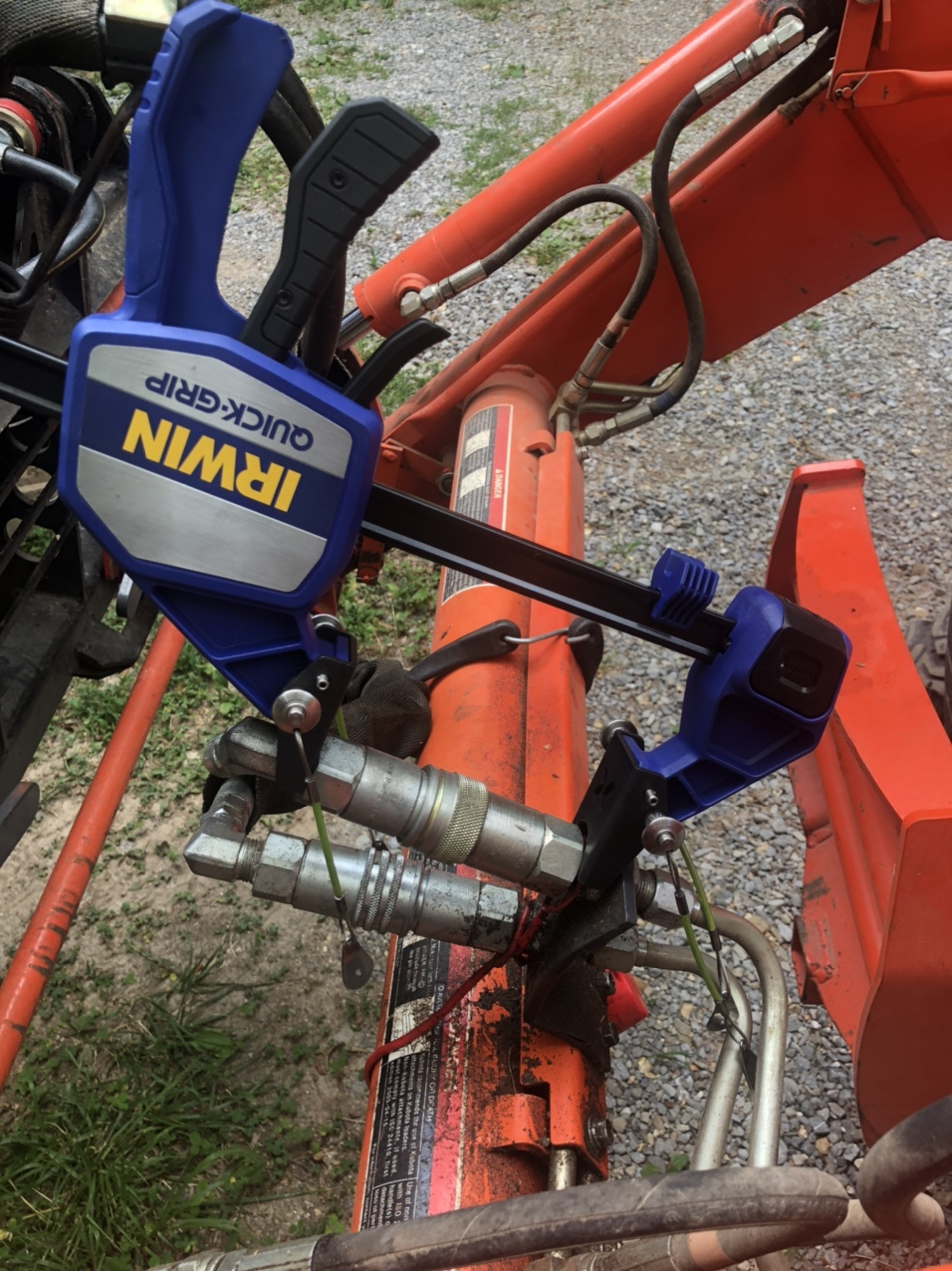

I never have issues with small couplers. Its the flat face ones that are a pain. I bought one of those modified clamps that worked great this winter….first full use. This is someone elses picture…i have same unit, but cand find photo of it.
   / The Hydraulic Fight is Over - Hydraulic Coupling Pressure Relief Tool #8
I use the same tool...VERY pleased with it.
