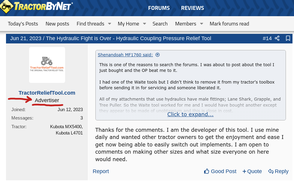

Quite a few likes and responses for spam-vertising. Check this guy has two posts basically the same. Smh

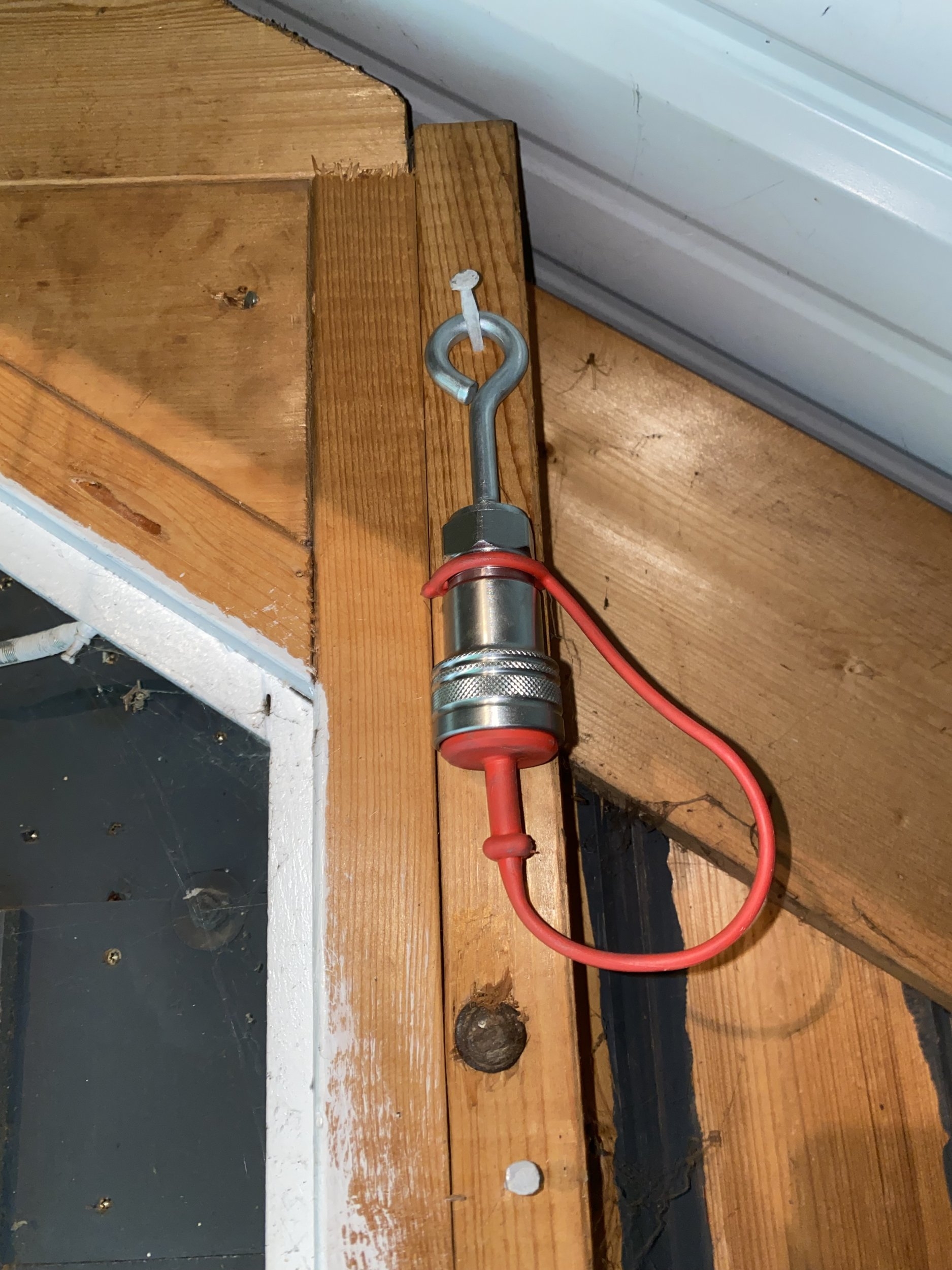

Check my post #2, Moss. I built mine using a spare fitting I already had in a drawer, but even if I had to buy a fitting, it'd have cost me less than $20 to build that tool. The BOM is pretty simple:
1. Spare female coupler (mine was 1/2" NPT back end)
2. Plug for back end of coupler (in my case, 1/2" NPT with hex key drive)
3. Eye bolt (in my case 3/8" UNC x 4")
I just drilled and thru-tapped the plug to 3/8", threaded it into the fitting, and then the eyebolt into the plug. Done.

Not sure if that was directed at me, as you quoted my post and then asked if I read my own post. I've found that connecting the lines to each other helps reduce, but not entirely eliminate, this type of hydraulic lock-up. Moreover, some of my equipment has M/M for plugging into my factory rear 3rd channel (which is F/F on tractor), so I'd need to make up a F/F coupling for each one for storage.
This pressure relief tool is cheaper, easier, and more quickly at-hand than all of that. I keep it hanging from a nail on the door jamb of my shed, where I keep all of my equipment. If you don't ever need one, consider yourself lucky, but it's very handy for those of us who do.
