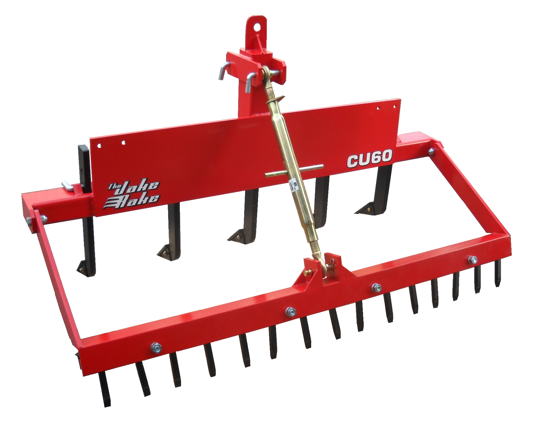

In they I am referring to the people that i consulted on the idea to see what the preference is for these types of implements. I like the idea of the clevis hitch and am now going to see about applying it to the U96 which is under development now. Imatch is a must for me, with the U96 though, do I make it just compatible to Category 1 imatches or do I go up to 2 or even both? I just need to know where to draw the line between category 1 and category 2 compatibility. Thanks guys. :)
As long as the implement can handle Cat 2 forces then make it work for both cat 1 and cat 2. You might want to stipulate the min and max hp ratings to protect yourself.
/ The Jake Rake
#49
In your opinion, what would you rate as max hp for the U96? I am beefing up almost everything on it including thicker wall tubing, steel tubing welded into the main tubing for ease of moving the shanks up/down as there will not be dirt packed in to complicate tooth adjustment. I also am going to have two arms for the rake itself for added strength.

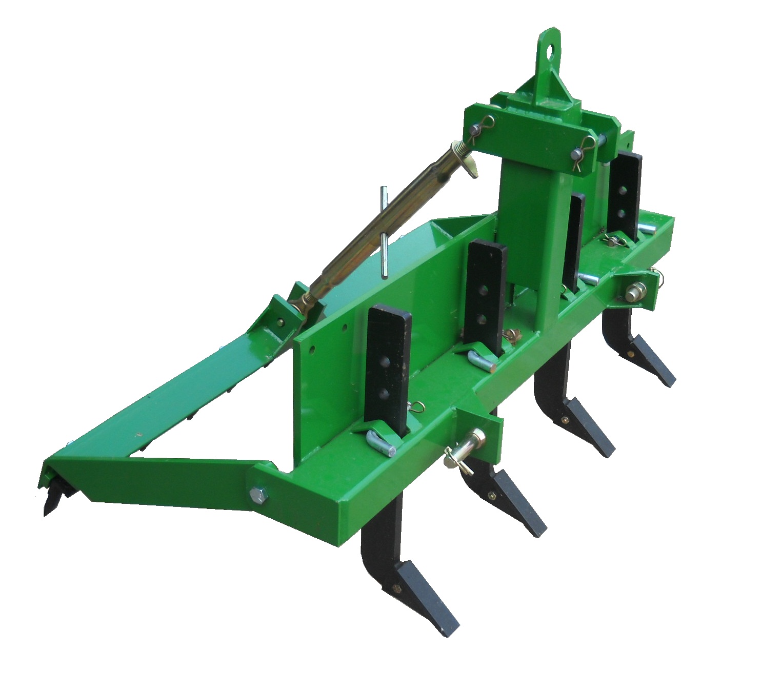

/ The Jake Rake #50
When you say thicker wall, what thickness are you talking about? The picture shows a cat 1-2 quick hitch-able set up.
/ The Jake Rake #51
I would consider using 5x5x5/16 or 3/8 square tubing for the main beam.
