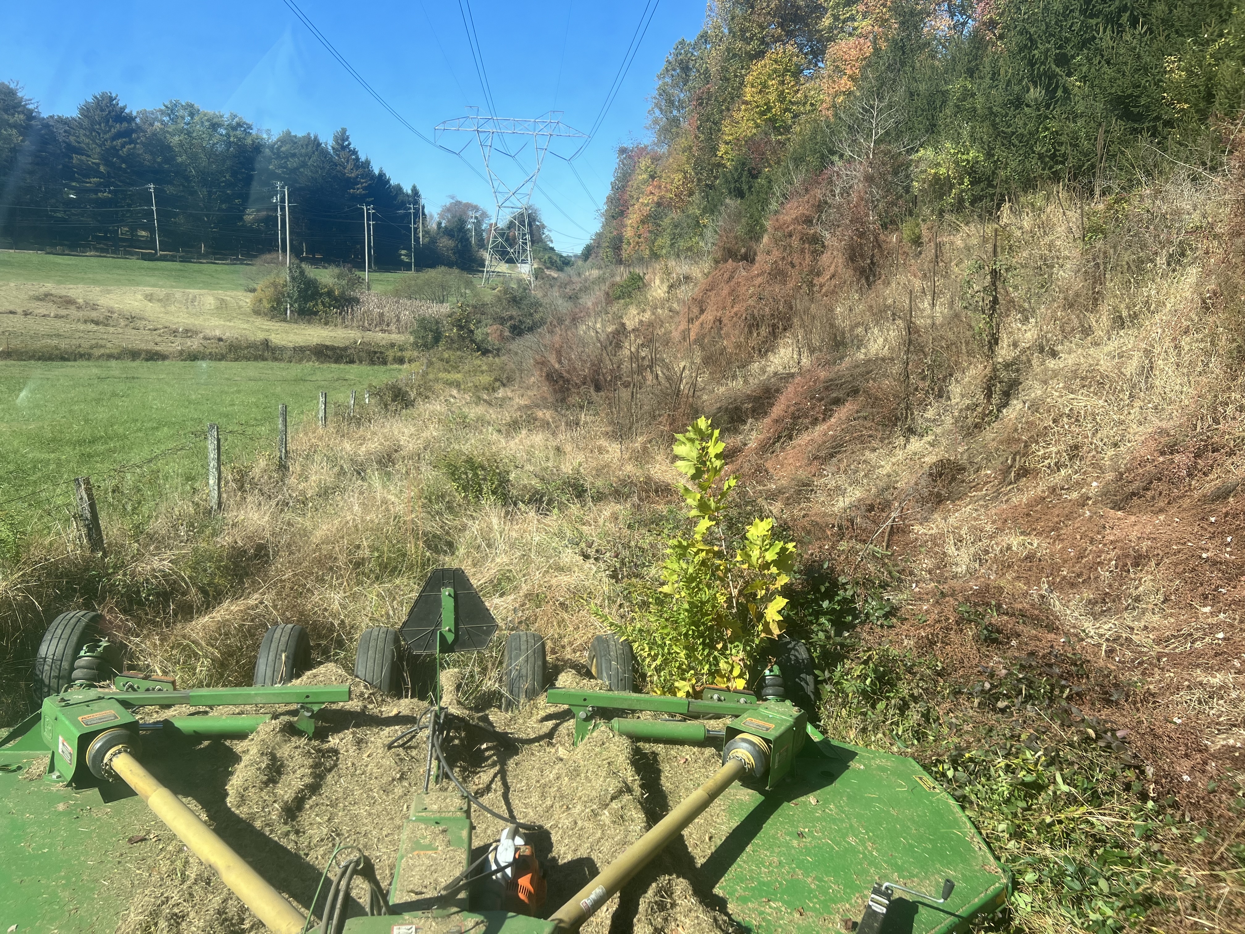

Backing down between an old fence line and the abandoned, raised RR berm on the right.

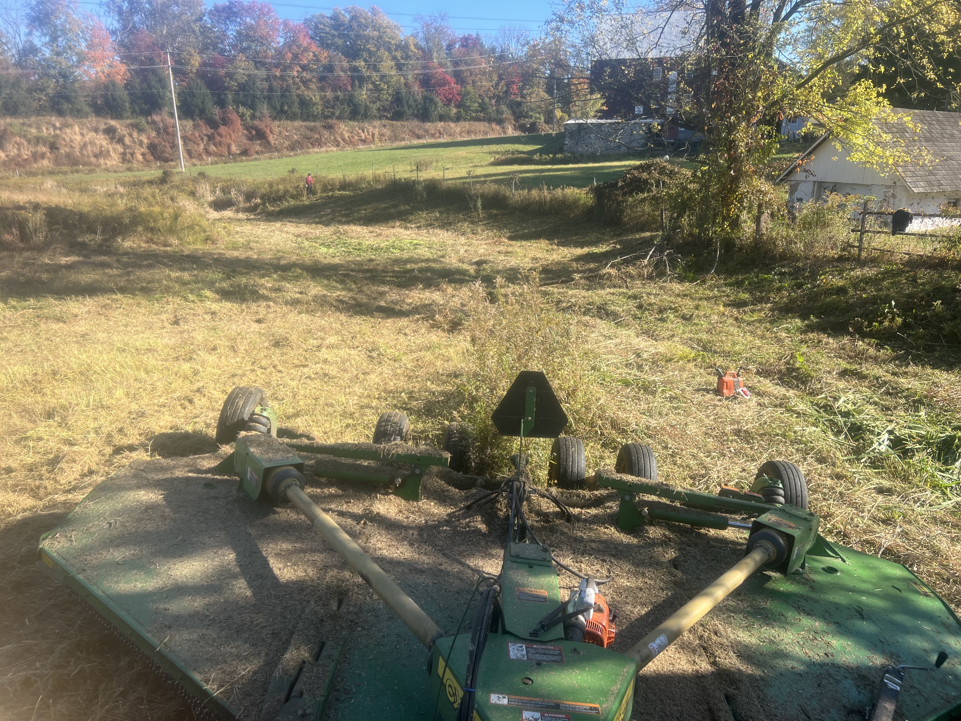

Here we are mowing some very soft ground near a stream. You can see one of my guys weed wacking fence in the background. I cut in reverse on soft ground so I can observe if my CX-15 tires start to track mud, it’s time to pull forward.

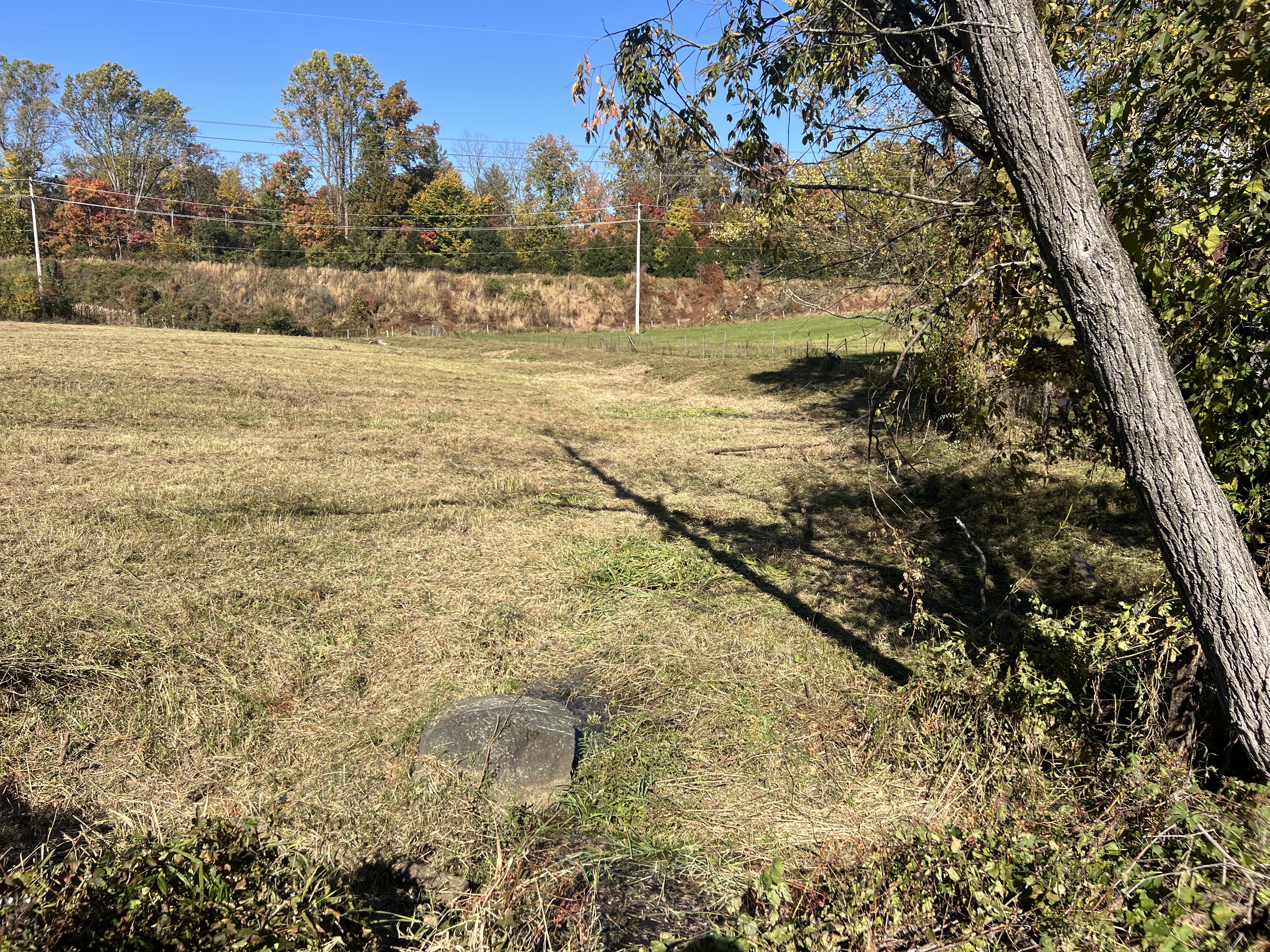

Finished. Well this part, anyway.

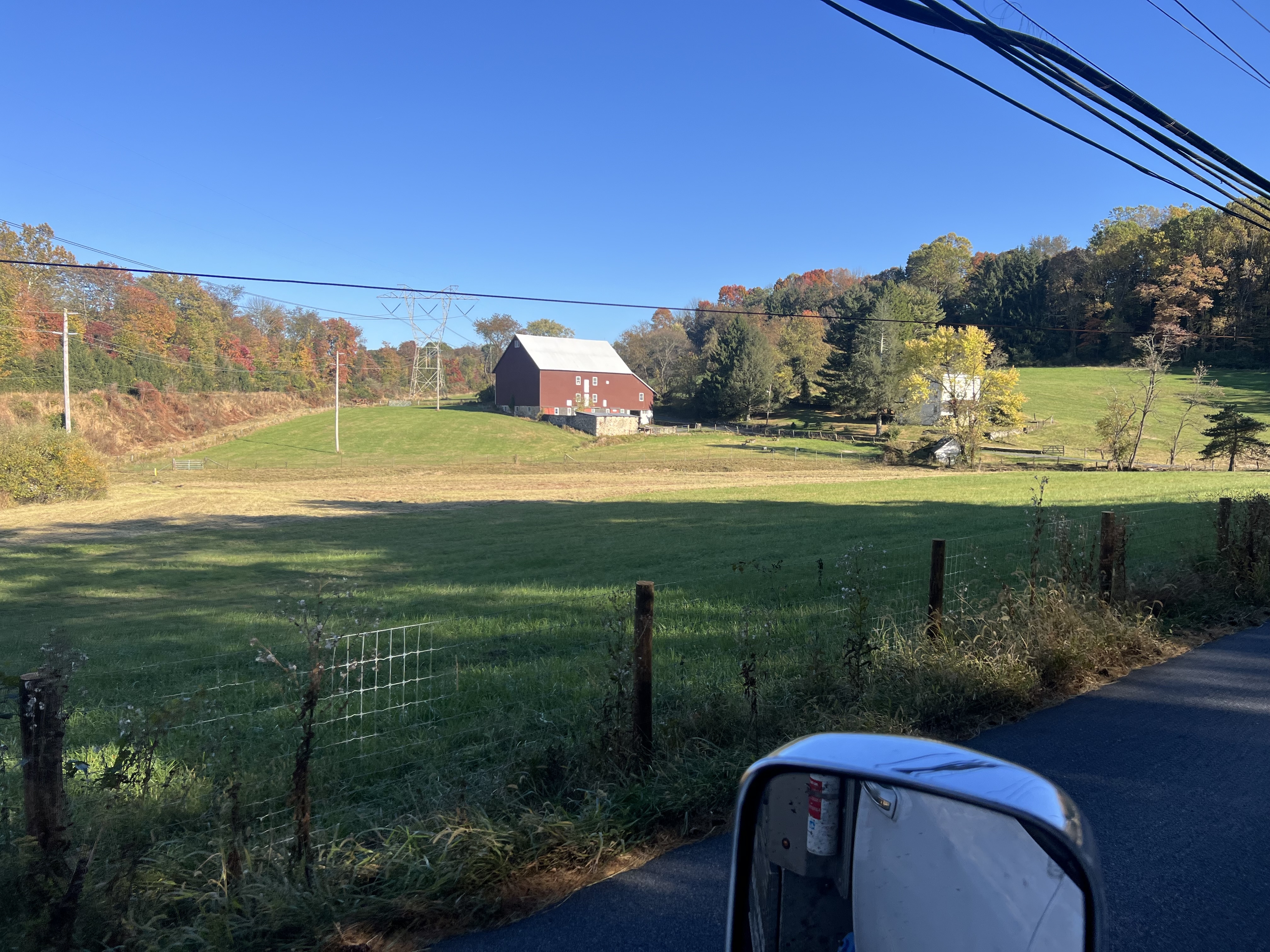

Looking nice from the road.

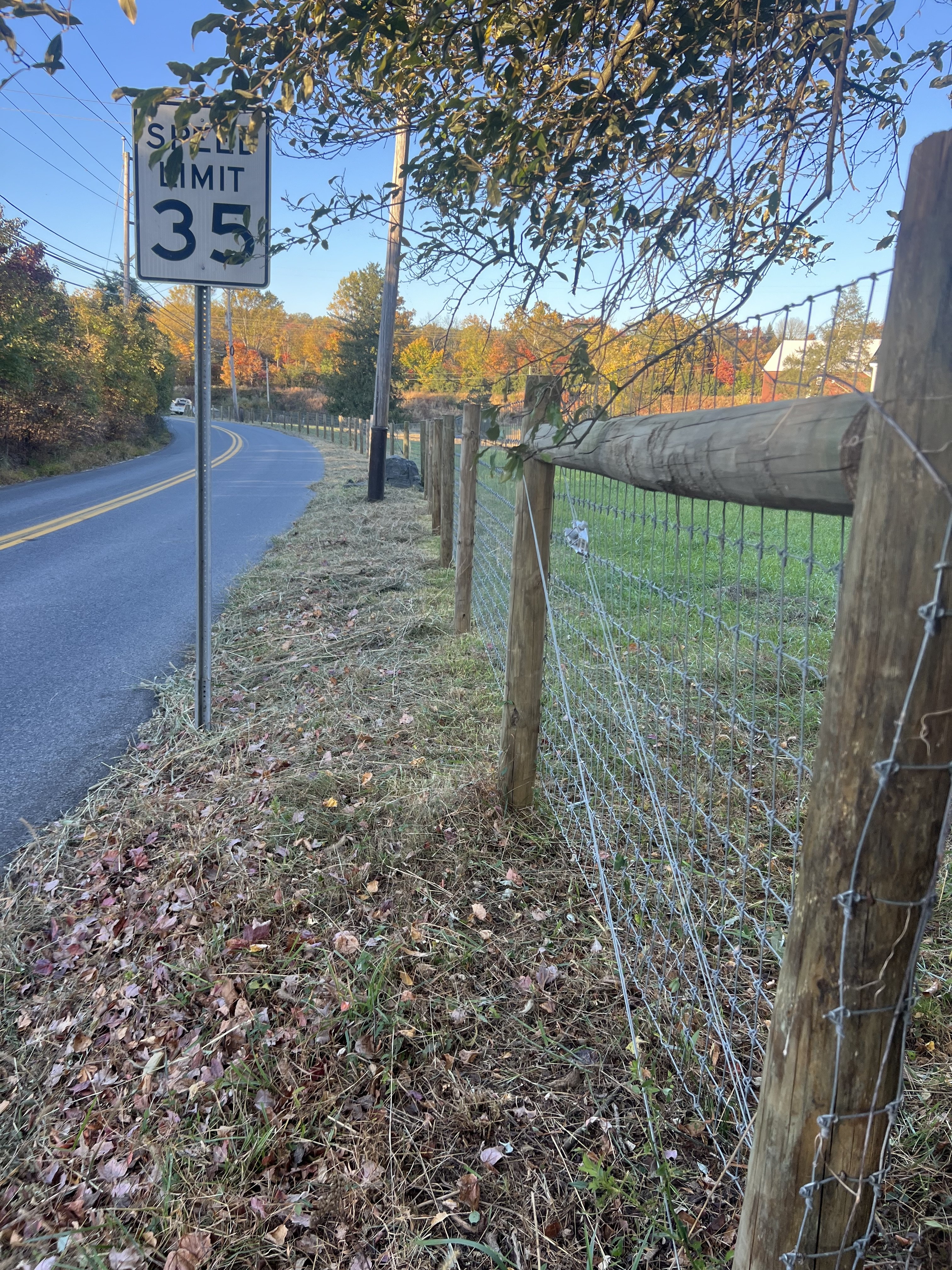

Weed wacked all this fence along road myself. You can see my Ram off in the distance.
