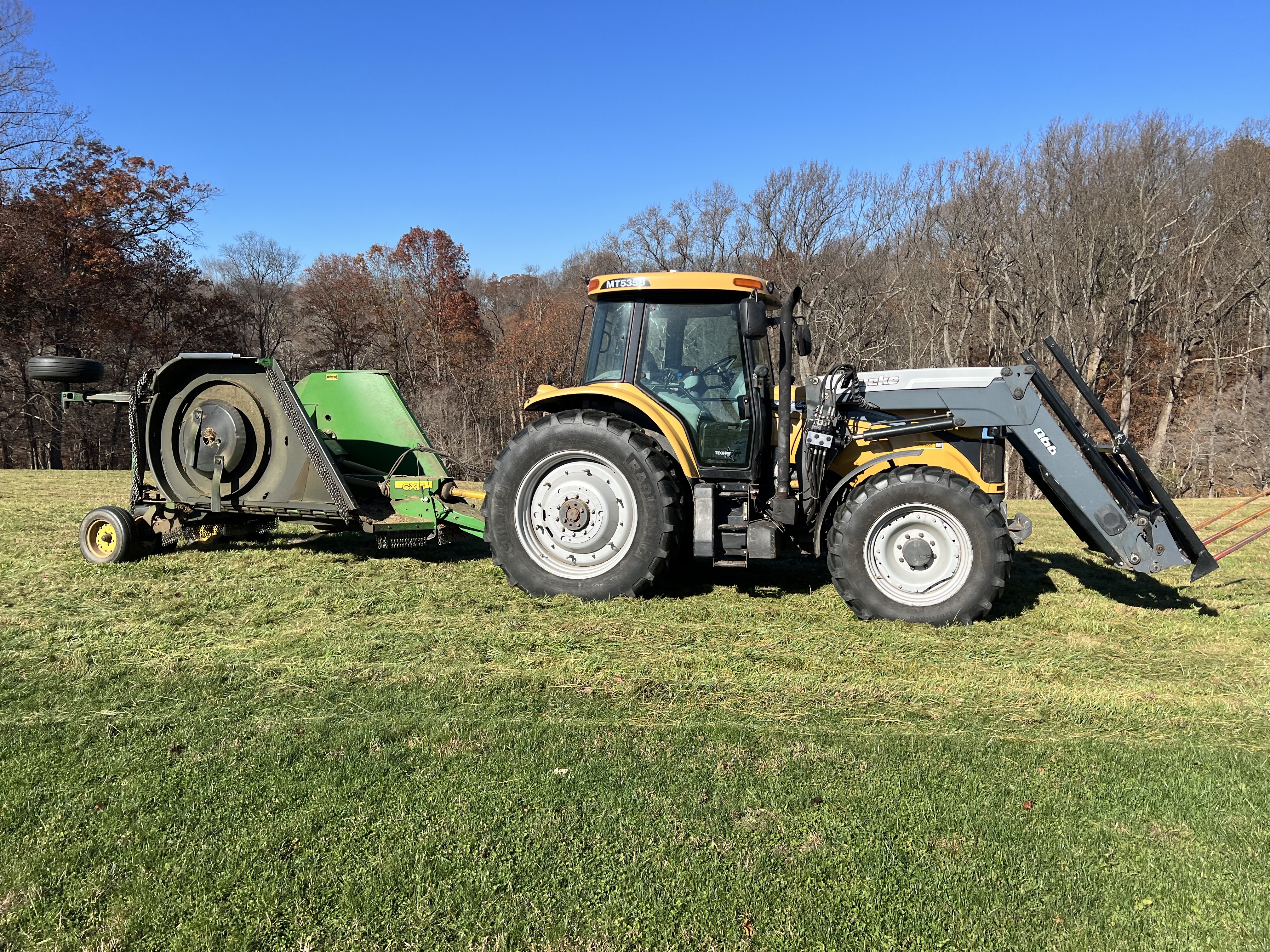

HD, I have a question. I went to NC last week and saw someone cutting hay with a 15' rotary cutter. What's the downside to that vs a standard mower/conditioner?

Biggest would be, as you know, the rotary mower shreds the grass into small bits & pieces which are nearly impossible for the baler to pick up and build into flakes in the baler’s chamber.
A hay mower cuts the grass off about 5” high, leaving those nice long strands the baler can easily pick up and put into a nicely shaped bale.

Hay Dude, Isn't that batwing that you use a rotary cutter? And you bale after cutting with that? Or am I mistaken and you have other cutters for your use with the large square baler? Just curious, as that's what it looked like to me. Thanks Greg
Yes, the John Deere CX-15 I have is a 15’ rotary cutter.
No, it’s not used to cut hay fields. It’s used to cut non-hay fields.
The John Deere CX-15 Batwing rotary mower is used to mow fields that are not hayed.
Like this:

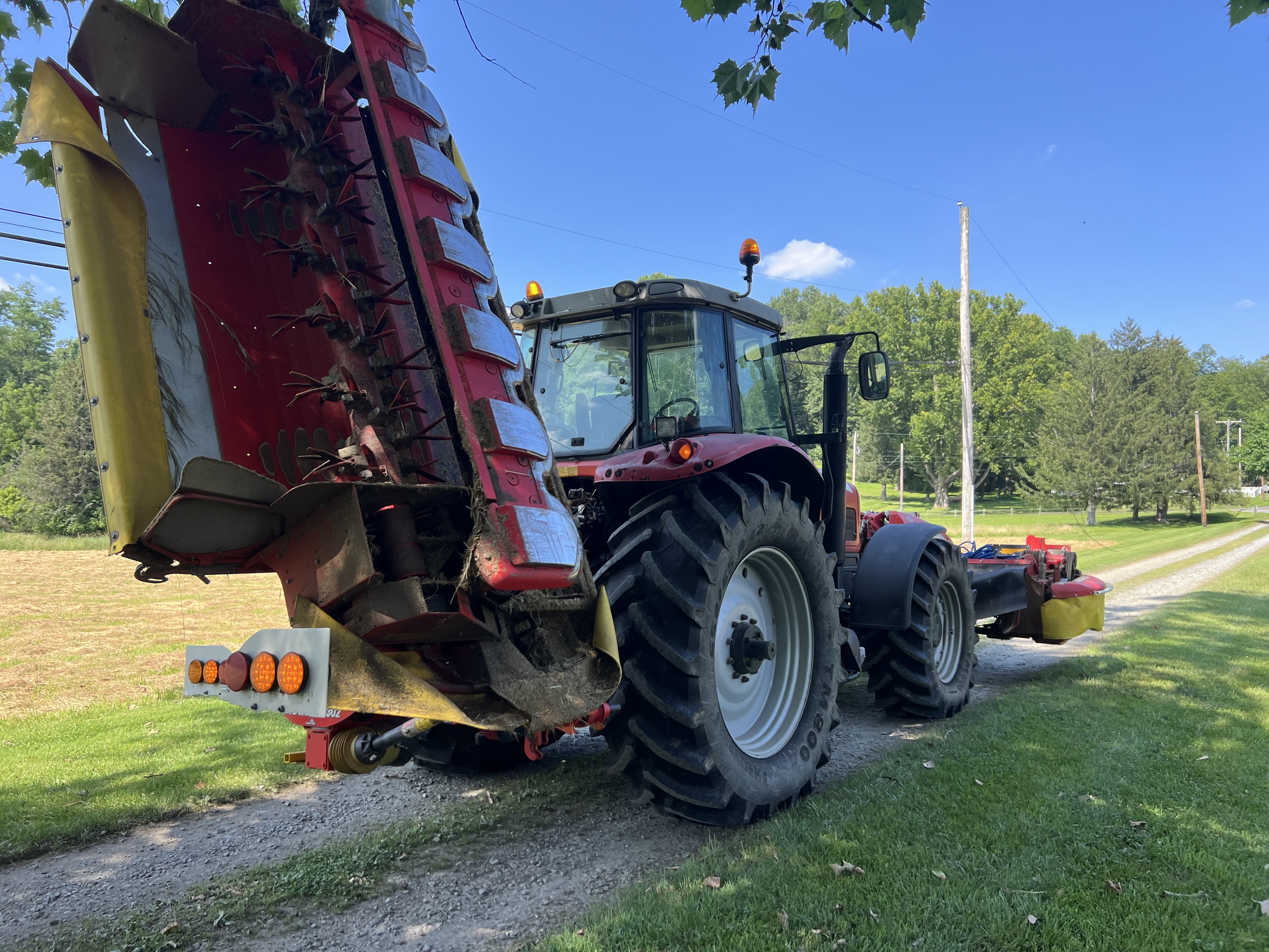

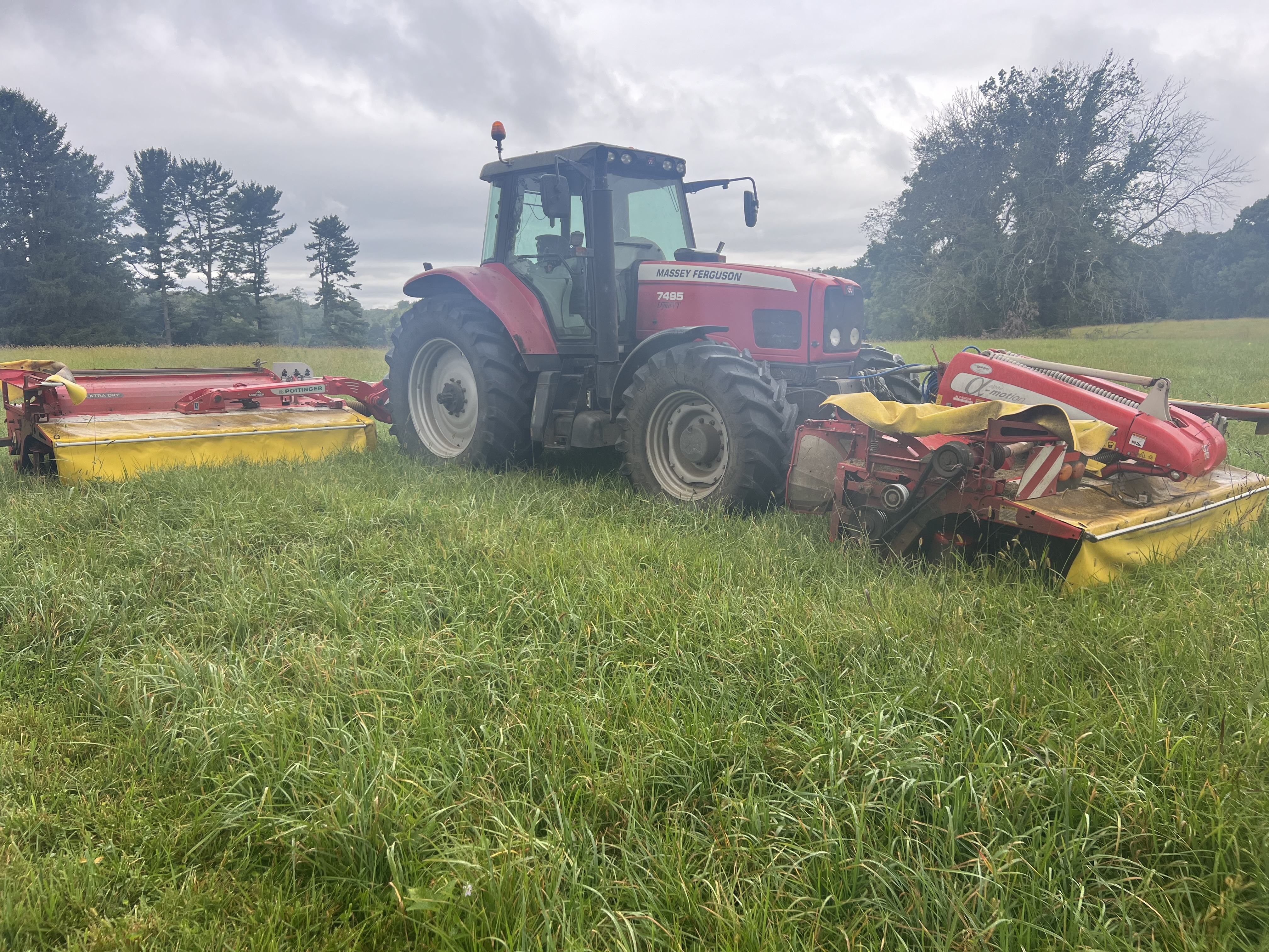

When we cut/bale hay, I use the Massey Ferguson 7495 with the (2) Pottinger hay mowers. They have a completely different mowing process than the John Deere CX-15.
These mowers have several smaller “disc” mowers and the conditioning tines you see underneath the mower.
Here’s the mowers lowered into cutting position. Cuts a 21 foot swath.

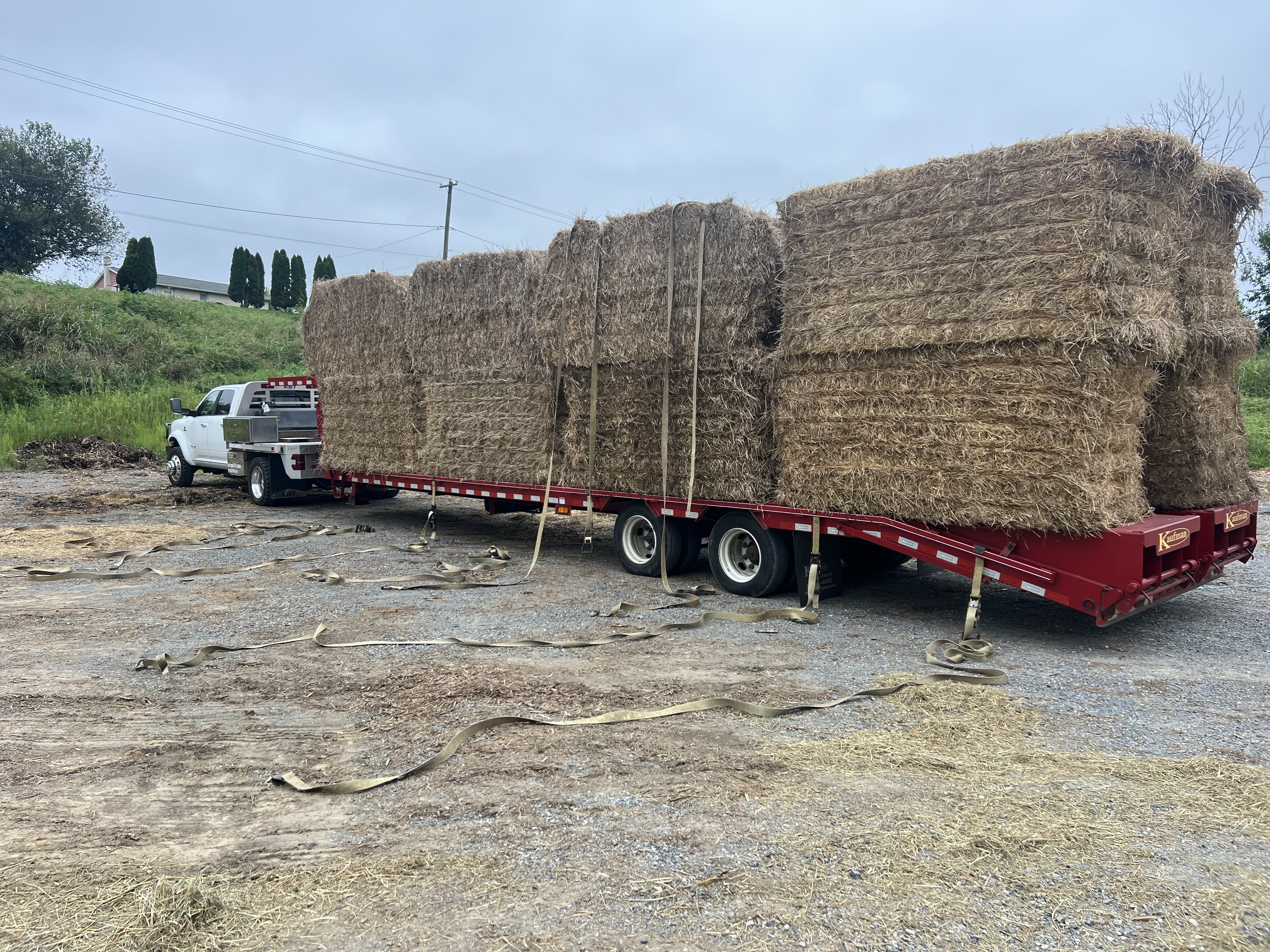

Got the green light to start trucking hay to 2 of my mushroom hay buyers.
Here’s 16 biscuits I delivered this morning.
13.5 tons.
Scale said 47,500lbs. Can’t do that with a Ford. :)

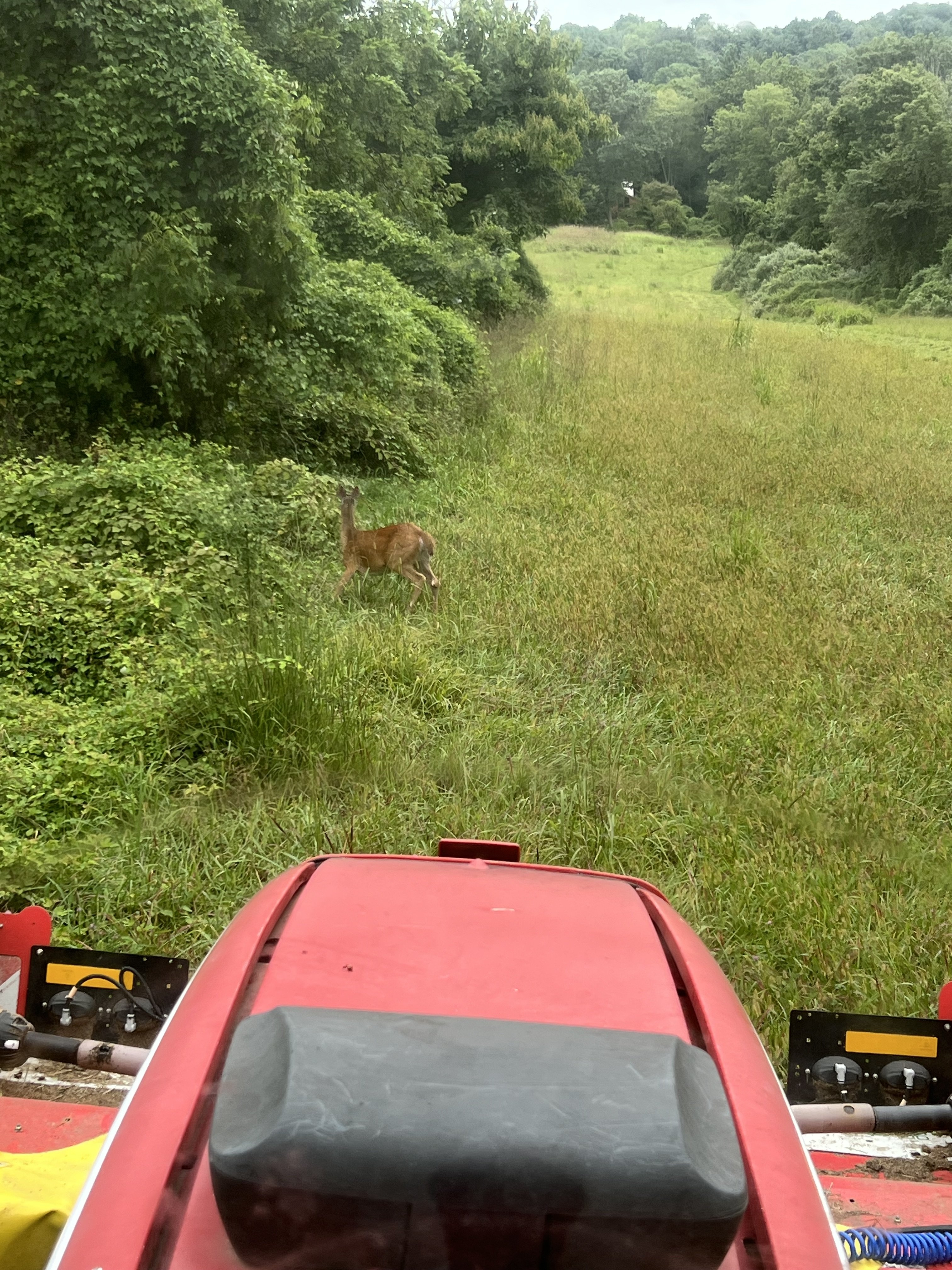

Started mowing 2nd cutting yesterday. This field already overrun with foxtail. The deer decided to wait until the last second before I mowed right by him. I swear these deer are semi-domesticated round here…
